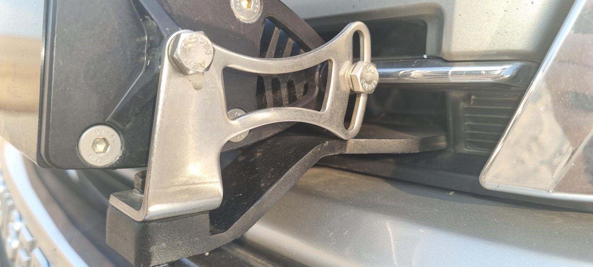

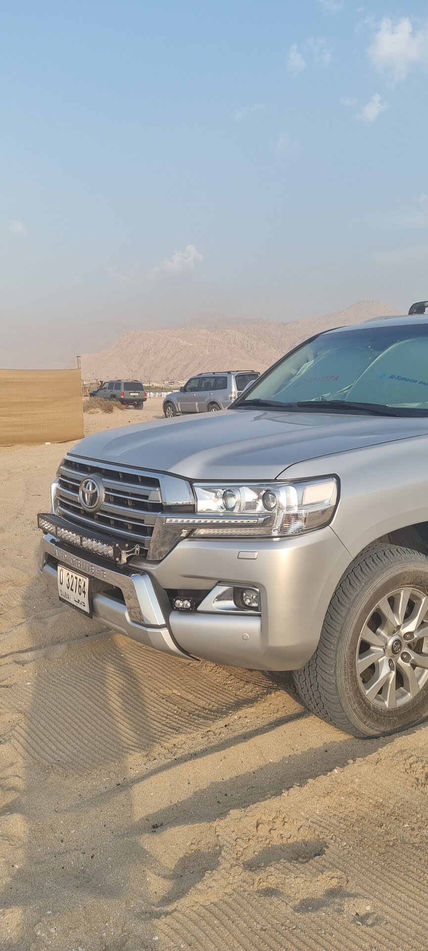

Another option:
S2's for ditch lights just screwed through the plastic of the bumper with a washer / nut behind. 2-3 years now and never moved around.
30'' arc ONX6 driving and spot combo on a custom bracket. No cutting required. Separate master switches for both. ONX6 linked to main beams and goes on / off with them once master switch is powered on. Easy to adjust up or down as it is outside the grill and accessible.
View attachment 3301567View attachment 3301566.
The S2's give plenty of light out to the sides. The ONX6 has good spread sideways and vertical and reasonable forward distance. Not the very long throw you get with round spots, have some Stedi Type X on a 100 series and that is a way longer throw, but would think the ONX6 would be very good on forest roads, mountainous areas for keeping an eye out for changing terrain (it highlights undulations in the track really well) and for spotting wildlife crossing. The colour is very easy on the eye, not harsh, can drive hours with them on.
