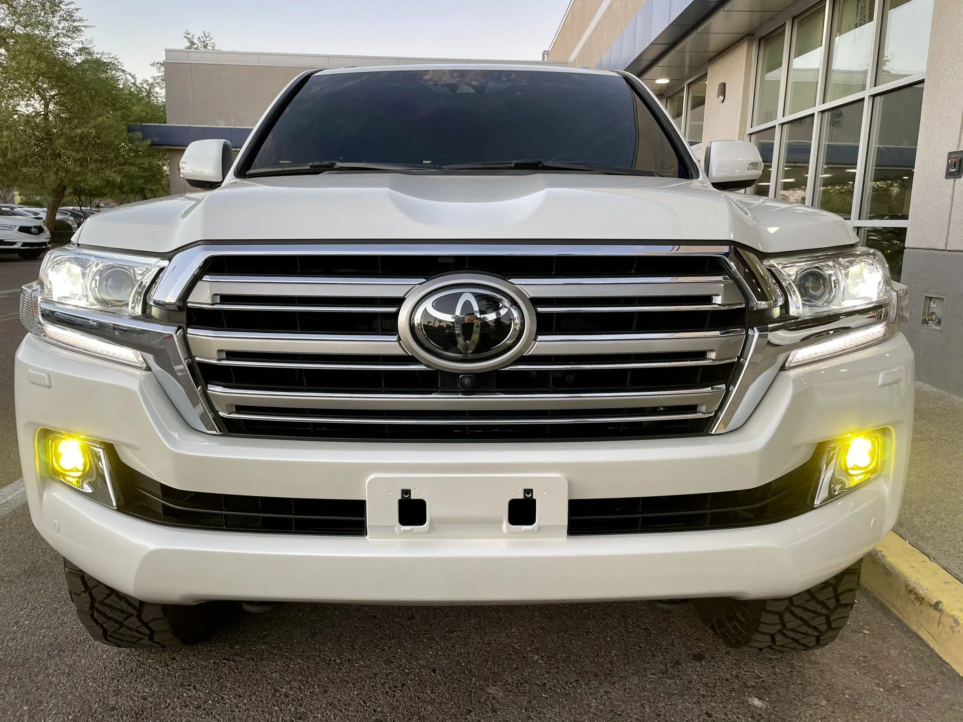

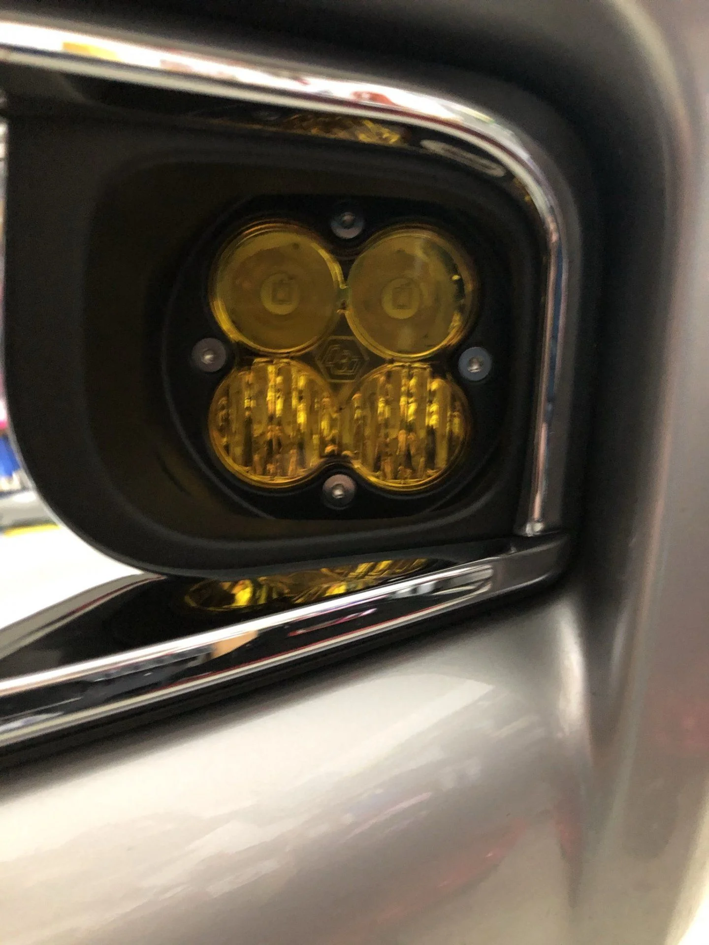

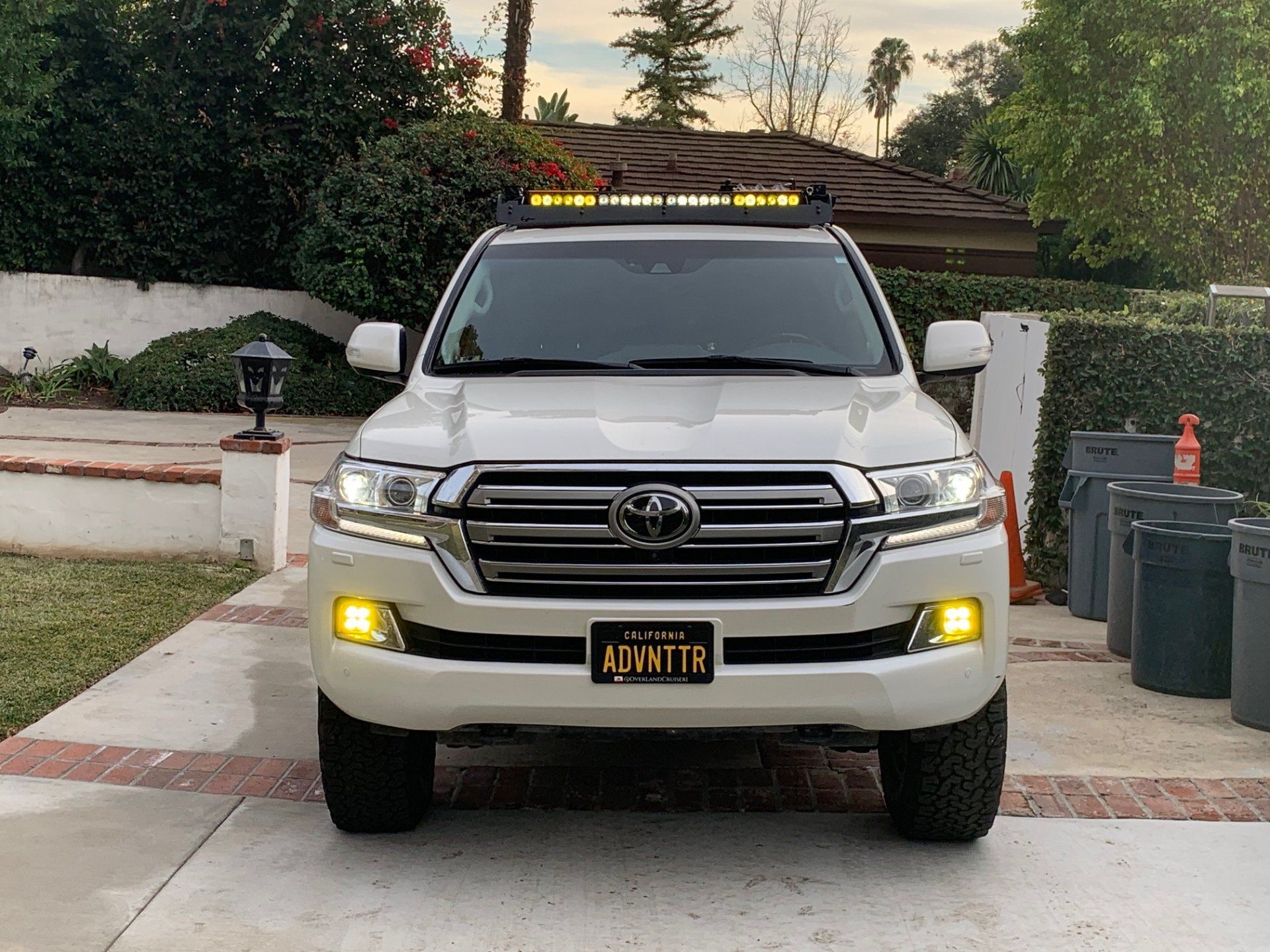

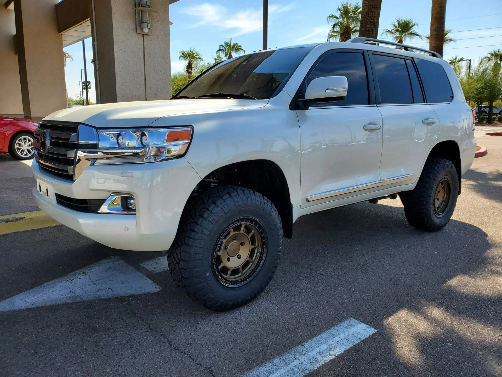

Finally found a solution with the help of a local shop (SDHQ) I’ve been looking for an alternative to the factory fog lights. I put on the squadron pros and used the bezels they included in the kit for a clean fit. It is the tundra fog light kit. Hope this helps for anyone else that has been looking!
Is it just the lens being too close for the photo, or does the bezel cut off the inner part of the light?

I run these in my LX. Amazing. I suspect you can use the SAE lens for the inspection. I ran into a minor issue as want to use the yellow fog lens, but the shroud that forms the bevel won't extract out of the factory hole from the front...which means unbolting the whole thing from the back.

for those that want a closer look....they fit great!
How do you like the light output compared to the stock LEDs? I have a set on the shelf including the brackets, so this would be an easy mod. (I'd probably need to source DOT lenses though to avoid the inspection issues.)
Two different questions there. I love the output. I’ve always been a fan of Rigid Industries but they could not tell me if theirs would fit.... but Im very very pleased with the BD. Note the non-fluted top lights.... they have a crazy throw and easily blind on on coming drivers. I’m going to replace the lens with all four fluted and hope that lowers the projection so i can actually use them with my low beams. As it is now, the output is further and brighter than my high beams only.

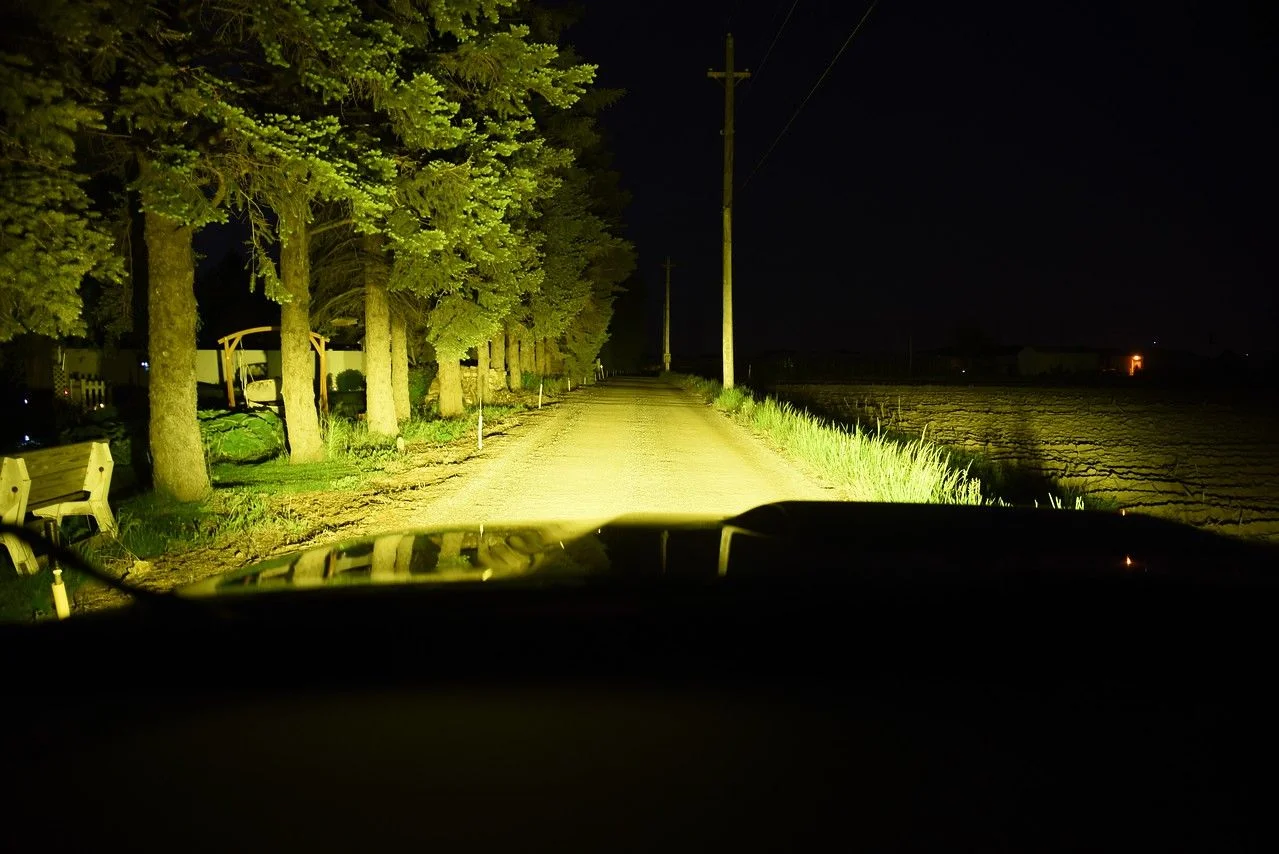

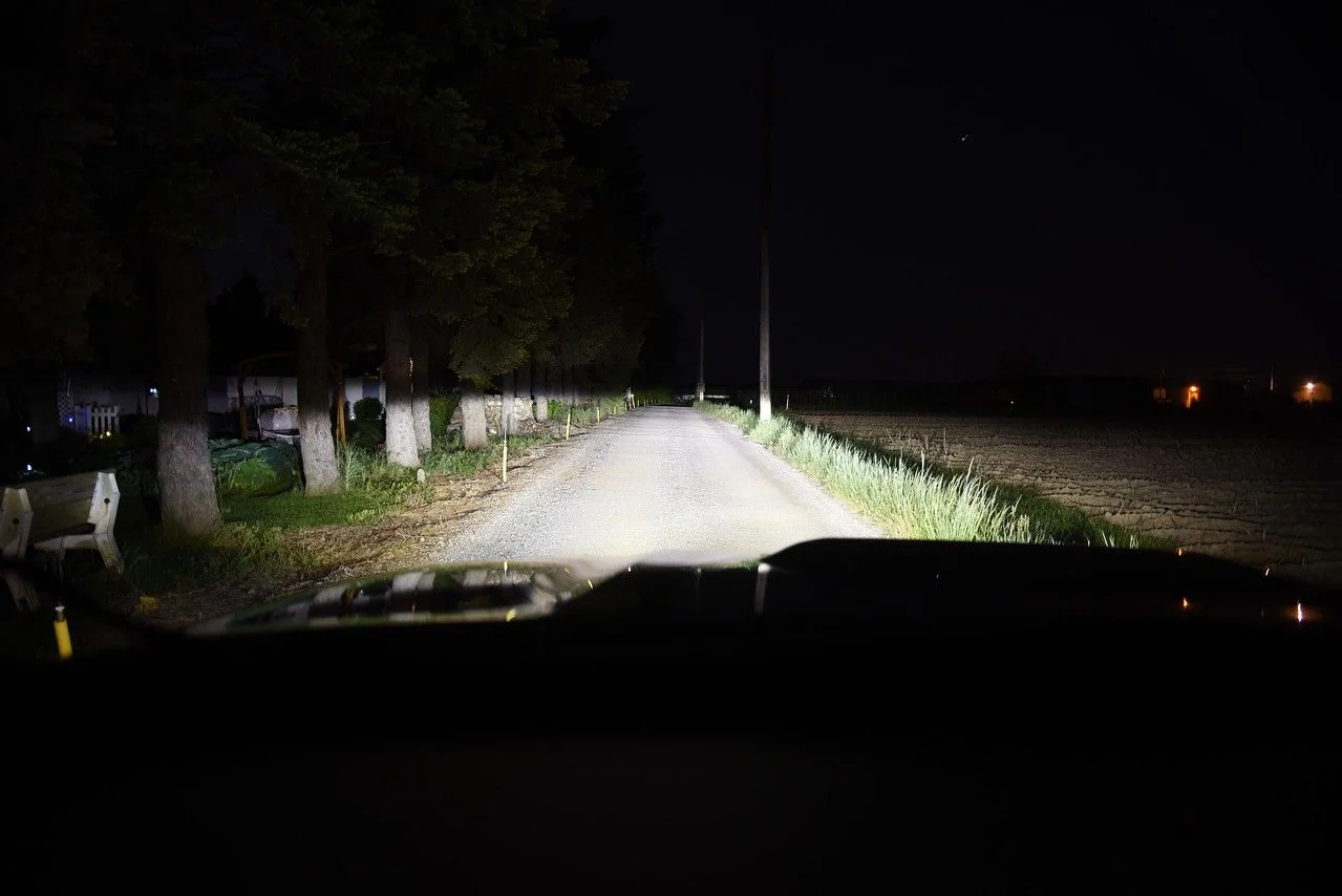

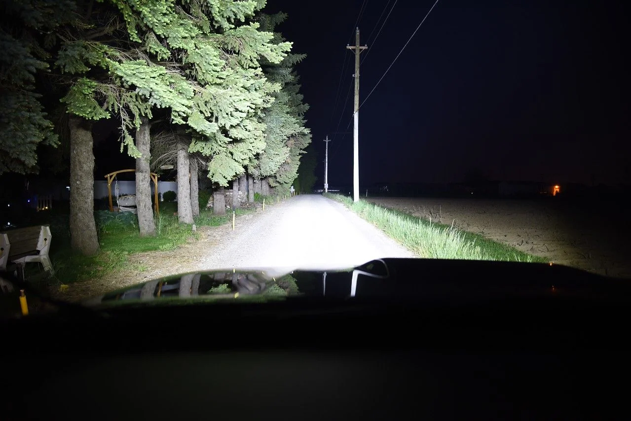

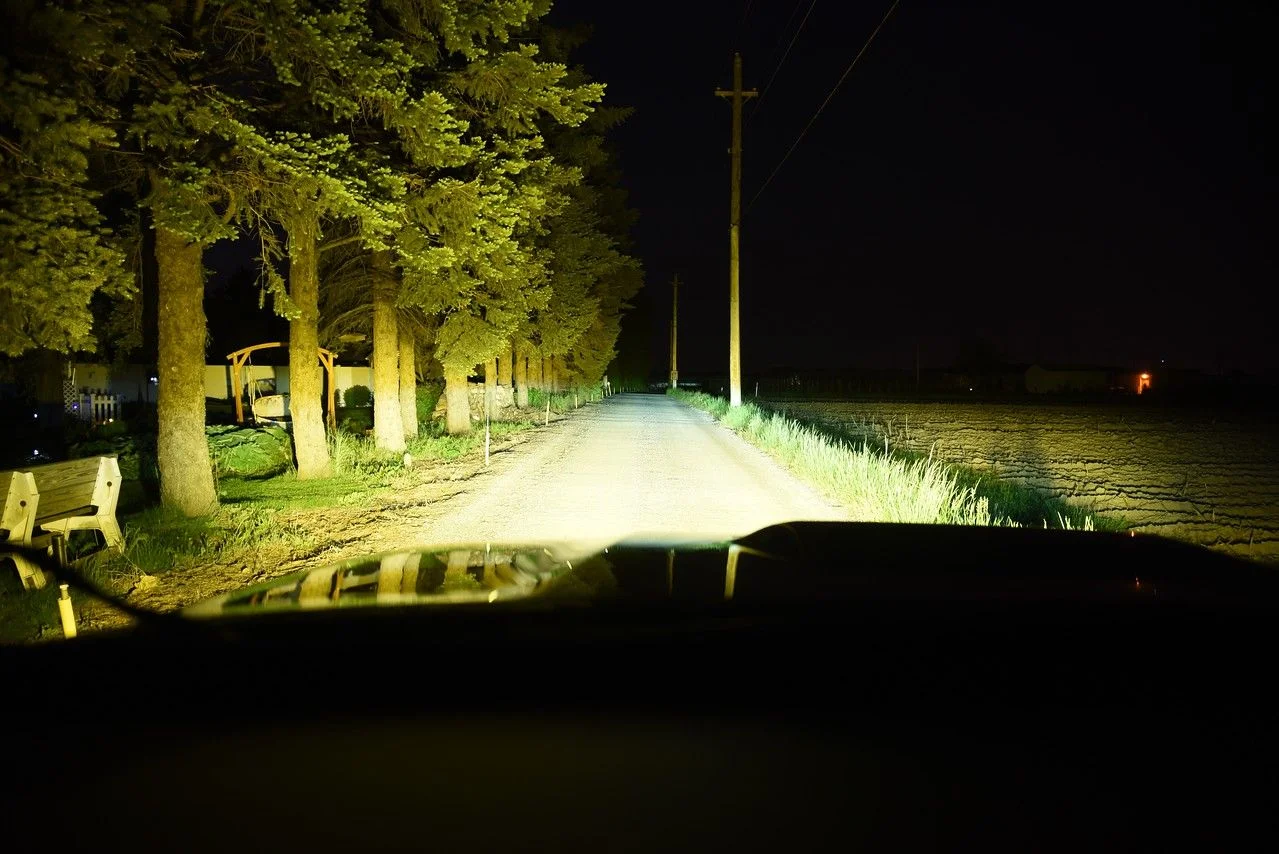

Not exactly what you were asking for, but at least a comparison to other lights. Camera set in manual mode with manual white balance to give true comparison. These are on my 2016 4Runner.
Xenon Depot HID low beam only
Baja Design Squadron-R Pro Amber Wide Cornering only
Xenon Depot HID Low Beams and Baja Design Fog Lights

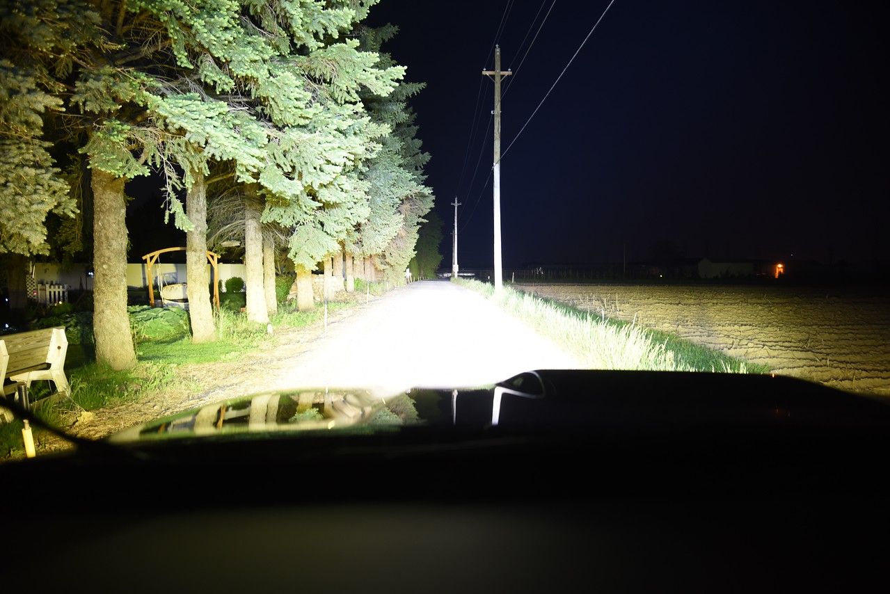

OPT-7 32" LED Light Bar on Prinsu Rack only
Xenon Depot HID Low Beams, Stock High Beams, Baja Design Fog Lights, and OPT7 Light Bar
