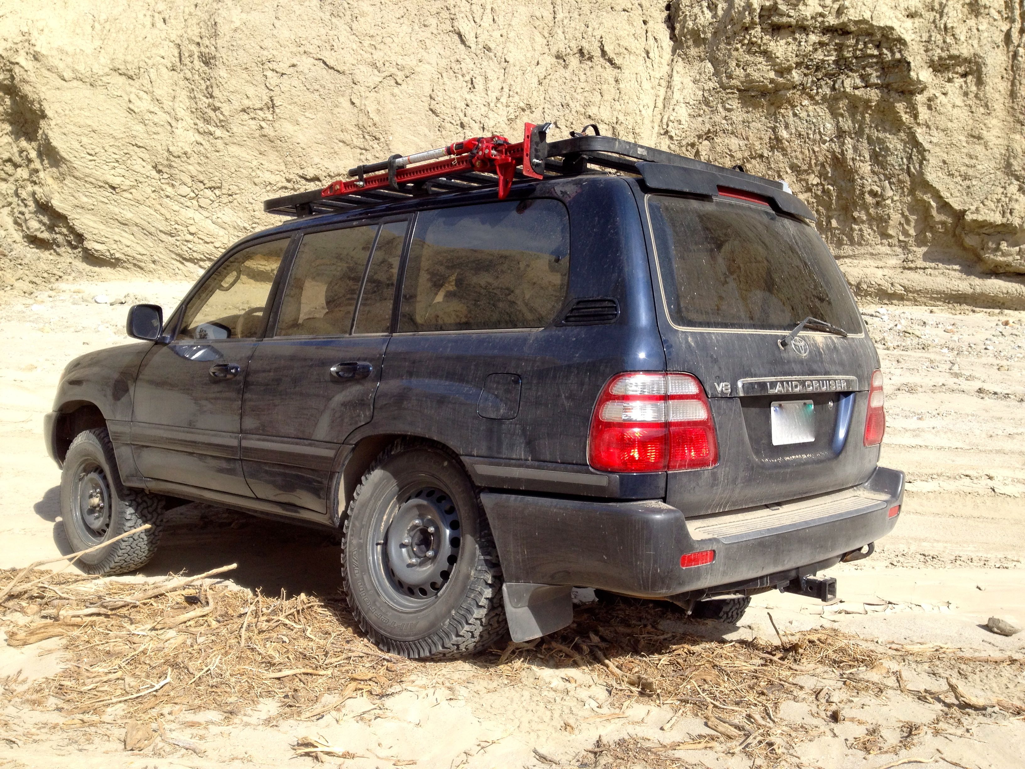

Just got a set of 4 18s off Craigs List for $100. :)
Going to paint them Gray or maybe Black like Rundogs5000's pictured below.

Black is so 10 years ago . Keep them silver or go old school Toyota gray.
I always thought 18s are too big for off-roading , oh well. nice wheels dude
These wheels will be for snow tires for the Wife's rig :princess:
On mine I run LT285/70R17/D

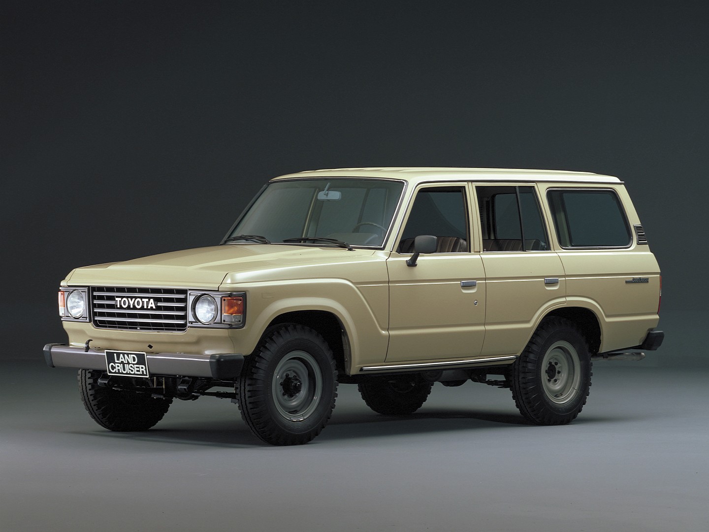

Here is StinkyFj60's wheels...his are actually split Rims.
Remember my Cruiser is white...what color of Gray is on the 60 above?

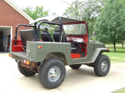

Those 60 rims above are split rims. I am not sure what color they are but I refinished my 40 series disk brake steelies with Krylon Smoke Gray. They look very, very close to factory steel wheel color for 1977. Here is the best pic I have of the color:
I was really pleased with the Krylon Smoke Gray.

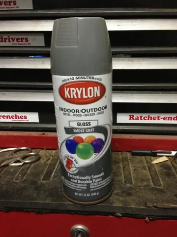

Did you use the Rust protector version? Also did you use primer or a clear coat?
I used an etching primer, then smoke grey, then a clear coat. But, I had to sandblast my wheels. They were an original set that needed some TLC.
Your wheels look like they are in new condition. I would wash them with Dawn dish washing liquid (grease cutter) and a fine grit Scotchbrite pad (purple). That will degrease and scuff them up enough for paint to grip. The original paint on your wheels will function as the primer. Then after they dry, wipe them down with lacquer thinner and go ahead and paint them with the smoke gray. 2 light coats then 1 medium coat to finish. Read the paint can and follow directions for how long to wait between coats. Clear coat the same way, 2 light coats, then 1 medium coat.
You really would only have to paint the faces. It is all that will show.
This is the one I used. I think I bought it at Walmart.
