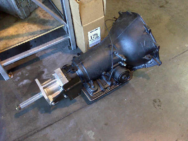

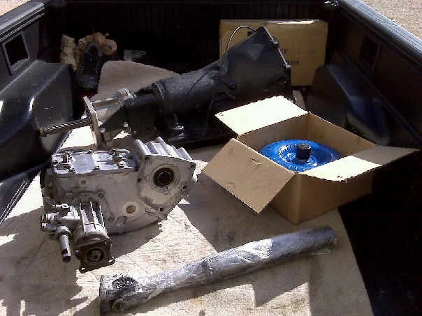

my AA kit and tranny
here are some pics of the parts im using to go with my SBC and 700r4
by the way....its pretty long
