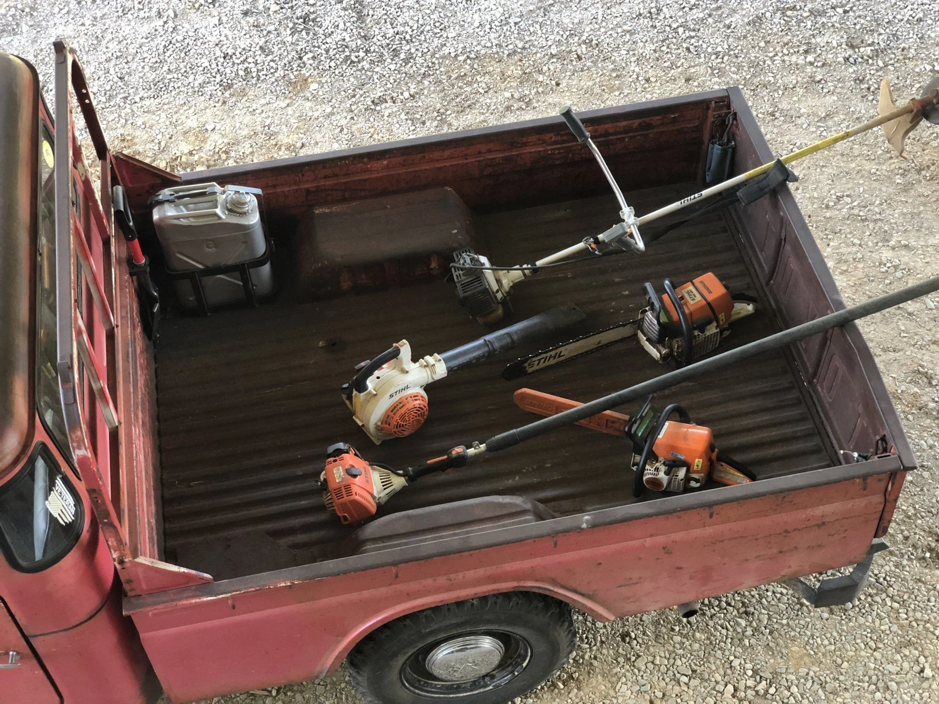

I was proudly cruising back through the farm after using all my power tools and the motor mount broke.
Pride. It will always get you in he end.
Metal fan on metal shroud. That’s loud.

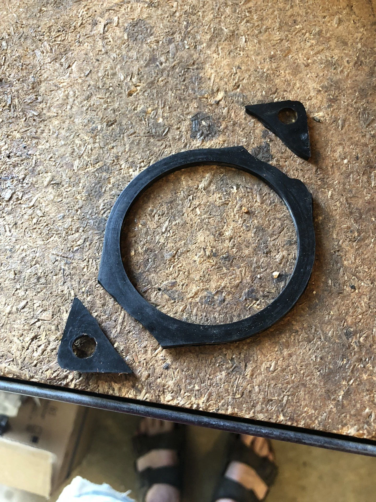

One thing though. When I put sending unit in when I redid the tank back in January I used RTV. That was a mistake. It was gummy. And would have caused a problem soon.
I did not have the proper rubber gasket but lo and behold the early rubber thermostat gasket works great with a trim.

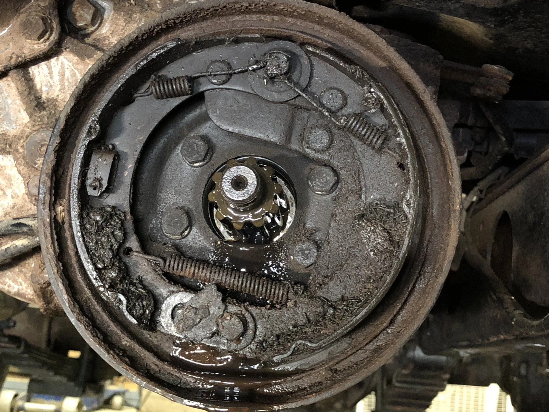

One part I purchased back when I loaded up on brake cylinders from
@cruiseroutfit was a parking brake rebuild kit.
Easy enough right?
I popped off the rear driveshaft and took a belly full of 90wt on my nice @Cruiser Corps Tshirt.
Dammit
I’ve never had a driveshaft act as a seal for a leaky speedo housing
Ugh. Dammit. Crap. All of the above. A simple rebuilt parking brake is now a rebuilt speedo housing via Mudrak.
Dammit.
Did I say dammit?
Have you used a speedy sleeve already?
