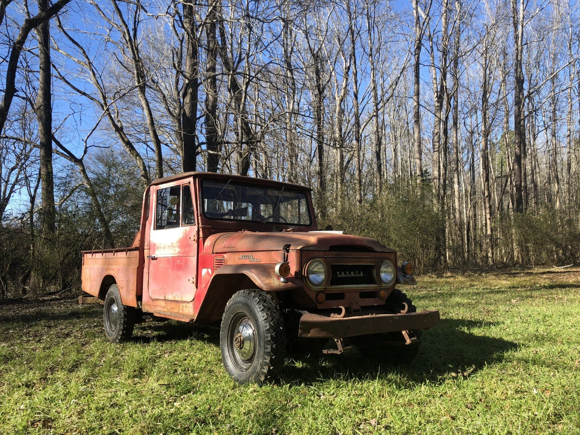

Build Goat. A 1967 survivor FJ-45 LWB
Member Builds and Stories

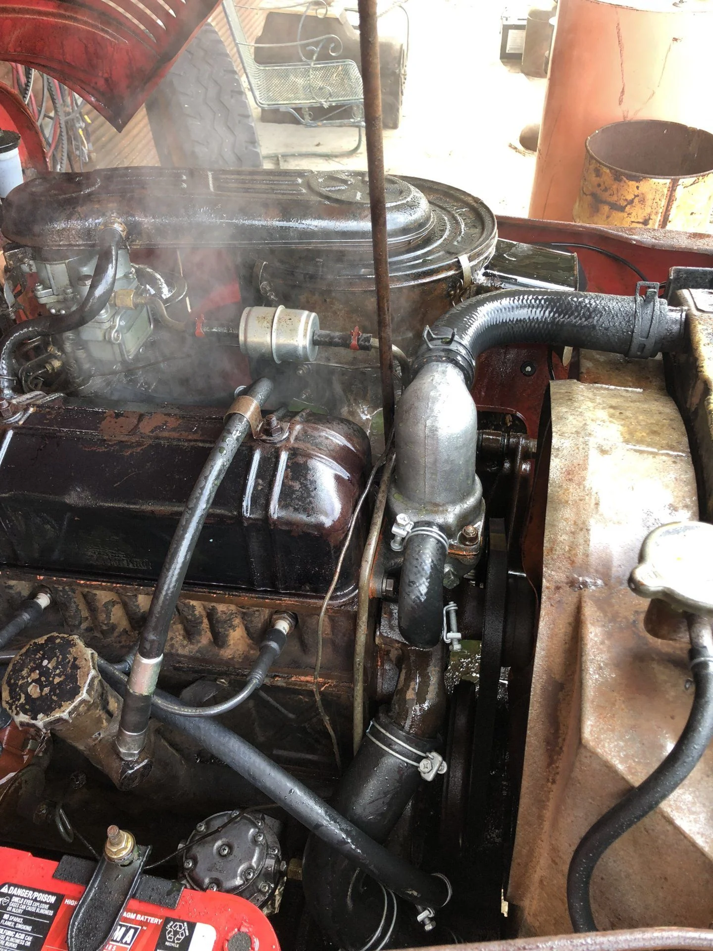

Perfect timing by @65swb45 the tall replacements thermo housings arrived.
Perfect fit with no leaks.
The level of confidence I have in a Toyota with fresh belt, hoses, fuel system and plugs is amazing.
I need to adjust the front brakes and I’m ready to get some miles on it.
Curious why you decided to go with the two different style hose clamps---the constant tension band type on the upper radiator hose and the oem-style wire clamps everywhere else? Just an individual preference?
Really enjoying this thread, by the way. It's super helpful, and fun.
@beno turned me on to those when I did my 68. I really like them. Maybe he can shed some light on the why.
This motor is so smooth

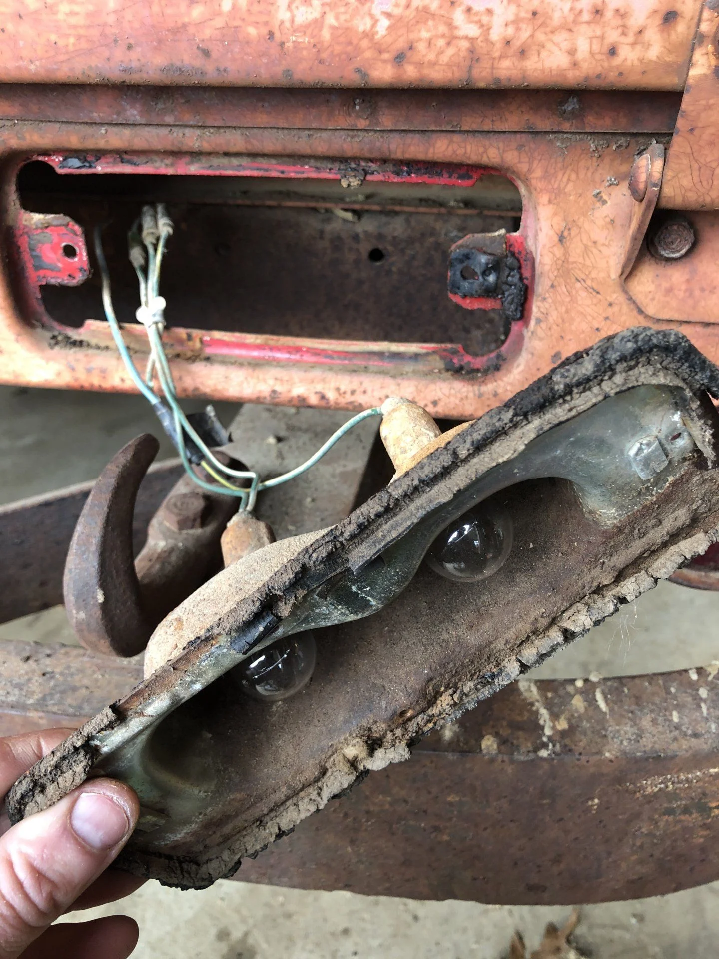

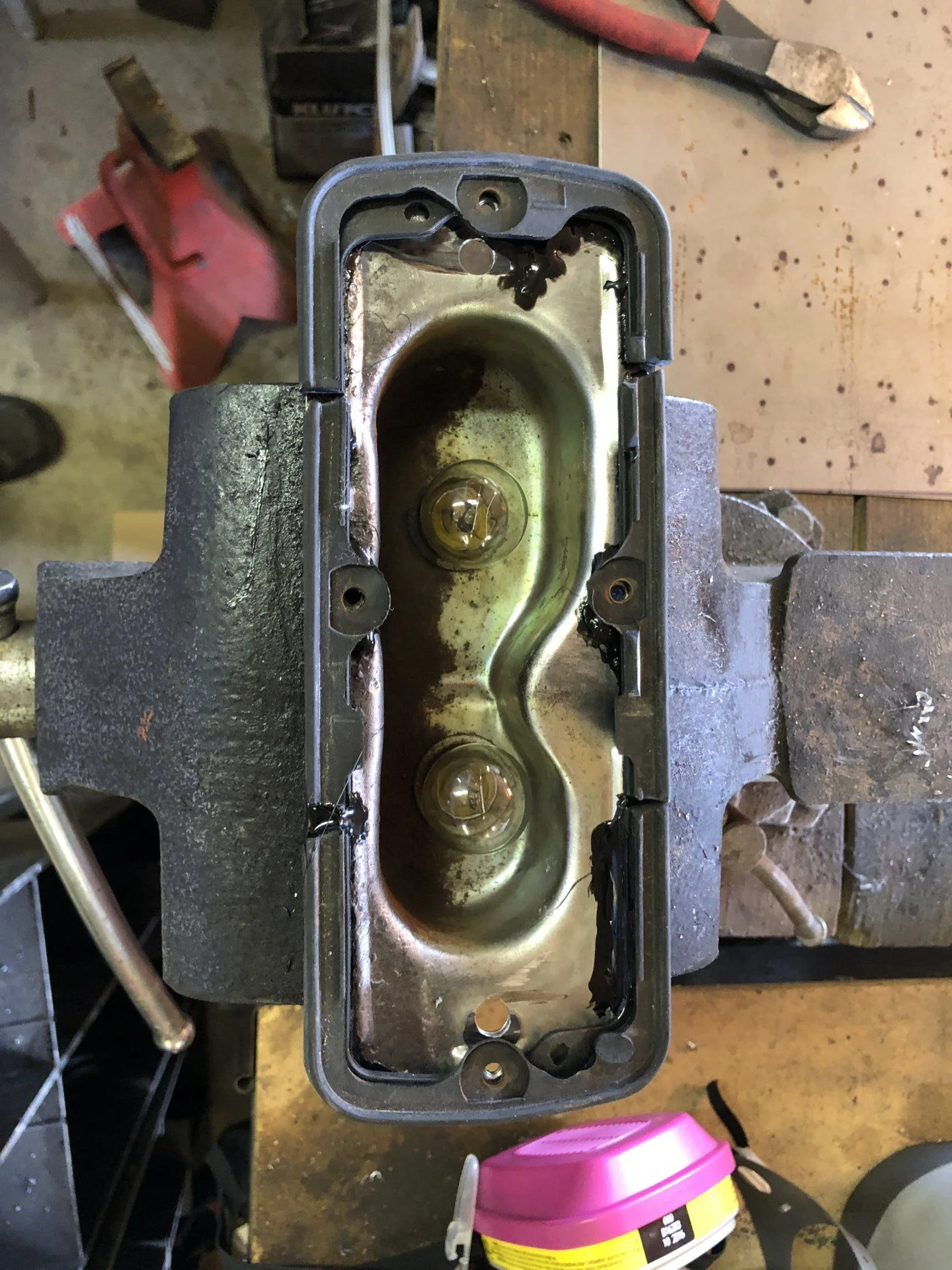

Dove into the sporadic rear lights. @JasonH suggested it was a ground issue so I decided to pull them out

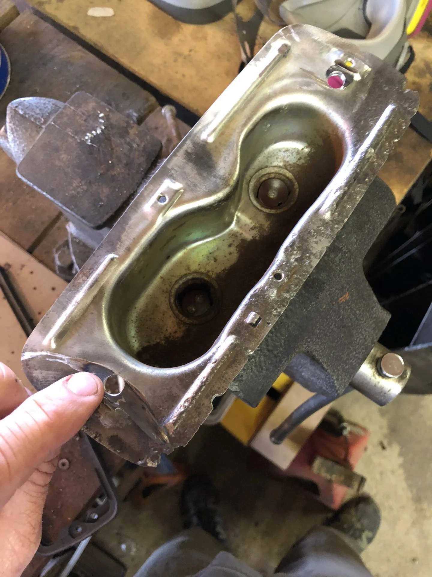

And clean them up good
Wire wheel love
I cut down some late 40 gaskets
Lights!

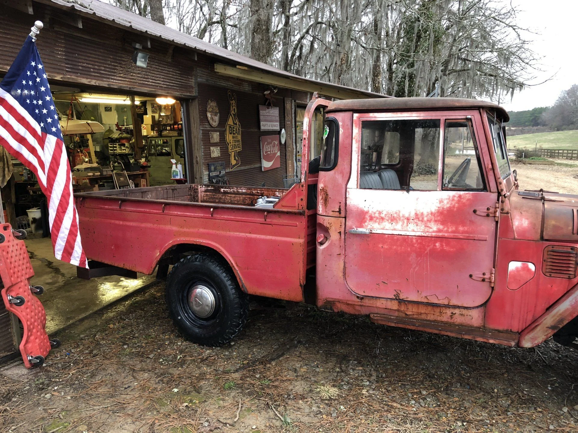

I also hit that section under the tailgate with CLR and got a preview of the paint under there.

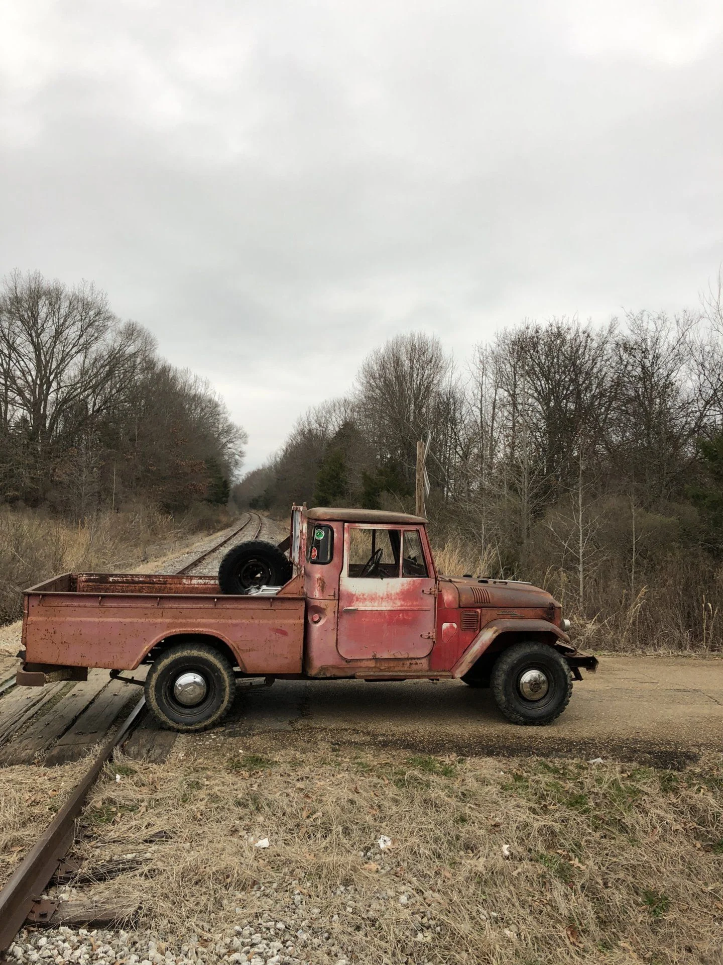

I put about 20 road miles on it today.
I really like the drivability of the single barrel carburetor. I’ve never had one or driven one. Nice and smooth. No hickup like a 2 barrel with a secondary.
I got it up to 70 with ease. Nice and smooth.

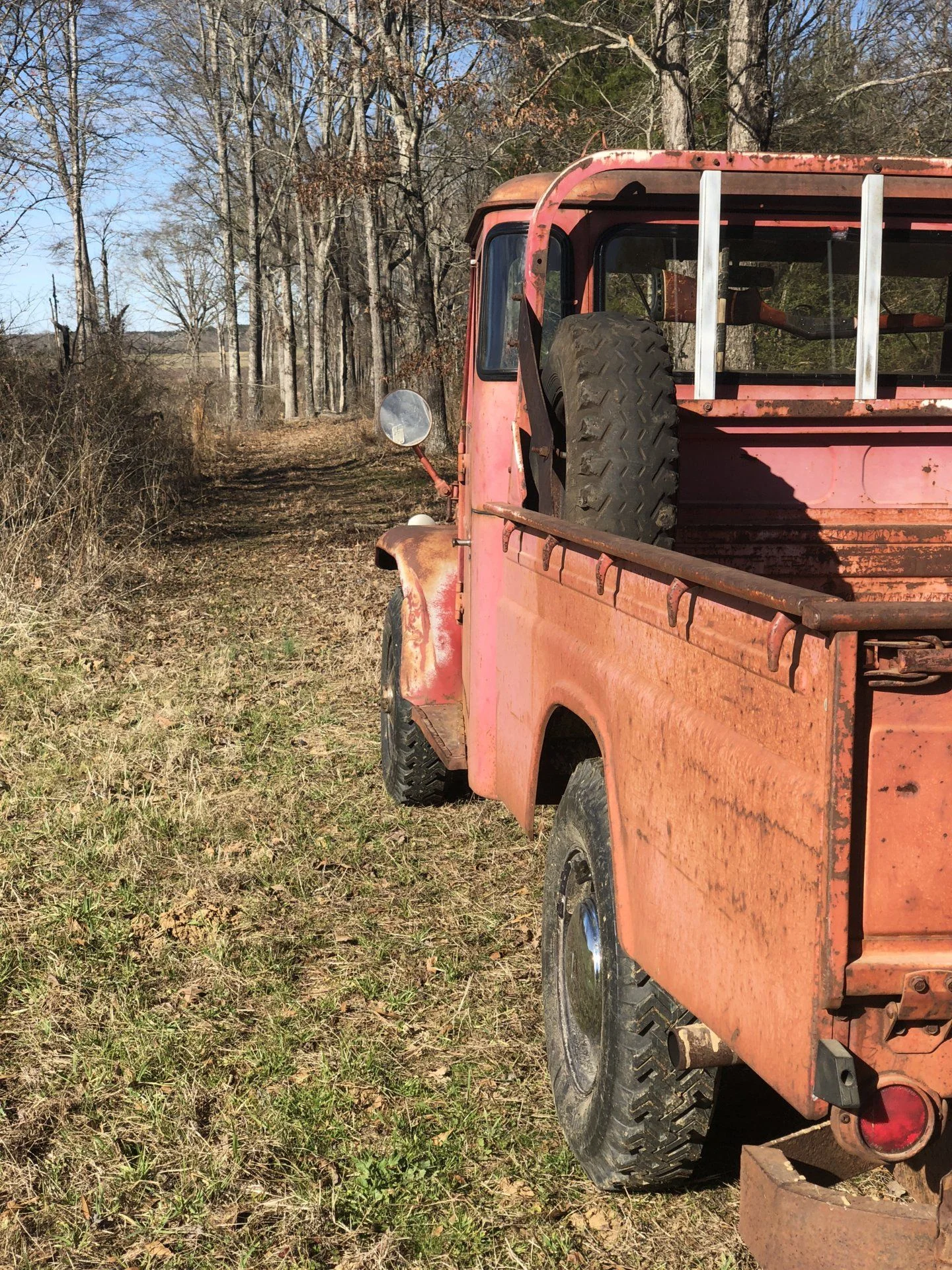

When I got home I had enough time to CLR the tailgate and one rear panel. The red under there popped out nicely. I look forward to doing the rest of the truck this weekend
Goat just keeps getting better and better. I really wish the 45 I found this past summer would have worked out, I may have a line on another one so I'll keep my fingers crossed and continue to live vicariously through Goat until then.
Good to see some mud on those tires.

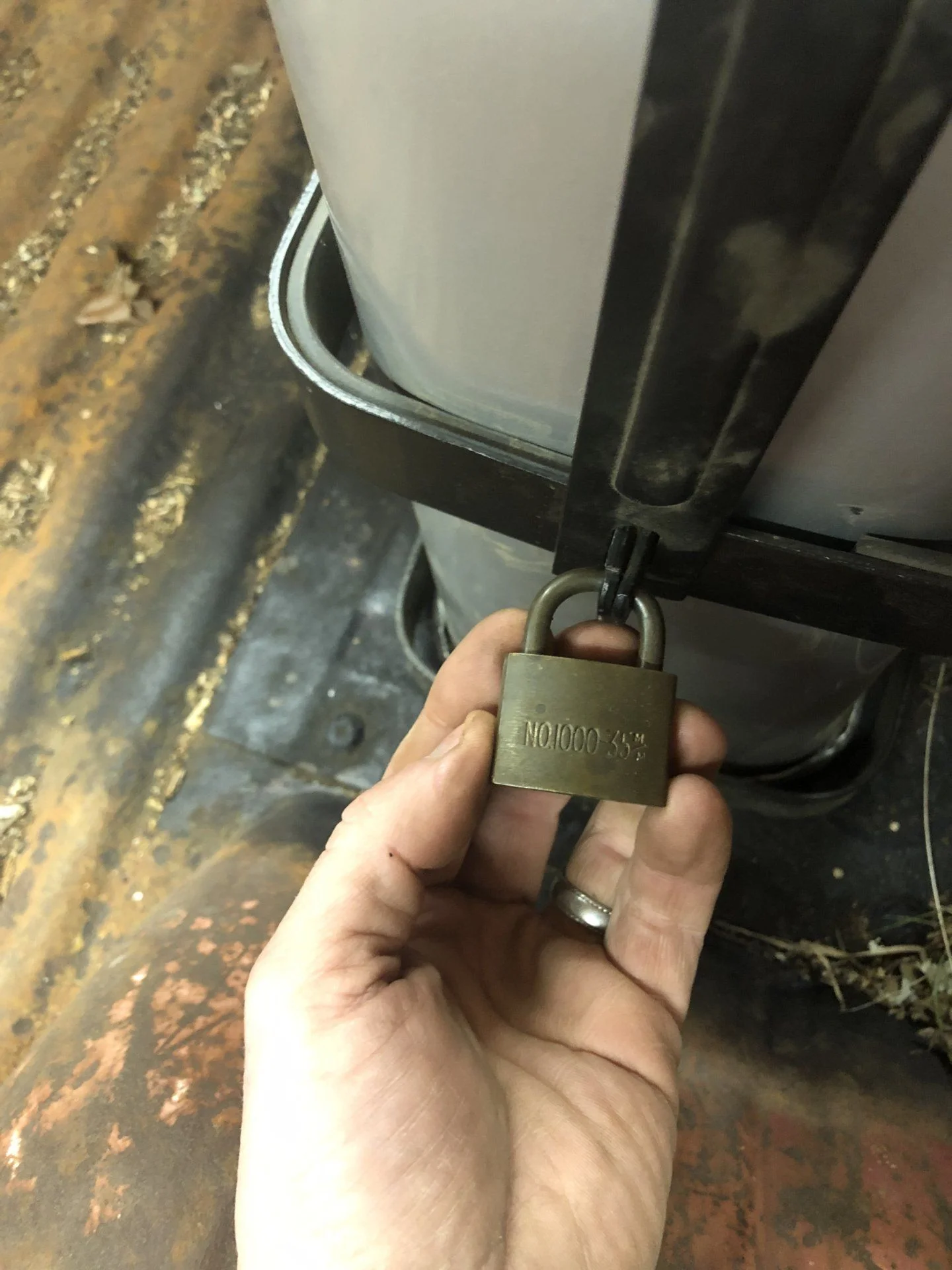

Because @copilot pointed this out, I realized that I have the original ALPHA lock that was on the spare tire
Japanese made padlock.
Survivor.
