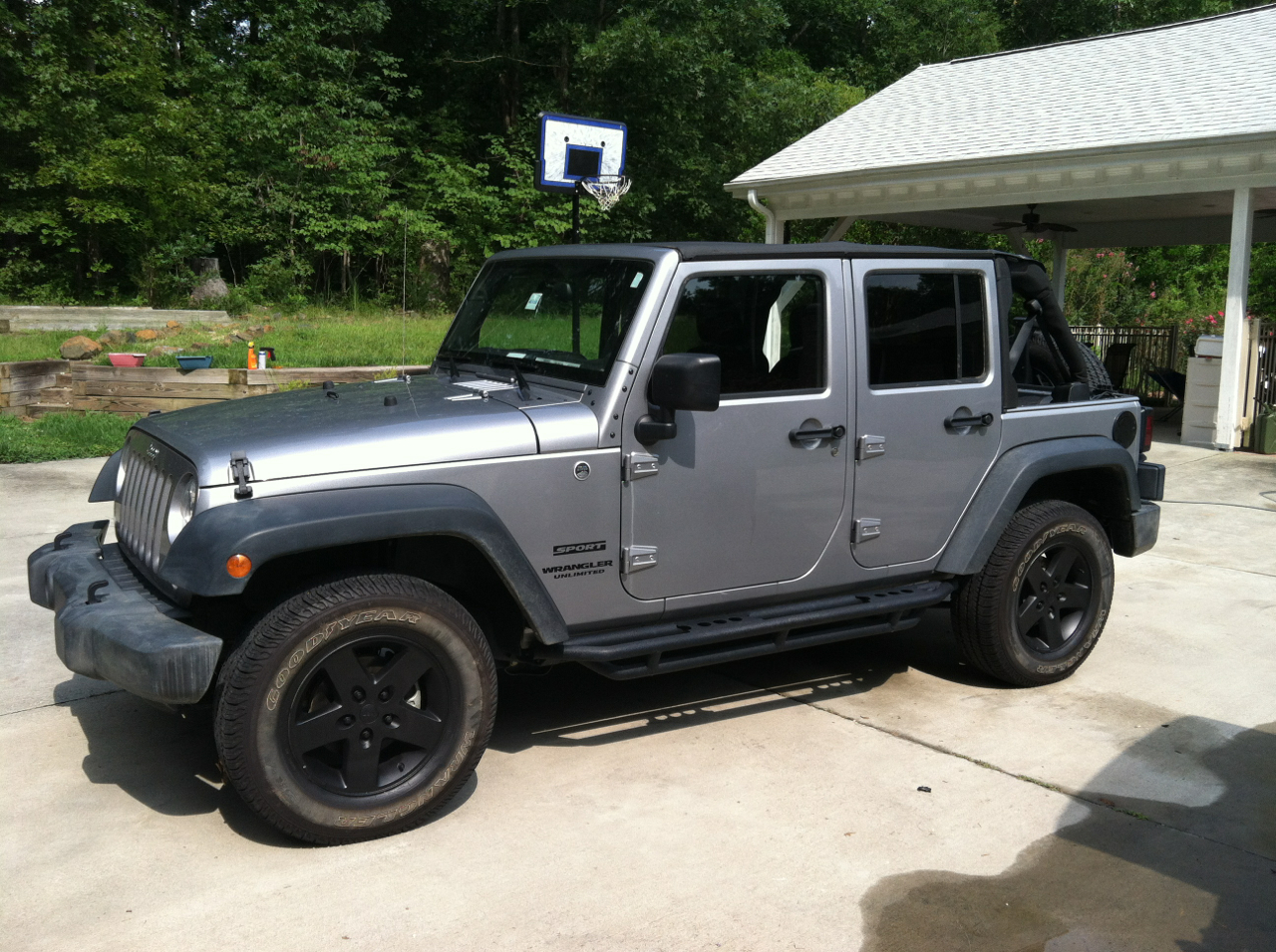

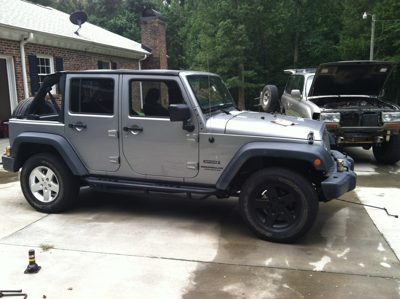

First, I practiced on a friend's Jeep rims. They came out really nice and helped secure a helper for my much larger project. :grinpimp:
In Progress:
After:

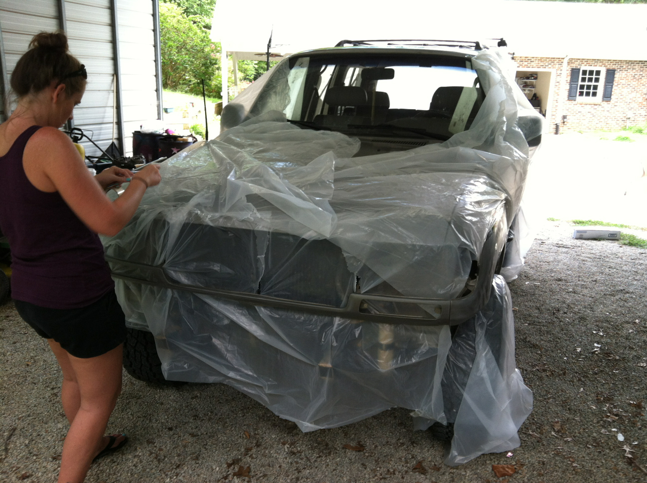

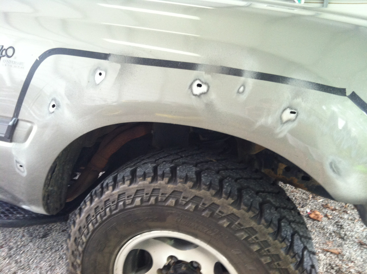

Not bad! Now on to the Land Cruiser stuff... I started by taping off my lines. I wanted to do something different than what I typically see so I chose a line that I think will look good and unique.
Then I used a wire brush to clean any rust spots and the holes left from the fender removal. We scuffed the rest of the areas with sandpaper and washed all the dust off.

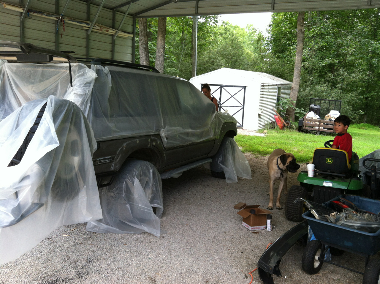

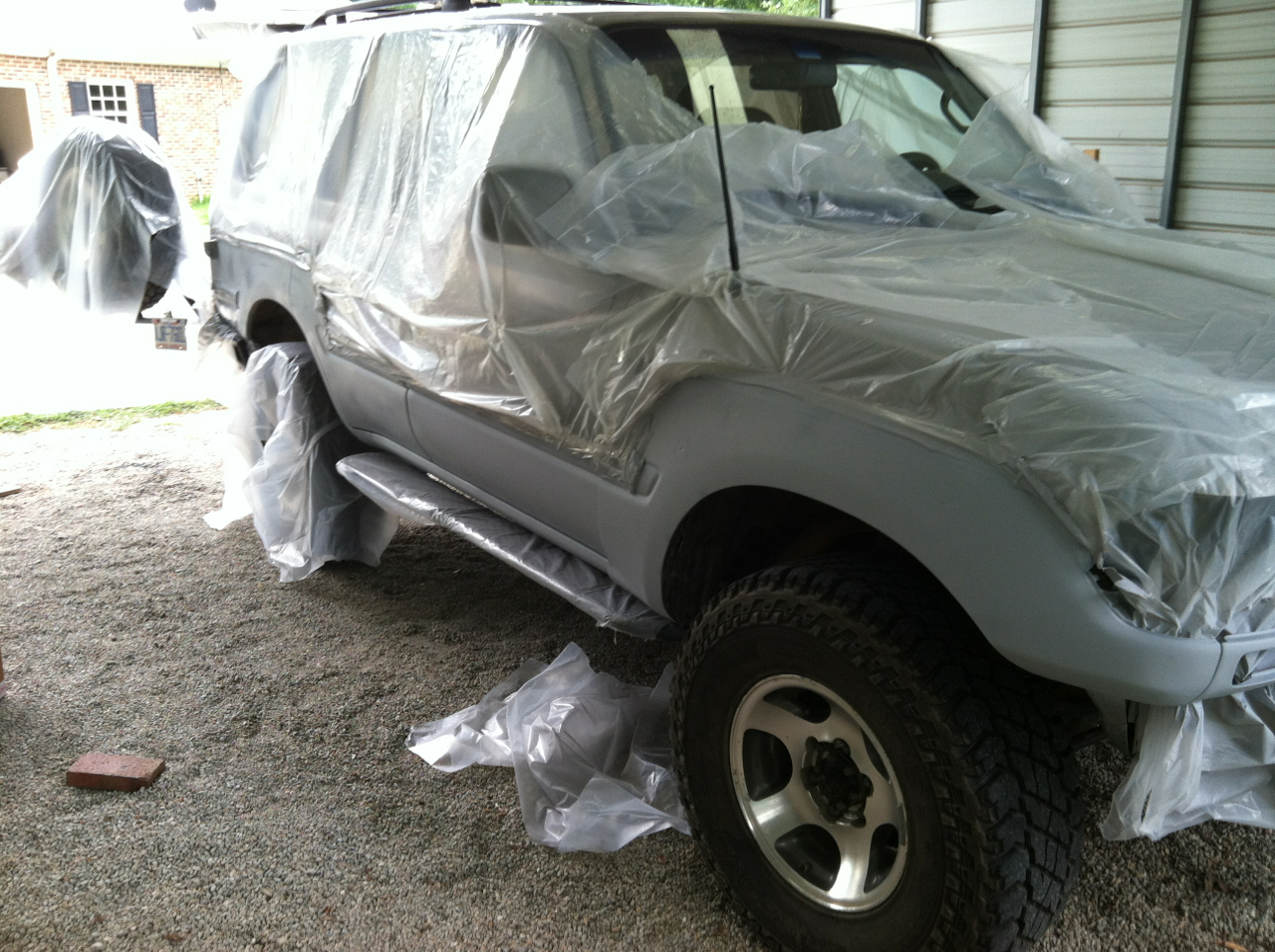

Next, we masked everything off... We might've gone overboard but better safe than sorry.

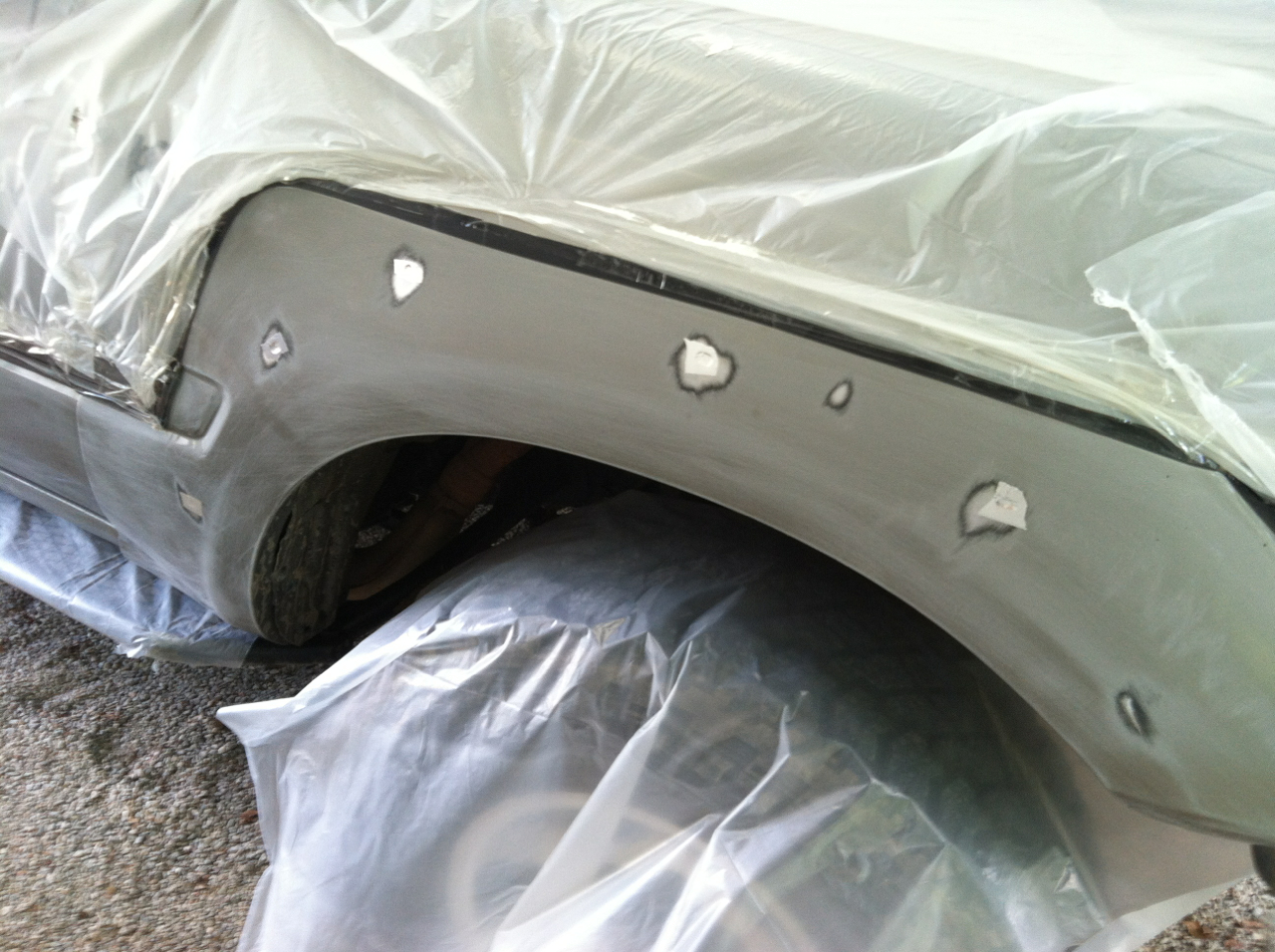

To cover up the holes I used metal ducting tape. It's not a perfect solution but the idea is to make it look good from 15' away and prevent water from getting in. I'm happy with this.

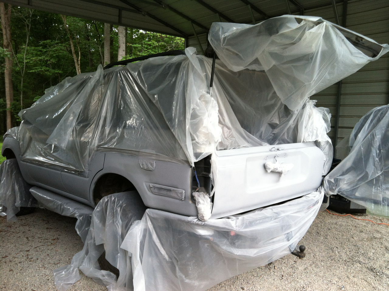

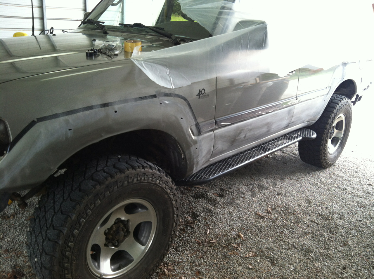

After everything was masked off we layed on a coat of primer. Finally felt like we were making progress!
The tape did a decent job of covering the holes. You can still see a dimple and the outline of the tape if you look close but it's good 'nuff. The only thing left to do is put on the Plasti Dip... at least the first color...
Holy crow, look at all that masking.
I'm sure you know that plastidip peals off so really the only masking needed is the one that creates your line.
when people plastidip the whole car they paint over the whole thing and peel it off the windows and emblems.

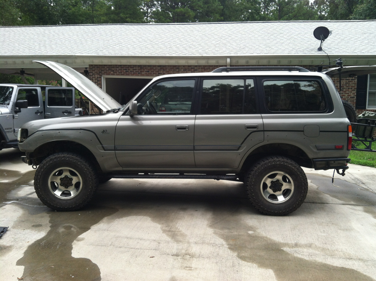

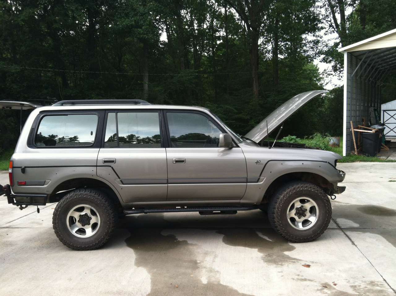

One of the adjuster screws on my motorcycle's rear axle sheared off yesterday so this project got a whole lot more urgent. I had put the last couple coats on Tuesday evening but I hadn't buttoned everything up. I rushed home, put it all back together and headed back to Durham to rescue my bike. I did manage to get a few shots of the truck, though. I haven't had a chance to clean up some of the line edges nor paint the grill slats black yet.
