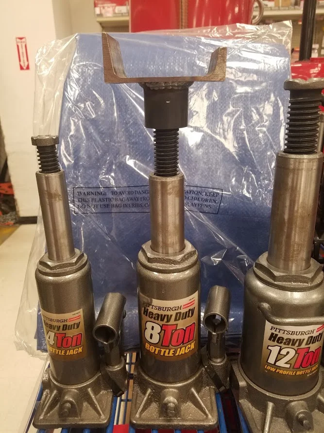

Leaning towards a small bottle jack with a large flat top pad and a cradle thingie for the axel. It isn't huge and I can use it to jack off the frame or the axel.

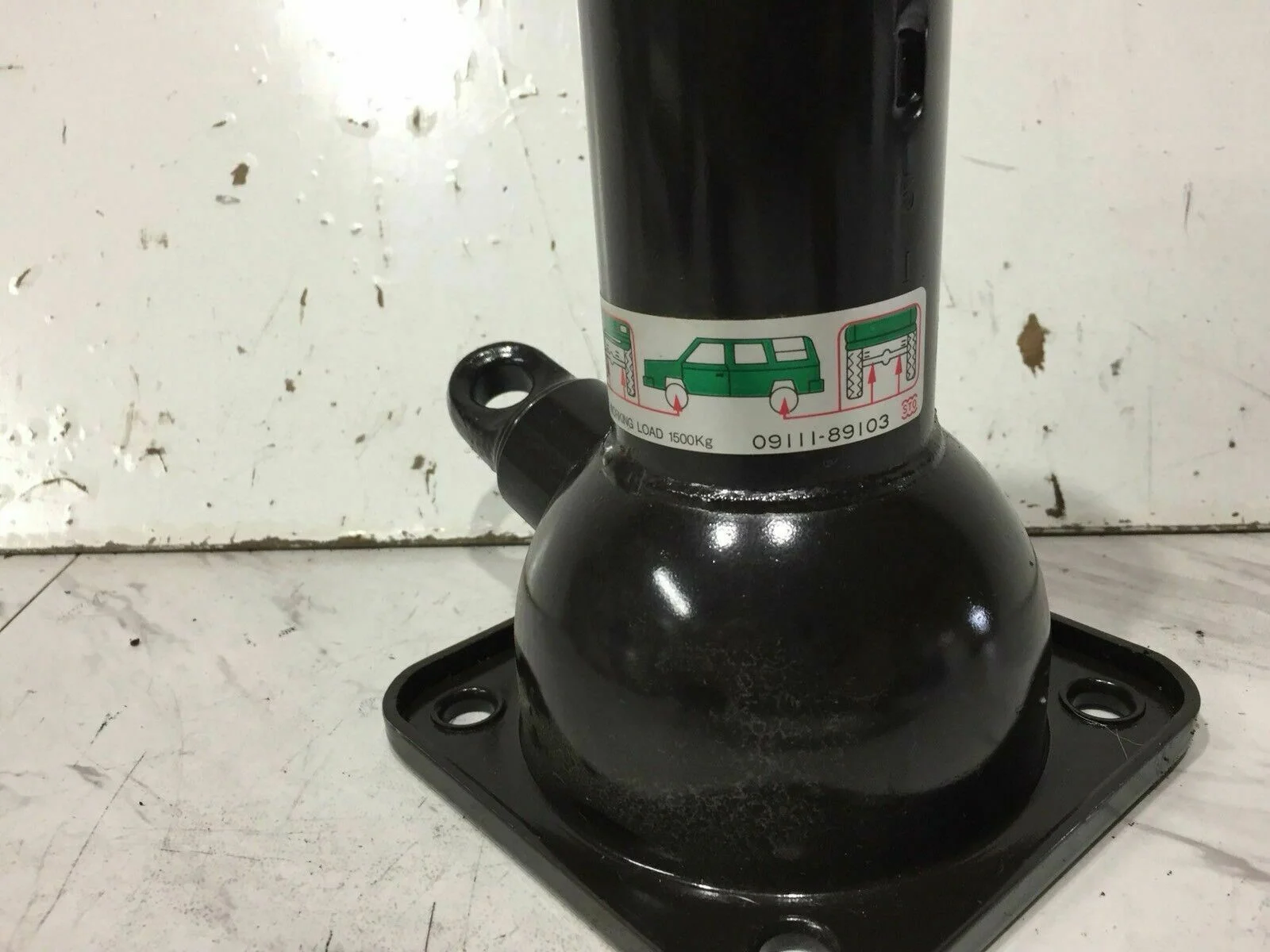

Do you have a part number for that? We don't have Tacomas here in Aus, but I'm interested in seeing if it was used in other vehicles here, or failing that with a part number I could order one in.
I don't have a part #.
I bought it from a salvage yard through eBay. Turns out it had never been used. I researched a bit after I found one to see if it looked the same and had the same tool kit.
You could find a part number or similar vehicle the same way.
Any chance you could check on the label? There should be a part number printed on it, like this:
With a part number I could easily cross-reference and be certain if I'm buying one online that it's the correct one.
