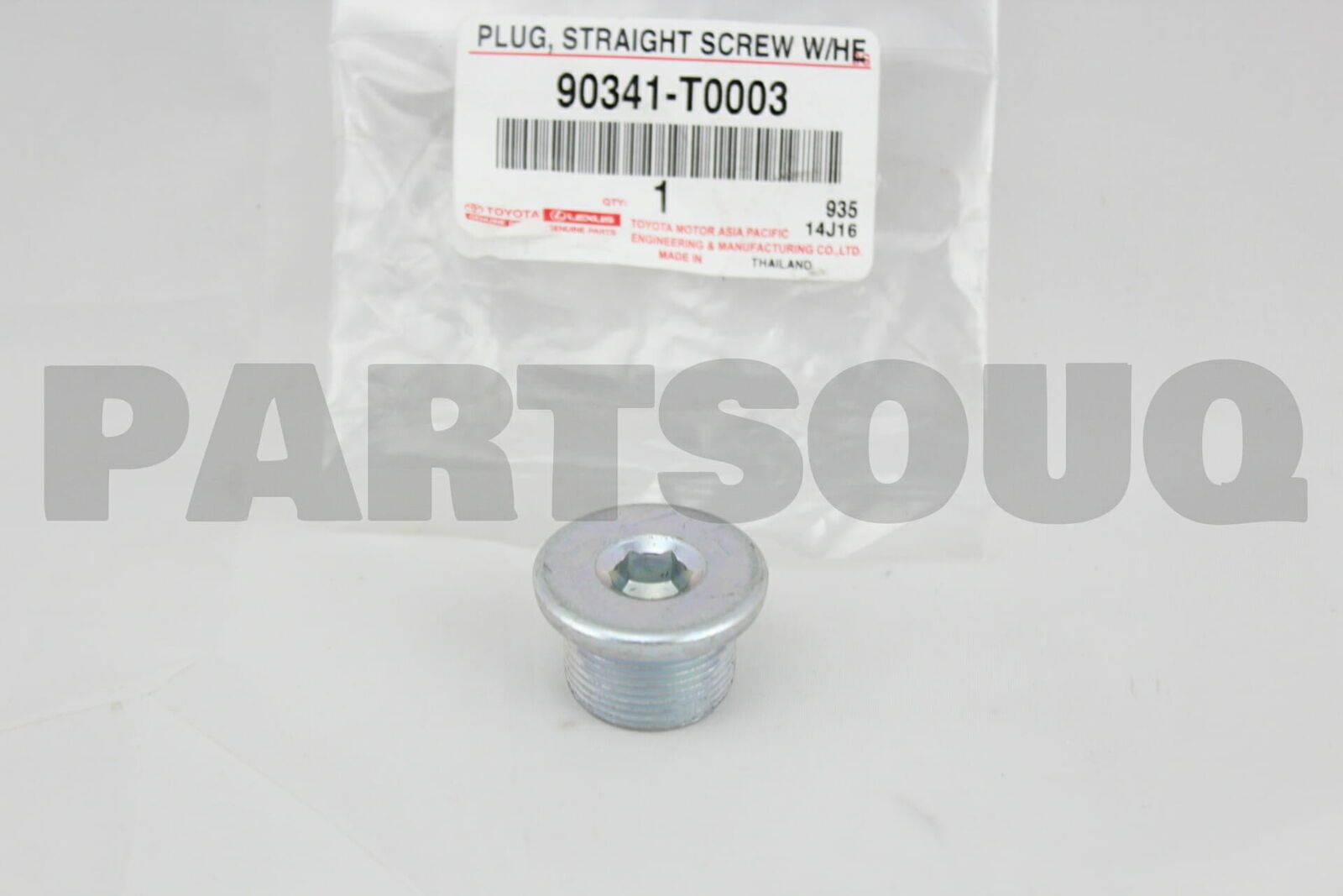

From memory, you need to add a screw in plug to the new input gear.
The plug is the same as the plugs find on the side of H151 casing.
Maybe this one. Not certain.
