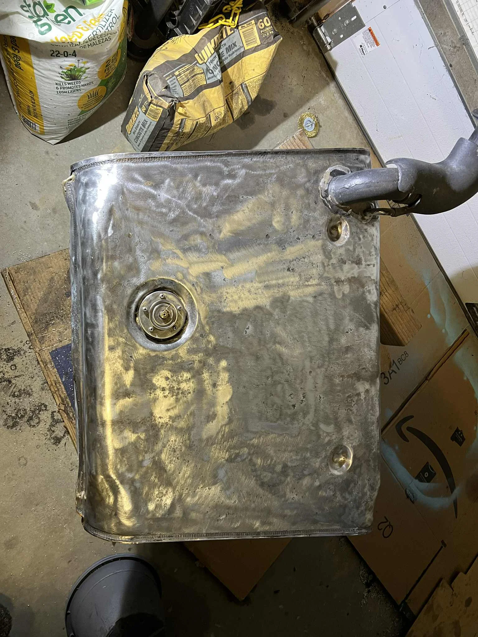

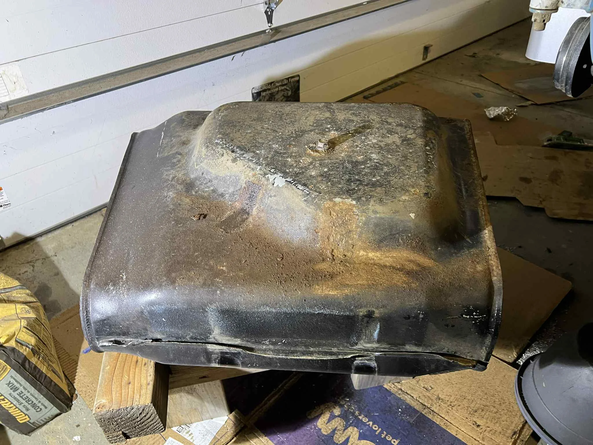

The FJ40 gas tank has seen some wear and wetness. It looked rough and it seemed to have a pinhole leak somewhere, based on the small gas stain it left sitting on the garage floor for a couple weeks.

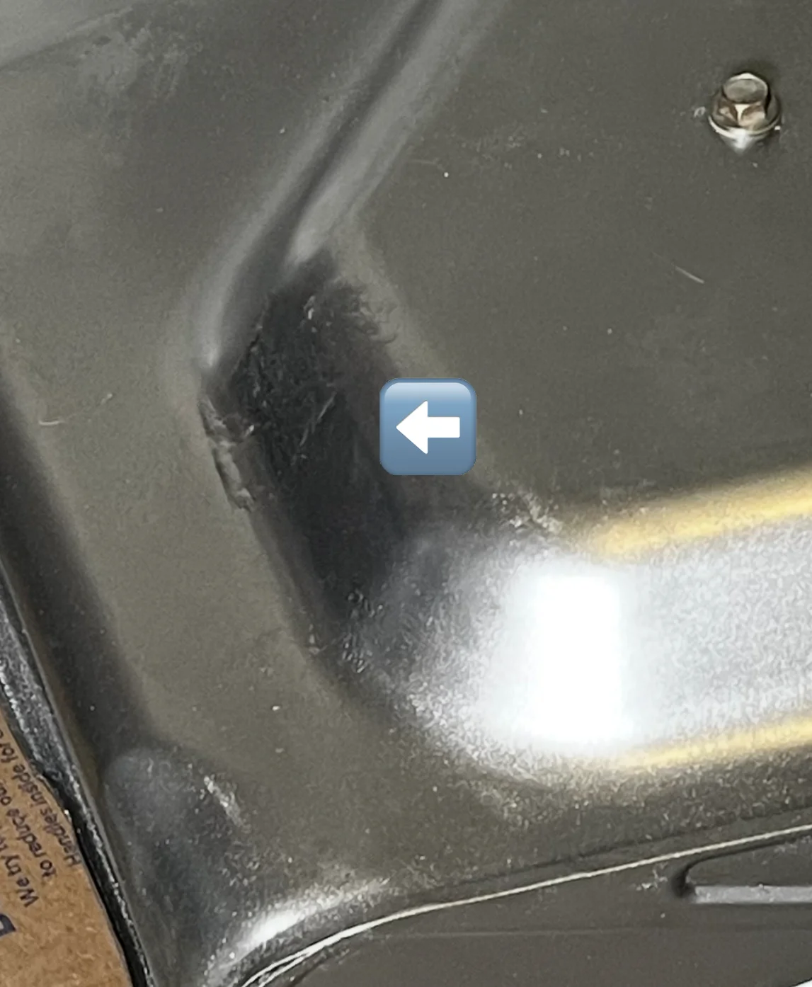

While wire wheeling the old paint and accumulated grime away I found the leaks. They were underneath one of the pads that goes between the gas tank bottom and the passenger side floor pan where it sits. The old OEM pad was still stuck to the tank, and when I removed it, I spotted several pinholes.
Overtime, there had been enough water in the passenger foot well to saturate the OEM pad, causing it to retain moisture after the rest of the cavity under the tank had dried. Hence, corroded, metal and pinhole leaks underneath the pad location.
During the process of taking the tank back to metal, I uncovered a couple of other past repairs, brazing some tank seams to stop leakage. Those repairs were still good.
After thorough surface prep, I repaired the corroded areas under the strap with the pinhole leaks with two smooth coats of epoxy. When hardened, I sanded the repair to blend in smoothly with the tank.
Primed the tank with a rust converter, sanded, and then applied final coats of paint. I know the OEM tank was black, but I chose a dark steel color that matches the frame and legs on the front seats. I want to build a clean driver, not shooting for show truck.

Here is the top and bottom of the tank when it came out:
