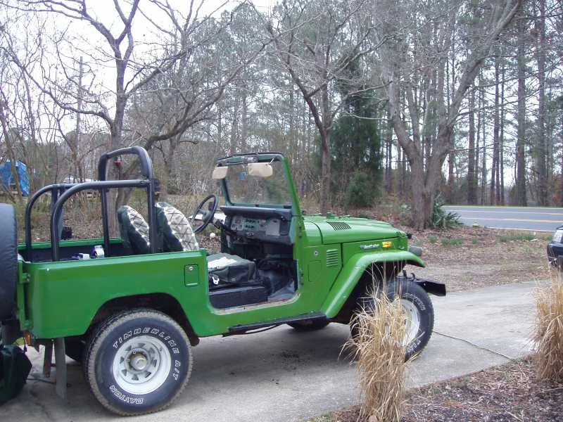

So here's the first pic. Those that went to last month's get-together at the Cary Ale house saw it up close and personal. I'm in the process of scraping/sanding/grinding the entire interior tub. My intent is to get it close to bare metal (to see the bad spots), fix the rot, cover with POR-15, than with Herculiner.
So here's what I run into on the 2nd day of cleaning. On both corners behind the seats I run into some rot. I'm going to clean it up, get some 1/8 sheet? (mostly due to the size welder my bro has) and fab some corners for both the inside and outside. POR-15 all that doesn't require bare spots for the actual welds, and then go back in and paint the rest. I got POR-15 Silver for this reason. PO put foam filler and painted an old school tar/bed liner on it.
I'm debating on how much to put the herculiner on. I'd like to paint the transmission cover, fuel filler cover, gas tank cover, hard top shelf, seat brackets and center console the original nebula green to contrast the black herculiner.

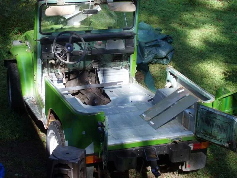

Not too much progress, but it's ready for some... Finished the good parts of the bed floor and POR-15'd it. Cutting and welding to commence in bad parts...
A little something to hold everyone over. I can't find my camera with the latest pics, but this is one from a month or so ago. Wire-wheeled to metal, a little H3PO4, and some POR-15 Silver to cover.
What you can't really see is the holes from the previous pictures, all you see is the angle iron and sheet ready to go in...
Welding is all done. Stress tested by all my 260 pounds jumping up and down on it (it should hold for a little while). Now I need to figure out what I'm going to do with my tranny cover (pretty rusted at the thin edges), clean the welds, primer it, and then get it ready for 2 gallons of Herc.

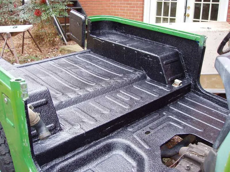

Well this picture will be better than than the ones I printed out for the last meeting. Two gallons of Herc. on the tub. Going to let it sit for a week or so before I start putting things back on it...

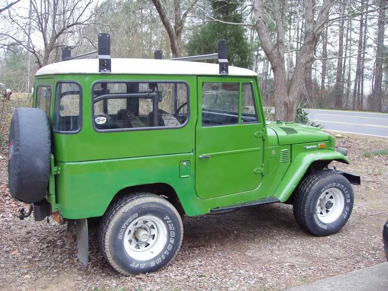

OK, so after skipping this months HAMOM, sorry everyone, the John Deere Green 40 is reassembled (somewhat). Next in store is to reconnect the heaters, swap some shocks out, have a muffler shop do my exhaust, (stainless?) and get into the rats nest of electrical wiring. I've already been in there once and got half of the problems fixed, but I need to get all of them taken care of. There are other items to be addressed, but nothing too major. Enjoy the pics...
