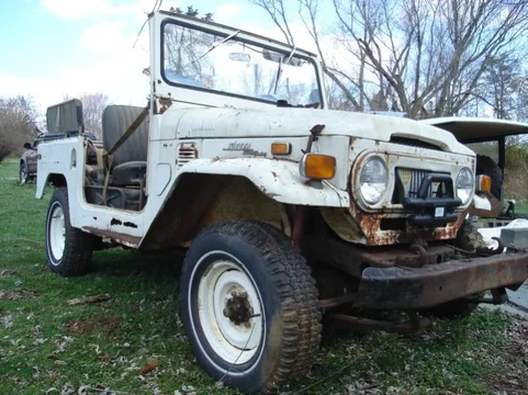

Anyway, here she is, more or less, as i found her. $650
Yeah, it's got its share of rust. But I think the good outweighs the bad. She's worth saving. The further I've gotten in to it, the more pleasantly surprised I've been. Thankfully, it did at least have an ancient Bestop softop and doors on it, so it wasn't sitting open like this as it sat outside for who knows how long.
The best part to me was how complete and unmolested it was. Just about every nut and bolt just like it came from the factory. Minus the bows and soft doors. (of course:rolleyes:) ...and the rear view mirror from a VW.
First order of business was to remove the Power Wheels grill and jeep sticker! MUCH better!

and love the 1st mod...removal of the power wheels grill LOL
passenger side fender looks to be a blend of two fenders...and the pick-up rims look good on it...
love the look of white rims...are you keeping them? you could put clips on them to hold the hubcaps
I think you're seeing a drip line of sap on that finder. This thing was out sitting under a Cedar tree for quite some time. That stuff was on there like concrete.
I do like the white rims. :) I've always admired them on your rig. Yes on the clips. I dig hubcaps. I was tempted to steal them for the 78 since they're disk rims. I hate the rims I have on it now.
