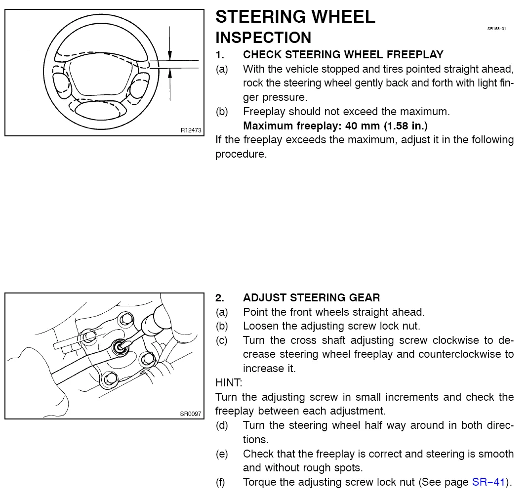

I was wondering if it was possible to get rid of all the play in the steering wheel. Just finished an 1100 mile road trip and if i can tighten up the steering it would make those long highway miles much more enjoyable, I've tried the gearbox screw (I can try tightening it more), new bearings and new tie rods. I guess I'm asking if its even possible to remove all the play or close to all the play in the steering wheel and if its normal to have this play in the steering shaft. It also looks like this gearbox is on the newer side (previous owner). This is the amount of play i currently have. steering play
Adjust your power steering gear.
