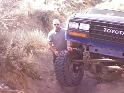

Had a little bit of fun over the weekend. not great pics but you get the idea! If only I had the $$$ to get new shocks I could have kept the tire on the rock!

You are correct. I just used new spring perches and new U-bolts and stock plates and leaf pack. I did not do a C&T but probably need to. I made some ghetto brake lines (stainless braided on order now) and I used the stock shocks. also anti-sway bar. The hi-steer kit is from AllPro Offroad (~$500). And it works beautifully.
All said and done I spent $800 on parts ($500 was the hi-steer kit) plus $200 on some cheap used 35's (since upgraded to some nice MTZ meats)
Like I said, its not how I wanted to do it but I didnt have the money at the time to do it the way I wanted. I just wanted to get out and wheel. I am slowly piecing things together and getting them the way I want.
All in all I love the way it handles and rides and wheels. It has been great. The only thing (besides the things already mentioned) I wish I would have done is figured out a extended detachable sway bar solution (probably will eventually). There is alot of body lean around town, I just have to take it easy (which one should in this type of rig anyways)
