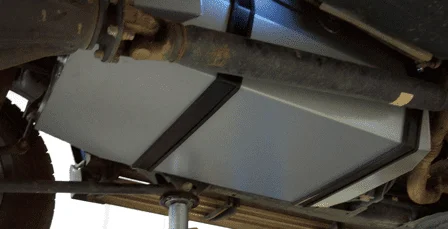

Ok I have a minor leak at the seam of my fuel tank, I know NAPA sells a repair kit for such things. My question is do I repair, replace with new or used?
you could replace it with a 42 gal LRA tank from Cruiser Brothers.......
Thanks, but a minor correction...
Replacement main tank for the 80 Series is 37 gallons - $1,495
80 Series aux tanks come in two sizes
42 gallons - $1,595
24 gallons - $1,595

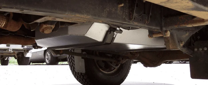

Here is the 40 gallon replacement in the 100 Series - $1,595

We have sold around a hundred tanks during the roll-out period and things seem to be going well - mostly due to Georg, LRA, great shop partners and some patient and tolerant customers.

How is operation of the factory fuel needle with the 40 gallon replacement tank?
I have a used one that I just removed to install the long range tank in my '99. $100+Shipping from FL, should do.
You weld extensions onto the bracket and float rod. The gauge operates normally, just much slower.
From the LRA instruction package for the 100 Series replacement as follows..
3. Remove the fuel pump assembly from the OE tank and lengthen the fuel pump frame with the bracket provided also lengthen the float arm by 75mm using the 95mm length of rod, this allows for a 10mm overlap on the joins. Lengthen the fuel pump wires by soldering and using fuel resistant heat shrink tube. Extend the return line on the pump assembly with the 95mm length of 8mm rigid plastic tubing and the joiner. This allows the return line to reach to bottom of the tank. Fit the unit to the tank and check the float arm travel. Fit the OE roll over valve to the tank.
