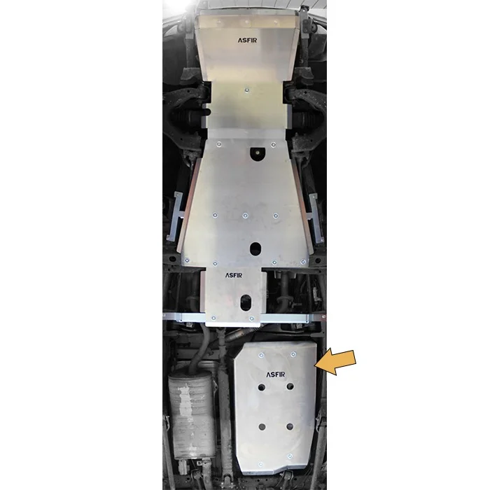

Hey, we just released 1/4'' thick aluminum skid-plate for an LX Fuel Tank available for pre-prudction orders.
* Please note as this is a pre-production sale, lead times will be longer than usual and will be app. 4 weeks (excluding shipping times).
* Don't forget to use MUDDING5 at checkout for an extra 5% off any purchase!
If you have any further question or anything you want to add or comment - feel free to reach out here or send an email to sales4x4@asfir.com

Oh and, @Kabanstva @OffRoadRN - now there's an aftermarket option to protect your Fuel Tank :)

Does this replace the factory steel fuel tank guard, or does it go over it?

That looks great! Does this work for all years LX?
Can't say for sure as we've only test-fitted it for the 04'.
The way we work is we only state a product fits is if we have tested it for a 100% fit.
As the LX's model years cater to the same generation it is highly it would, but unfortunatelly can't guarantee (as of now).
Only for the lx? Can it apply or be tweaked for a lc?
We're going to be test-fitting it for an LC in hopefully a week or so, we'll for sure update afterwards.
With that, as the LX470 and LC100 are the same platform we have a reason to believe it'll fit, but as I sasid to @Kabanstva here - we can't guarantee unless we've tried it (or got a solid feedback from a customer).
