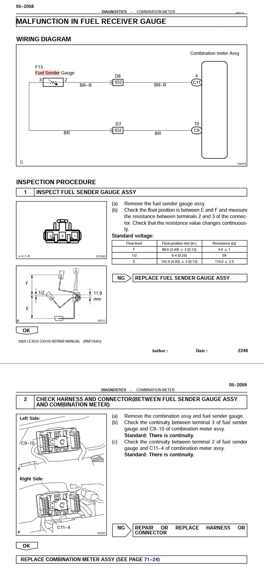

This is from 05 GX470 manual. I think the sending unit are similar on most toyota. For some reason the sending unit resistance is not going up above 59 ohm.
Thanks a million man. Being that I got the new sender unit inside the tank now, I can skip the testing of the sender unit, I will try the other suggested on this manual. Thank you.
I was thinking of buying a salvaged cluster unit just to test the gauge.
