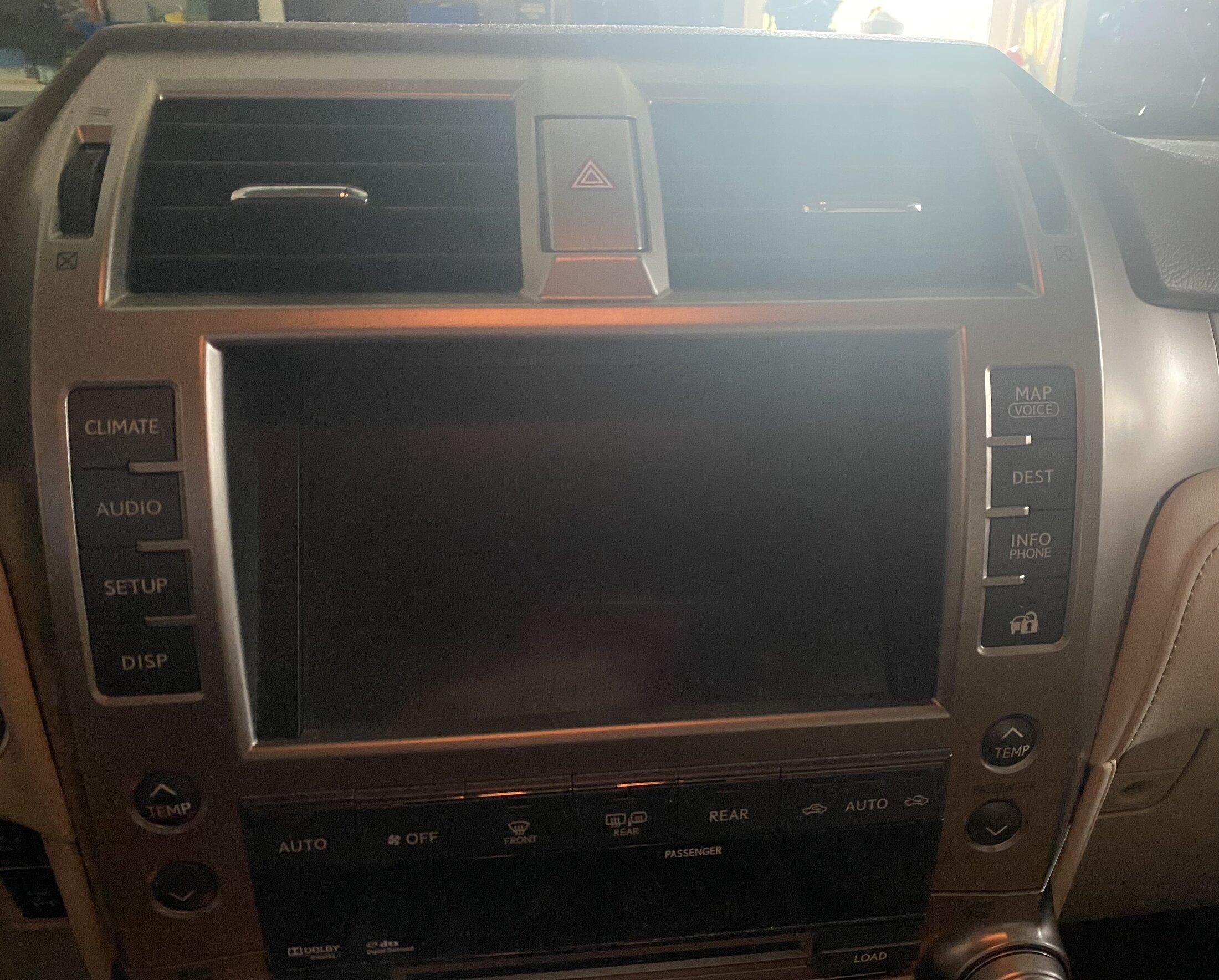

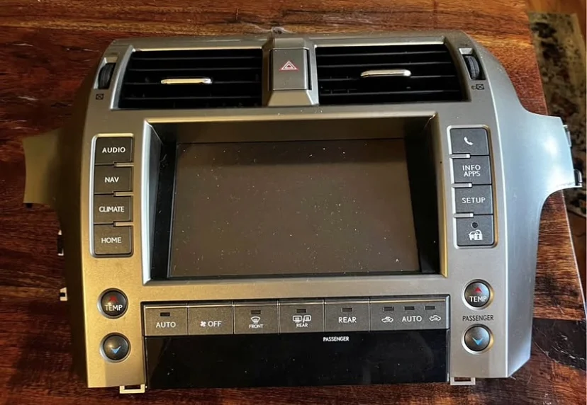

Would a 2016 OEM head unit/screen work in a 2011?
If so, any advantage? Maybe a better screen?
The climate buttons are in the same order, but the buttons on the side of the screen are in a different order. Hmm.
First pic is 2011, 2nd is 2016.
I'll just say "No".. in my over 8 years of ownership I've never seen someone successfully retrofit a '14-'19 head unit in a '10-'13 model
and.. like they say enough time and money possible
It may look the same on the cover but behind the scenes a different unit.
Think of the 3rd party units.. none work universally 10+... there is always a separation of compatibility... wiring harnesses alone aren't the same.
Agree with @Acrad . The programing and wiring are different.
Thanks….I figured that would be the case. Ours works fine, but saw a 2016 unit pop up for cheap.
