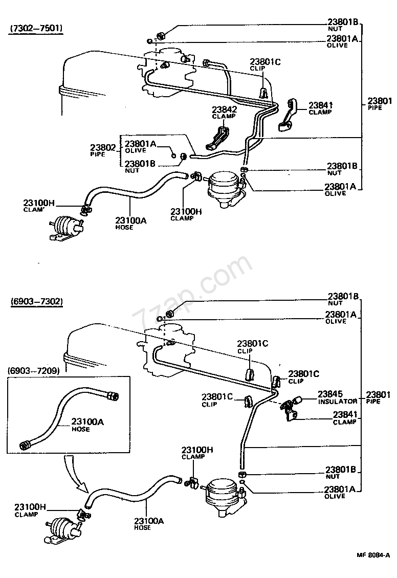

Ignore these first two diagrams, obviously for an FJ40.
This is the diagram you're looking for:

Thanks for the reply about the filter. Super weird right? It didn't seem to make any sense.
I suppose I should get a length of fuel line and just replace that whole line.
