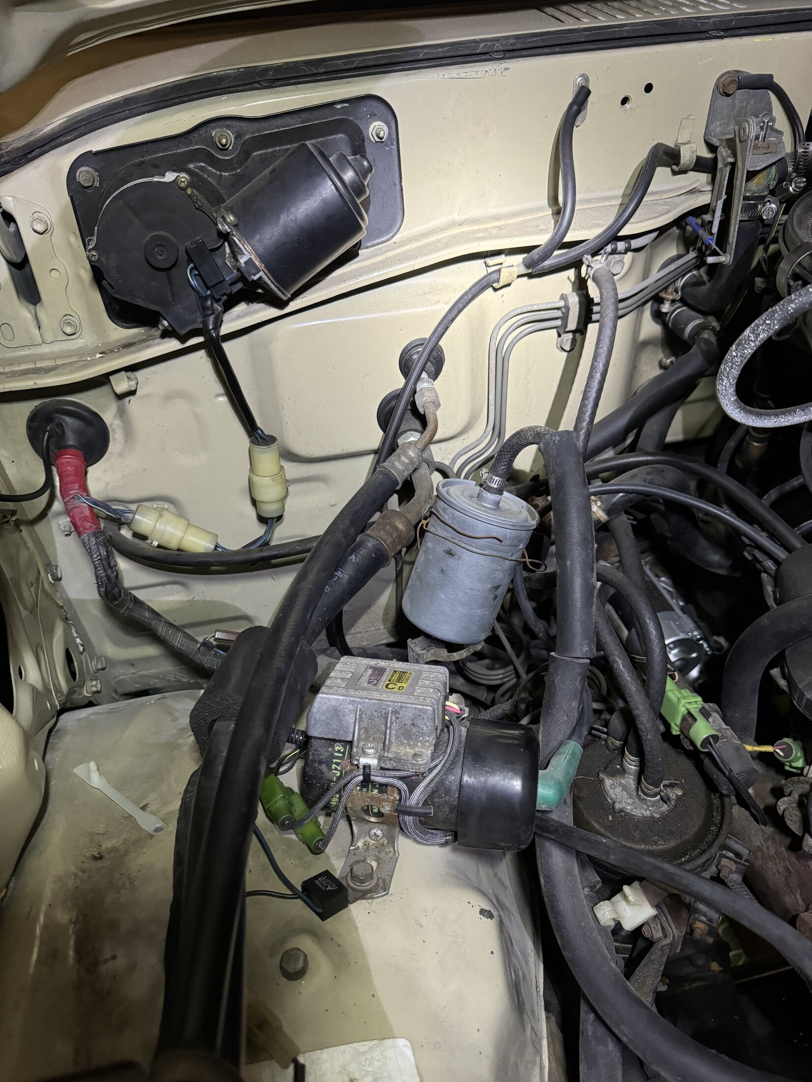

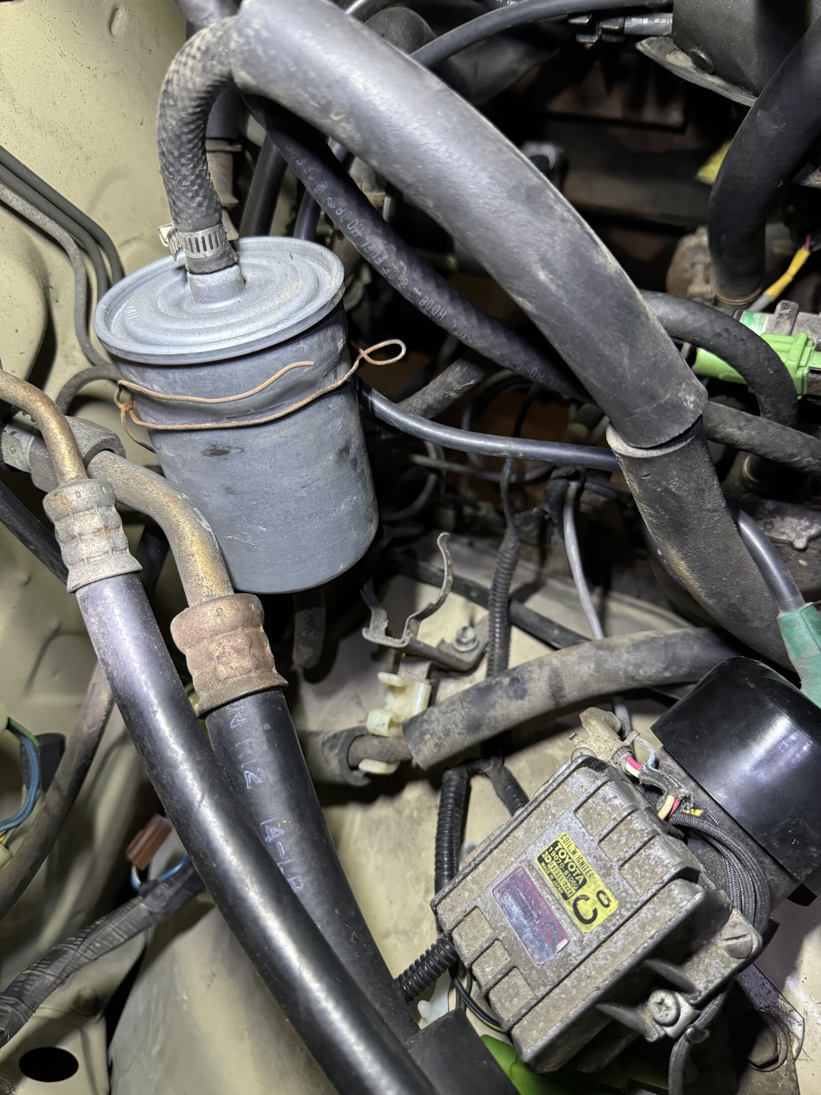

Hi guys,
Been doing some work on the front of my FJ60, have had the front wing and inner apron/arch off so had to remove the ignition coil etc.
I have come to re-fit everything and have a questions regarding the fuel filter...
1. This is a fuel filter right? No part no etc so guessing this is aftermarket...i thought the Toyota ones were a semi-translucent plastic?
2. If this is aftermarket should I just replace with OEM? https://partsouq.com/en/search/all?q=23300-38010 and is it just a straight plug in? Or will it f**k up the vacuum...?
3. If I go OEM, where ideally should this mount to?
Appreciate any advice
directly below the part you have is the fuel filter bracket holder
the stock gas filter is plastic and clips into the bracket.
what you are holding looks like a gas filter, hose in and hose out leading to the pump on the block?
definitely aftermarket

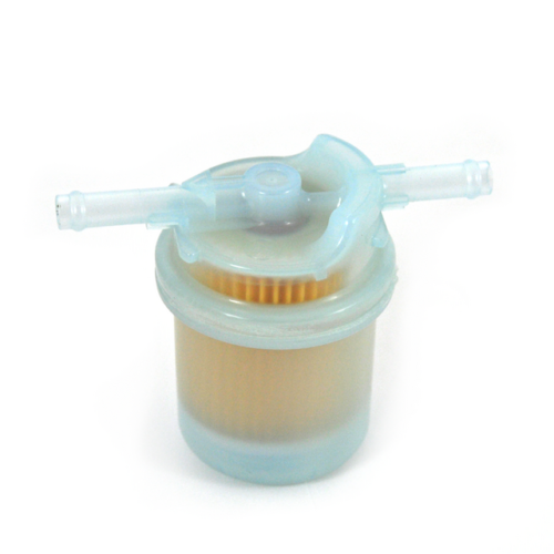

The original Toyota fuel filter for the 2F engine looks like the one in the picture shown here
i designed this mounting bracket / support with 2 primary main factory focus points in mind :
- It uses ONLY the best Darn Late Model Carbureted Fuel Filter OEM TOYOTA KYOSAN ever made for the 1/79-9/87 2F FJ60 translucent to see any debris inside easily ........
- a very versatile and diverse Factory Fit Form & Function use application on ANY Vintage TOYOTA Vehicle Platform Carbureted Engine that uses a M8 / 8mm ID line / hose from the tank suction side to Mechanical Pump's M8 / 8mm suction side .......
note : Included filter is a TOYOTA OEM Part / Bracket is a SEMA-SPEC. Concept Part by Rising Sun Mechanical ,
SNOW VERSION GRADE = HEAVY DUTY TOUGH as NAILS .....
