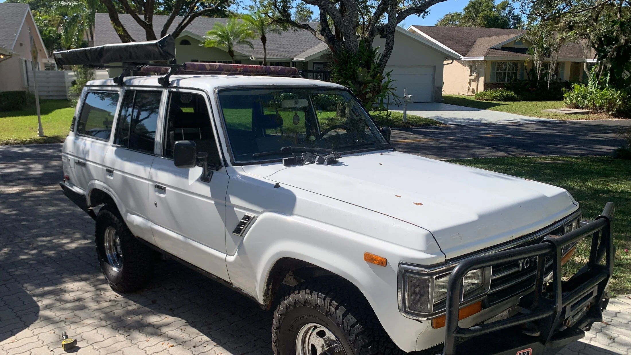

Hey all,
I know there's a lot of information on this issue on the forum but I'm at my whits end. I've owned my FJ62 for two years now and have been trying to get this problem solved since I bought it. Have replaced the charcoal canister, valves, vent hoses and even drilled a vent hole in the gas cap as one person suggested.
Can't fill the tank more than half way because it makes the smell intolerable. I'm hoping someone on here has been able to resolve an issue like mine and is willing to share more information as to what else I may need to look into to finally resolve this problem.
I'm to the point that selling may be an option!
