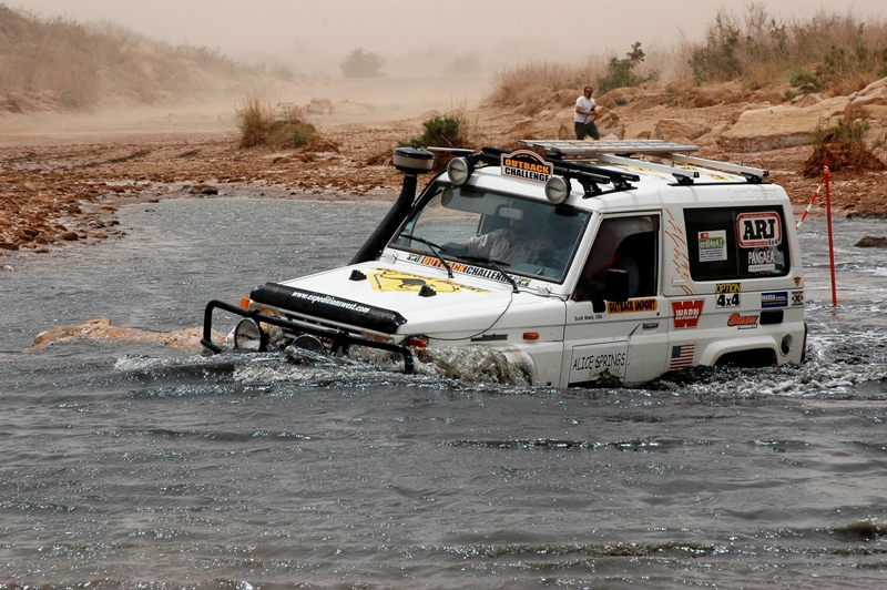

Something like what has been mounted on this PZJ73 also looks like a good low-profile option, I might look into that
The rack by @reevesci has weight distribution foot pads to relieve stress from the drip rails. Check out the pics again. I think that's better than @cruisedan's setup but admittedly I'm not a structural engineer
As far as I am concerned the factory drip rails should be avoided if at all possible. They were never intended to be structural members.
