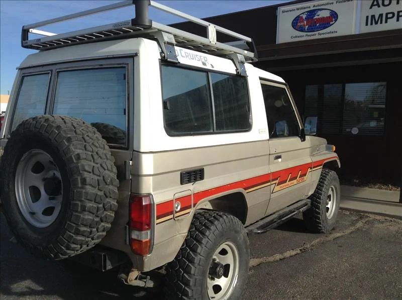

What make of roof rack is on your 74 and how did you fix the mount brackets? More close-up photos would be great. Thanks
The rack is a vintage JDM Aiba Works that I obtained from Mot when I was his guest in Japan in 2010. It is a rail mount design and I used Thule Artificial Rain Gutters on the FRP top. The Thule part number is 542. I did not through-bolt them as designed (it is a two layer top with a void that will collapse the layers if through-bolted). Instead I set 8mm steel nutserts in the roof outer layer. I had to relocate the front rack crossbar about 4 inches to the rear of its original location. I also had to fabricate 1/4 inch spacers to raise the rack up off the mounts to clear the center roof rail. I just barely got it up there before the truck went to the body shop so I do not currently have mount detail shots. I will get some when I visit the project.

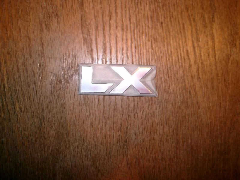

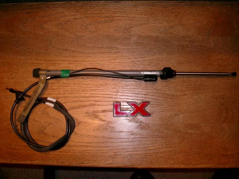

A couple more details. I could not get a replacement RHD antenna. I was able to get a LHD piece which differs on the bottom bracket and the top inner flange. I was able to salvage those pieces from the damaged original antenna and transfer them to the new LHD piece. Essentially turning it inside out. I also refreshed the LX tailgate emblem.

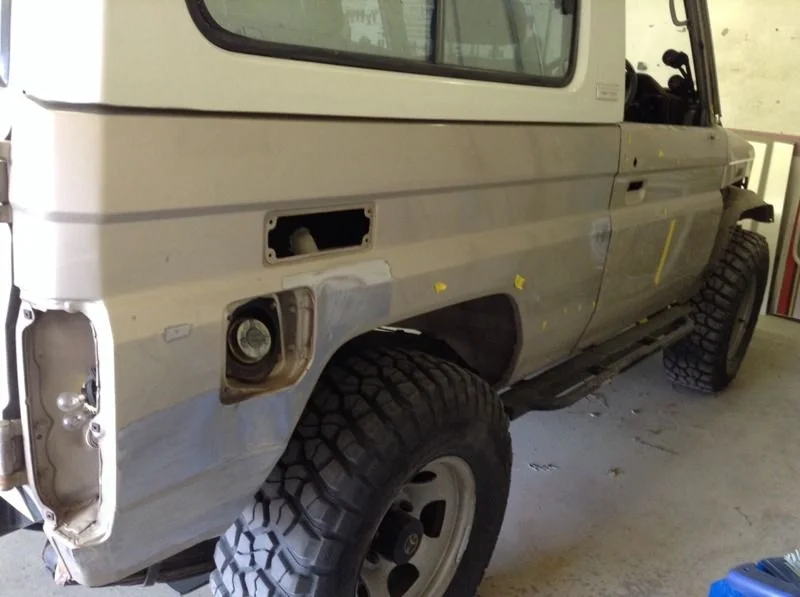

No production pics from today but the left quarter has been repaired, all the dings on the left side are addressed and the holes in the FRP top have been filled.
A few new production pics.

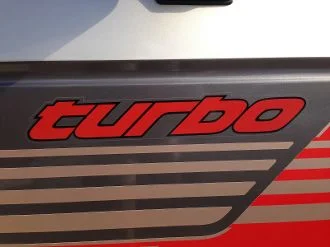

I really like this turbo decal for the doors. Just the "turbo" not all the rest of it. According to Shane's site it is about 16 inches long.

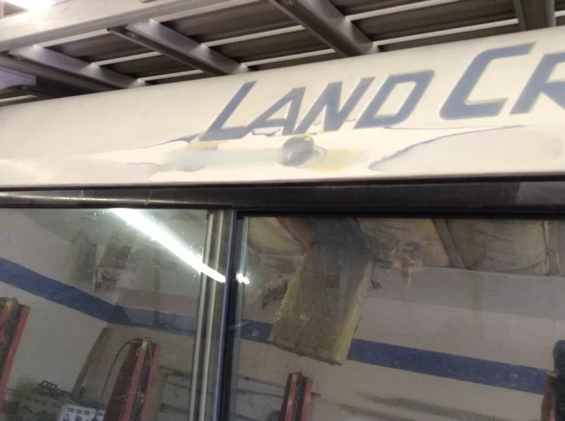

The "Land Cruiser" on the FRP top is actually moulded into the top.
