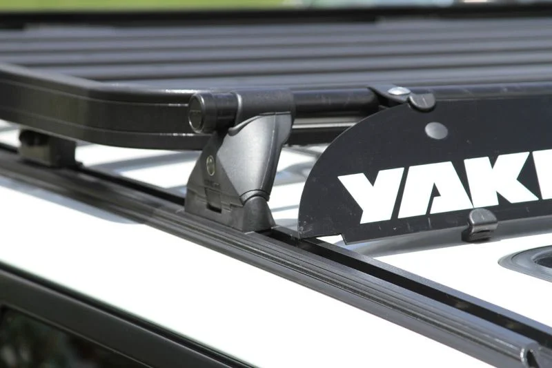

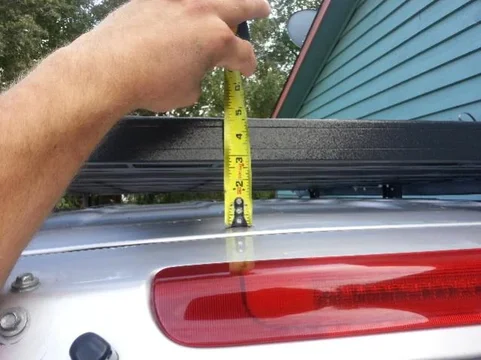

I have a FR rack and didn't know there were two mount sizes - I would assume mine are the short ones. Good that you pointed this out as I was thinking of doing that table thing underneath, but now that I look at it, there is no room.
Unless you plan on purchasing the under-rack sliding table, go short. I really can't think of any other reason to get the tall ones. You'll still be able to get into some parking garages with the shorties. I was loving life until I installed the FR ax mount. No more city parking for me!

The place you should pull your measurement from is just behind the middle row post. If you take from the front or rear its incorrect as your roof curves more.
It's 1-5/8 at the rear of the sunroof and the lowest you can go and still vent the sunroof.
Use the short towers to minimize wind resistance.
Use the tall towers if you're going to put a table underneath.
