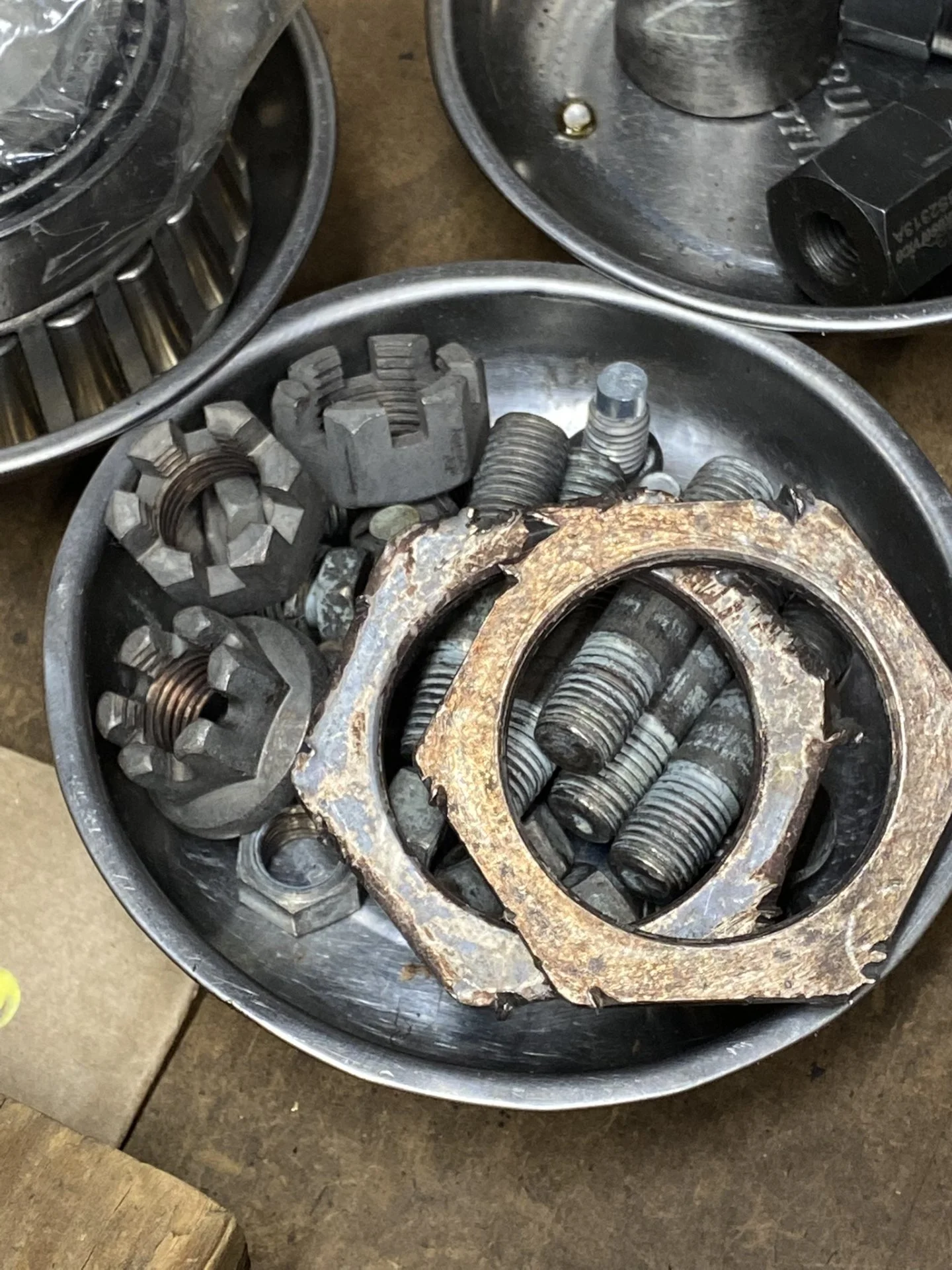

The clue to see if wheel bearings breakaway preload set high enough, is claw washer. If claw washer scored within 30K miles, enough to catch finger nail on. Breakaway preload set to lite (bearings to loose). Loose wheel bearings chatter (vibrate) eat (scoring) claw washer. This result in bearings loosening even more, which chatter even more, which loosens even more and the cycle continues.

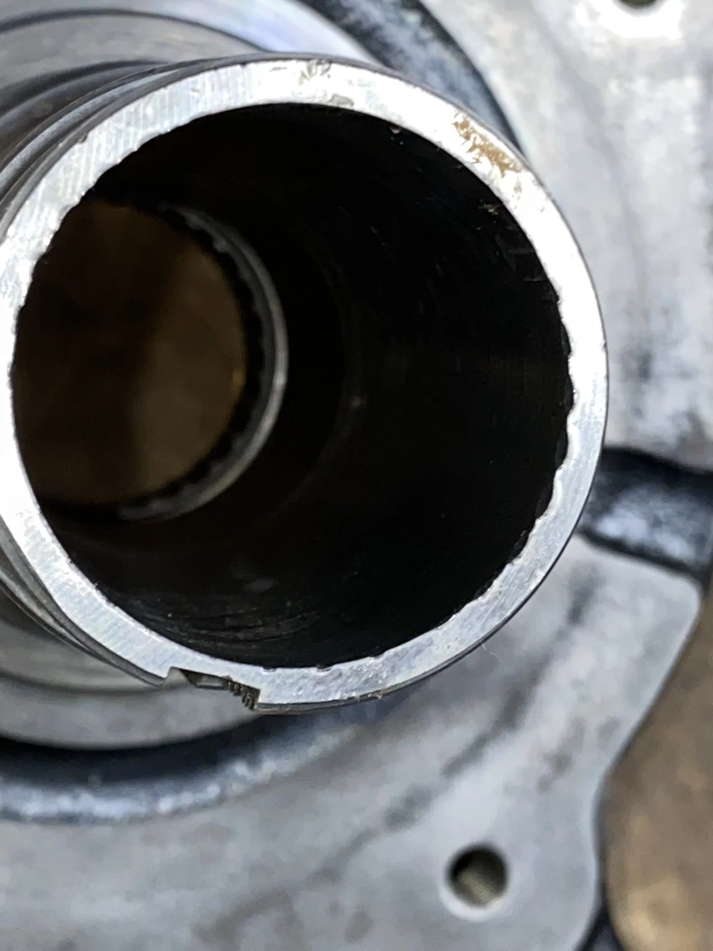

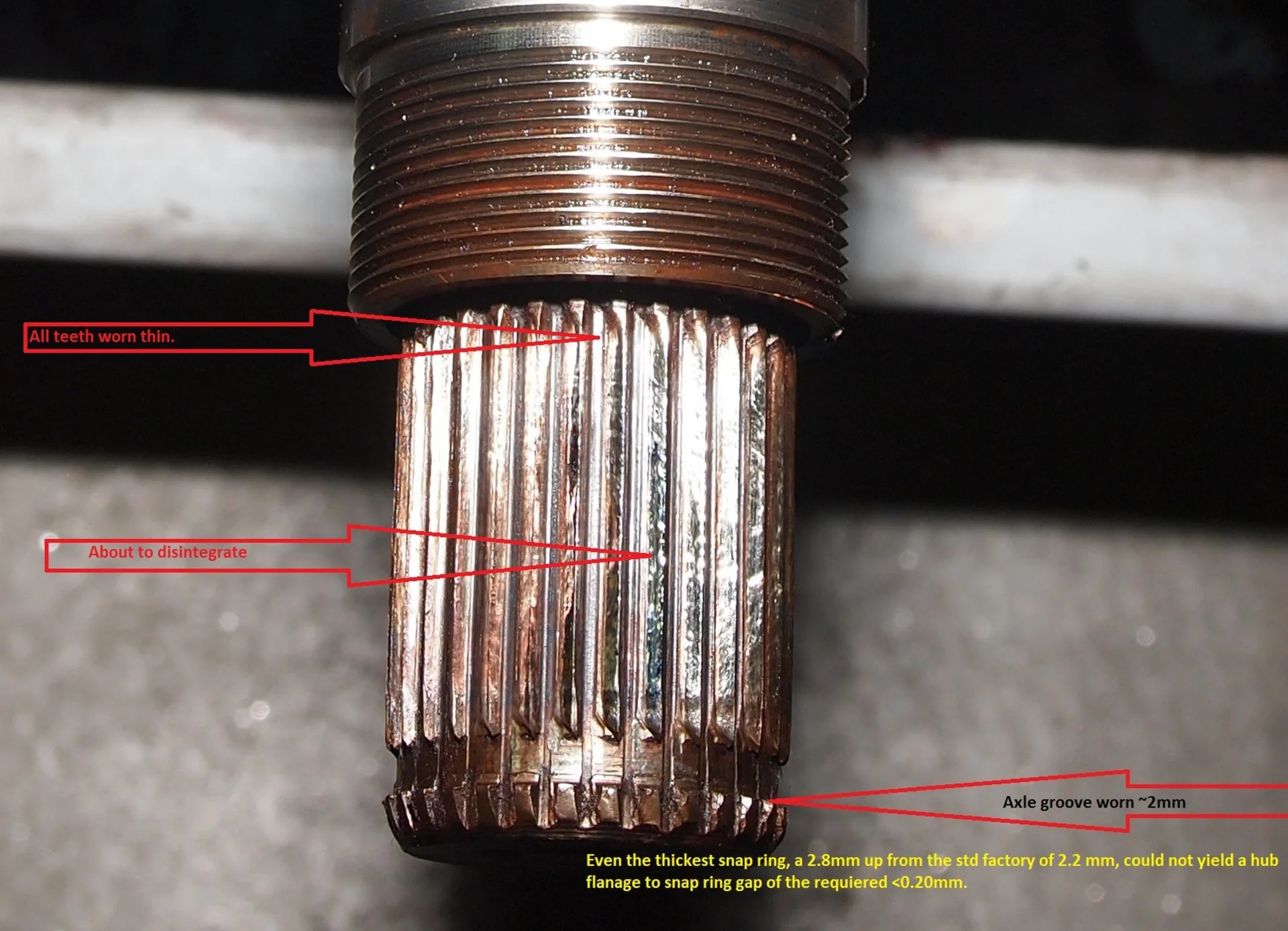

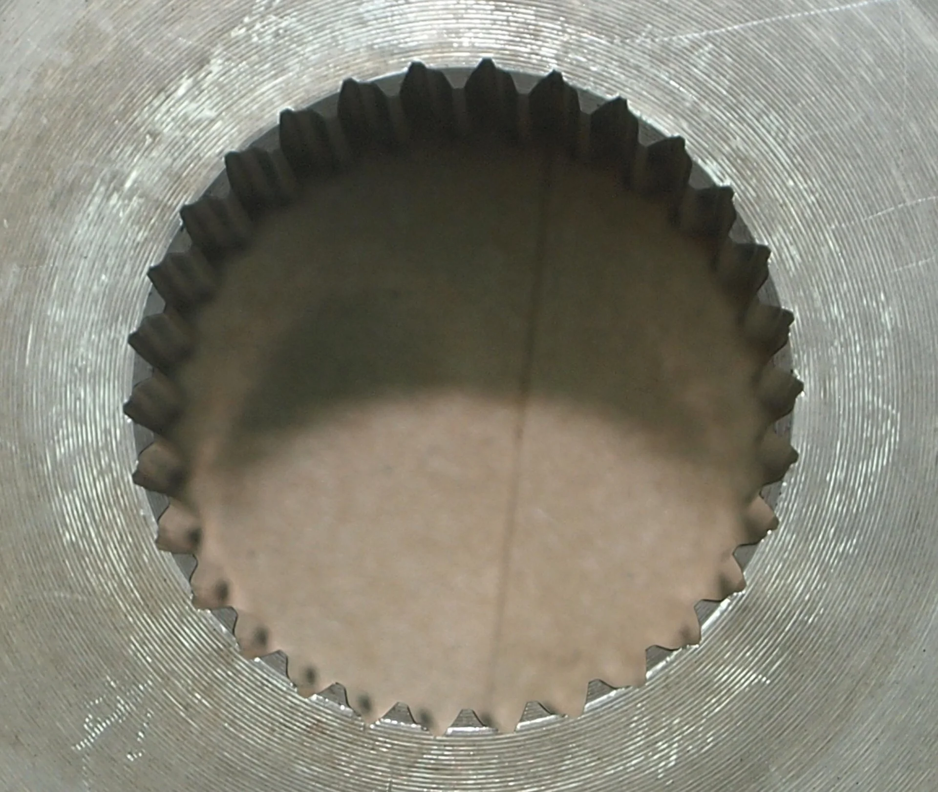

Snap ring, are Not a cause of wheel bearings loosening. But reusing snap ring, they tend to pop off. At minimum they don't seat all the in groove, and can damage axle. If wheel bearing loose and chattering (vibrating). Also snap ring gap greater than .20mm. Axle moves in and out past design limitations. That movement in and out along with chatter (vibration). Turns axle into a power saw. Which will eat hub flange and axle splines. Gets very expensive replace FDS (AKA CV) & hub flanges.
Hub flange splines worn. Due to improper wheel bearing service.

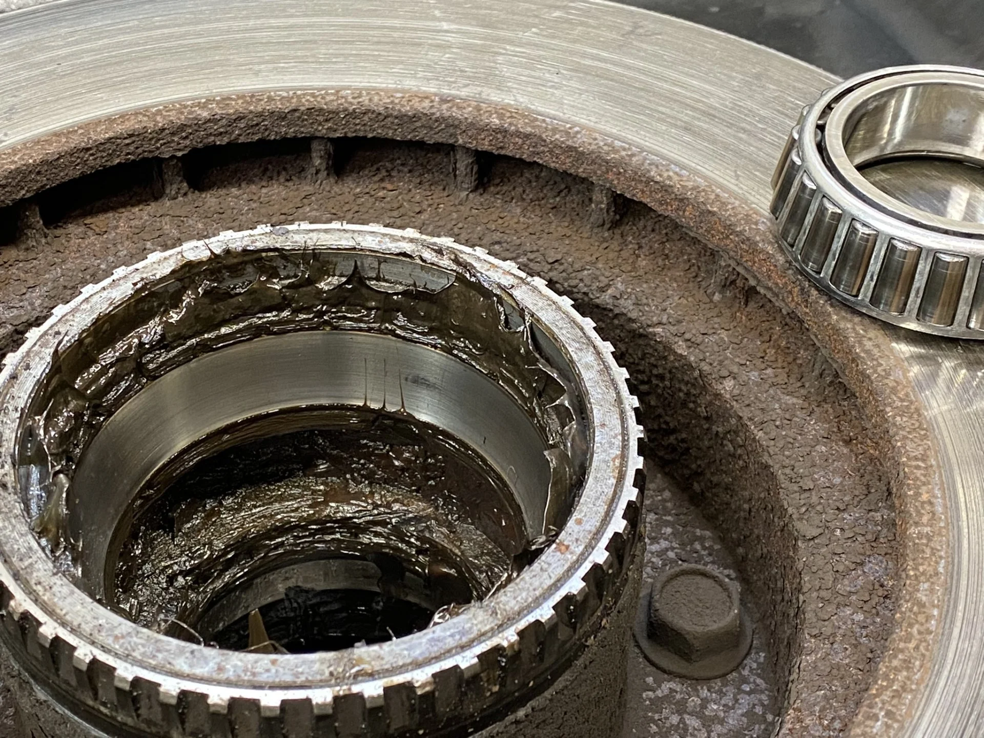

Here's a bad wheel bearing service I'm working on now. To many mistakes to list at the moment. But two biggest issue.
1) Wiped grease from wheel hub cavities an failed to refill with grease.
bearing a bit cooked, from grease spinning out into wheel hub cavity.
54mm Nuts showing high heat discoloration, from lack of grease in bearings.
marks at inner outer tip of spindle, likely snap ring popping off. Which resulted in someone installing after market FDS (CV)
2) Used after market FDS (AKA CV's) busted the junk!!
