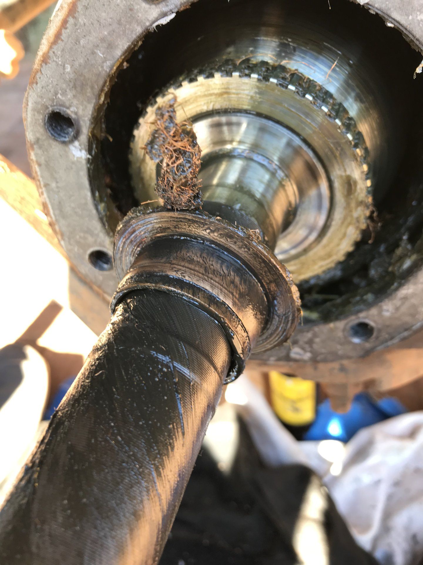

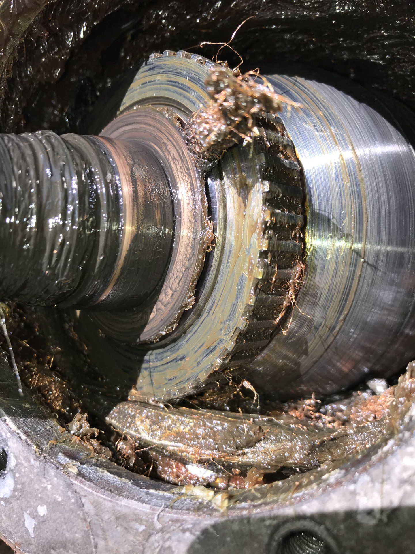

This indicated a front left ABS wheel speed sensor fault. I removed the wheel and then the sensor in question, bolted in from the top of the swivel hub, whereupon I discovered to my surprise that only part of the sensor came out of its housing, basically a short part of the shaft ending in two small aluminium flat-pins with bits of copper wire hanging off the ends (the inner remains of the sensor)! Shining a light into the swivel-hub through the sensor hole I could clearly see strands of thin copper wire (from the innards of the sensor) coating the greasy pulse-ring on the inside of the swivel hub, the remainder of the sensor (smashed?) surely laying somewhere at the bottom of the steering swivel hub or liberally distributed throughout the workings of the cv joint inside!?
Does anyone have any idea how this might have happened? I looks like, from the base of the sensor, the the lower part of it (the shaft which projects down to almost make contact with the pulse-ring and receive the pulses from it) was "sheared off" about 1/2" near the top, closest to the sealing o-ring. Almost as if strong wheel articulation caused the outer axle-hub assembly and it's pulse ring to "flex" and touch the end of the sensor, abruptly tearing it off? But, that shouldn't happen?
