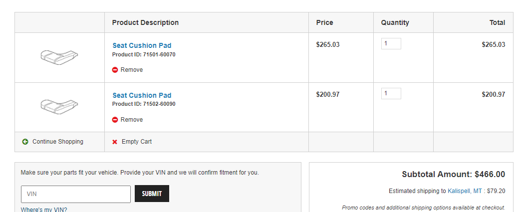

Copy that, just for future on lookers. Part numbers below for bottom seat cushions and yes they differ from both sides. I think it's time to break the piggy bank and invest in some comfort points.
Seat bottom Passenger
1998-2006 Toyota Land Cruiser Seat Cushion Pad 71501-60070 | Toyota Parts - https://toyotaparts.mcgeorgetoyota.com/oem-parts/toyota-seat-cushion-pad-7150160070
Seat Bottom Driver
1998-2007 Toyota Land Cruiser Seat Cushion Pad 71502-60090 | Toyota Parts - https://toyotaparts.mcgeorgetoyota.com/oem-parts/toyota-seat-cushion-pad-7150260090
Interesting, different part number but only shows compatibility for 98-02..... I have a 2002.
The part numbers I shared were provided by mcgeorge Toyota based on my vin. I wonder what the difference is
