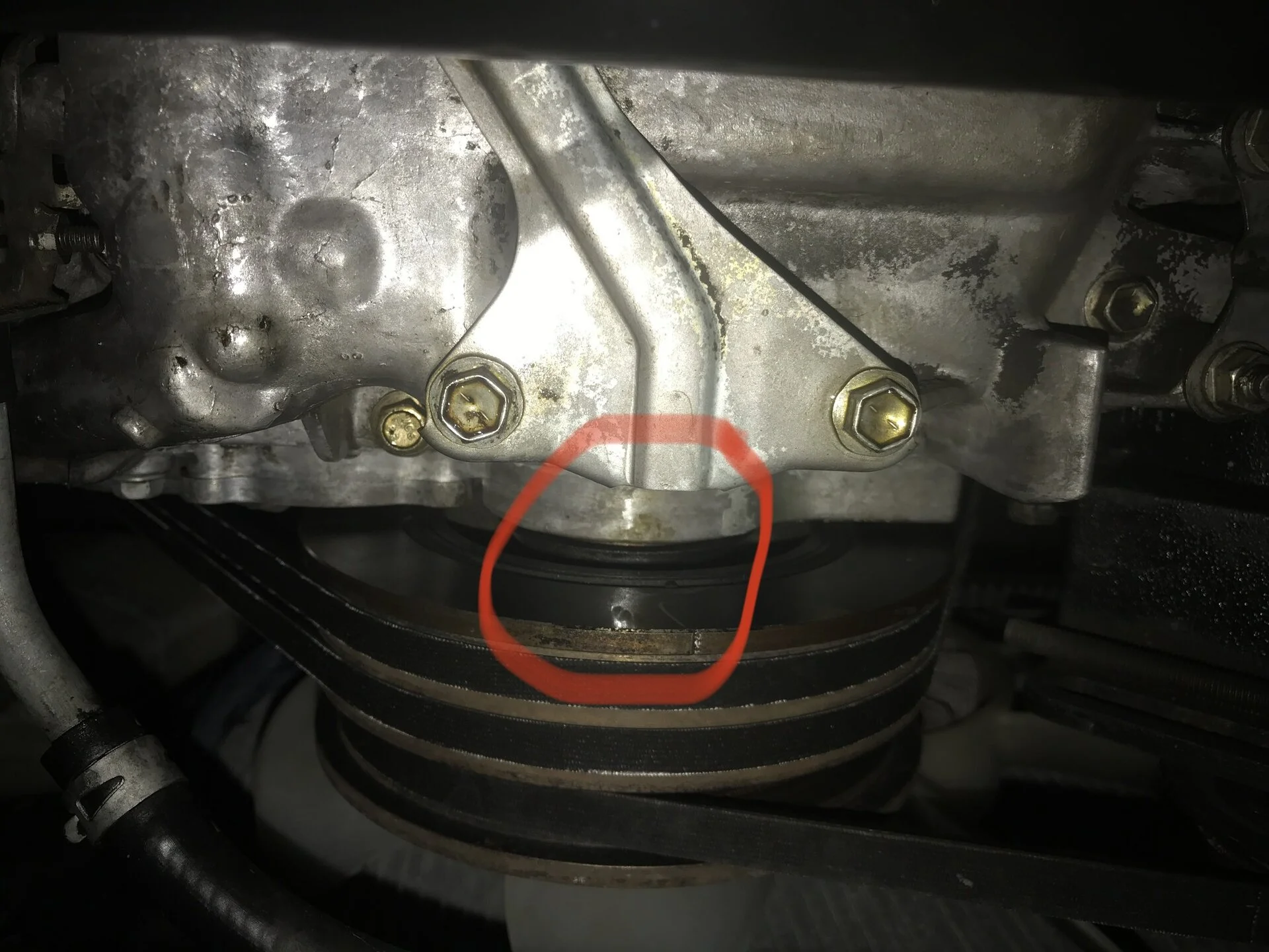

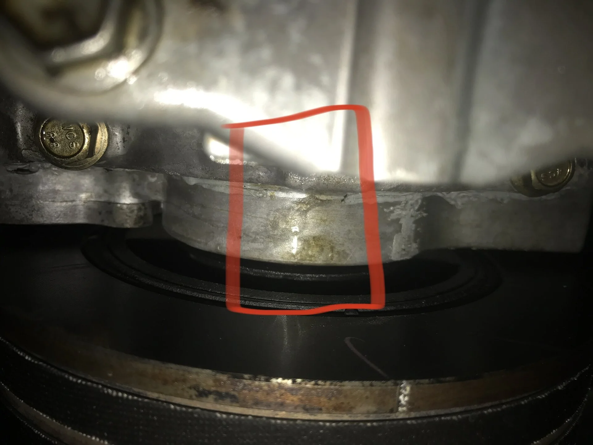

Hello guys, took the cruiser (fzj105) to a mechanic to get an oil leak rectified, mechanic says he can’t see an oil leak. Well, I can see an oil leak. So I’m wondering if you knowledgeable cruiser owners can confirm or help me diagnosing if the leak is coming from the crankshaft seal or as others call it the front main seal. I’ve taken some photos laying on my back from underneath. Cheers in advance.
I understand the photos are really hard to see oil as I had to use the camera flash and the oil is also very new as I just had a bunch of work done including an oil change and the ‘front main seal’ was supposed to have been replaced when the work was carried out. The oil appears to run from where I have outlined in red and accumulates on the crank position sensor and surrounding bracket. There is no other visible oil leaks aside from this one and it seems to only leak amounts when I’m highway driving not so much town driving. According to the dipstick I’ve also lost a little amount of oil. I know this may seem like something small but I’m just pissed off it’s leaking at all as I’ve spent thousands recently getting it all leak free and back to spec.

Whether it's from the oil pump cover or the front crank seal, you (the mechanic) should replace both at the same time as the crank pulley has to come off for both/either.
But because you just had the front main seal replaced that seal may not have been installed correctly OR the mechanic ignored/missed the actual source of the leak which could be the oil pump cover O-ring (gasket) as mentioned above in post #2.
We've seen this happen when someone who's not familiar with the 1FZFE engine assume that the leak is all from the front crank seal and they don't look to their right when they're replacing the crank seal.

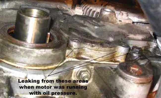

I robbed this photo from the link above: it's looking up from below at the front of the engine with the crank pulley (harmonic balancer) removed.
You can see the nose of the crank sticking out with the front crank seal in place. To the right is the oil pump cover attached to the timing chain cover by seven cross-head JIS screws (Japanese Phillips type screws). The O-ring behind that cover (plate) is often the main source of the leak.
Note there is also the upper oil pan that is sealed to the bottom of the timing chain cover also, another possible source. Need to trace the leak to be sure.

Even if its the oil pump cover the HB has to come off to change that so might as well change the front seal too.

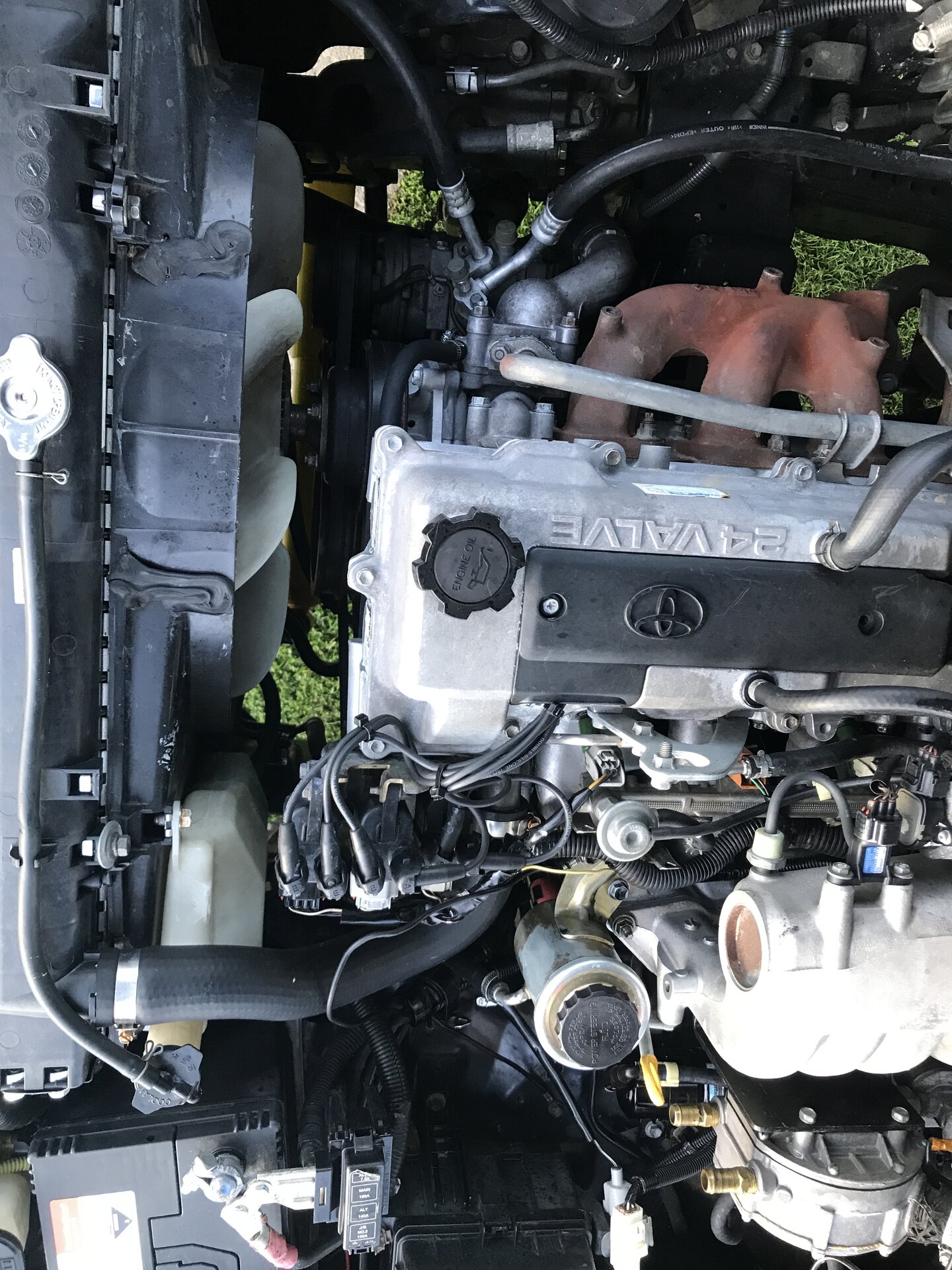

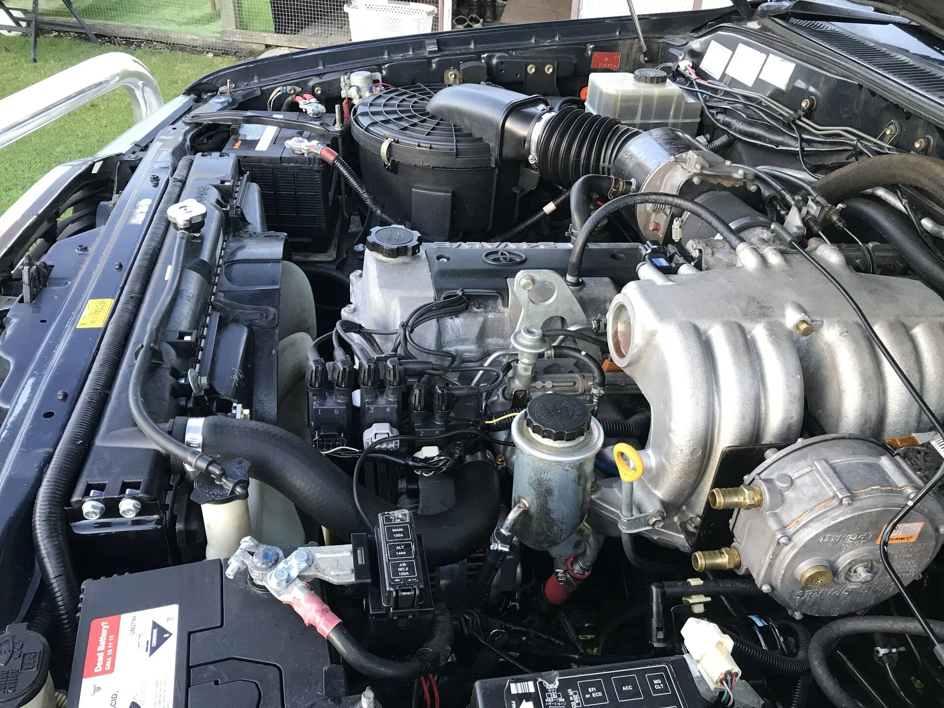

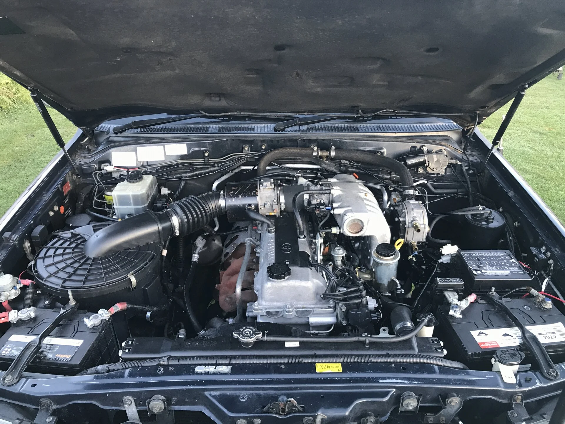

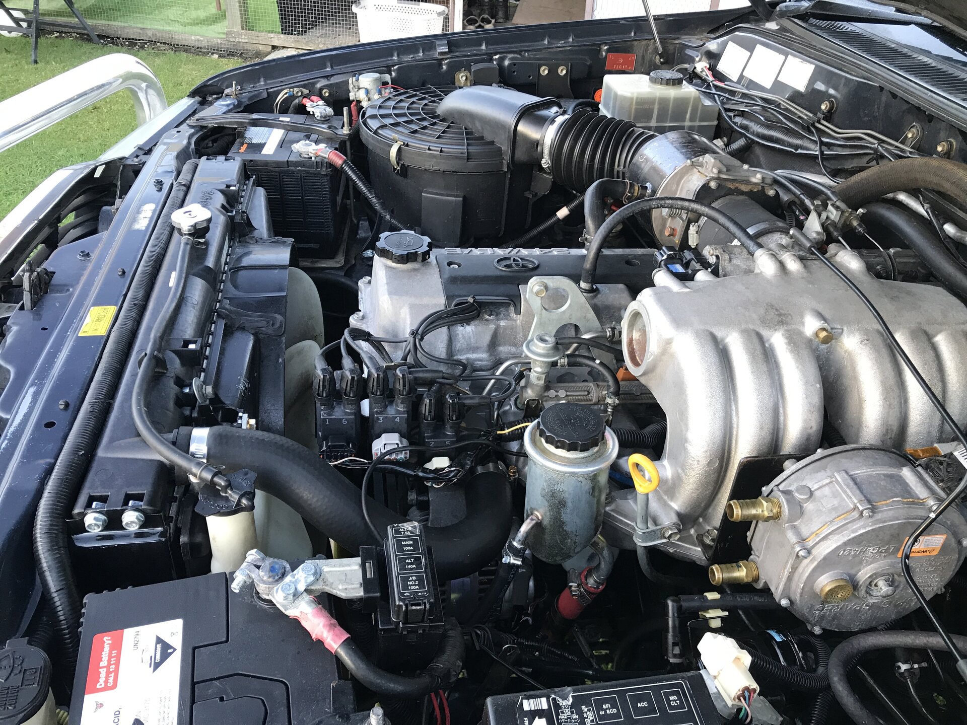

Post up a few more photos, one showing the top of the engine, wide shot, from a few feet back. Include photos of any areas that had to be resealed
(list them also).
I thought I had a front main seal leak as well. Degreased. Drove around. Turned out to be the oil pump cover gasket.
The last pic leaves me doubtful they ever had the oil pump apart. If they did, they did a shìtty job of cleaning the housing, and around the housing before putting it back.
I'd suspect the oil pump seal.
Good news is, you have distributor-less ignition. So no distributor oring to leak.
Another possible leak is the oring seal on the power steering pump, in the back side of the oil pump/ timing case.
Another minor criticism of work done, worm drive hose clamps have been used in several visible hoses.
Personally not a fan. OEM spring clamps are a better option. Worm drive clamps can pinch the ends of the hose and cause them to weep. Something to keep an eye on.
the screw heads look almost stripped out so it might have been off in the past
Or they gave up lol
Yeah I thought the same.
Either they gave up, or didn't clean the housing.
Both are a red flag.
