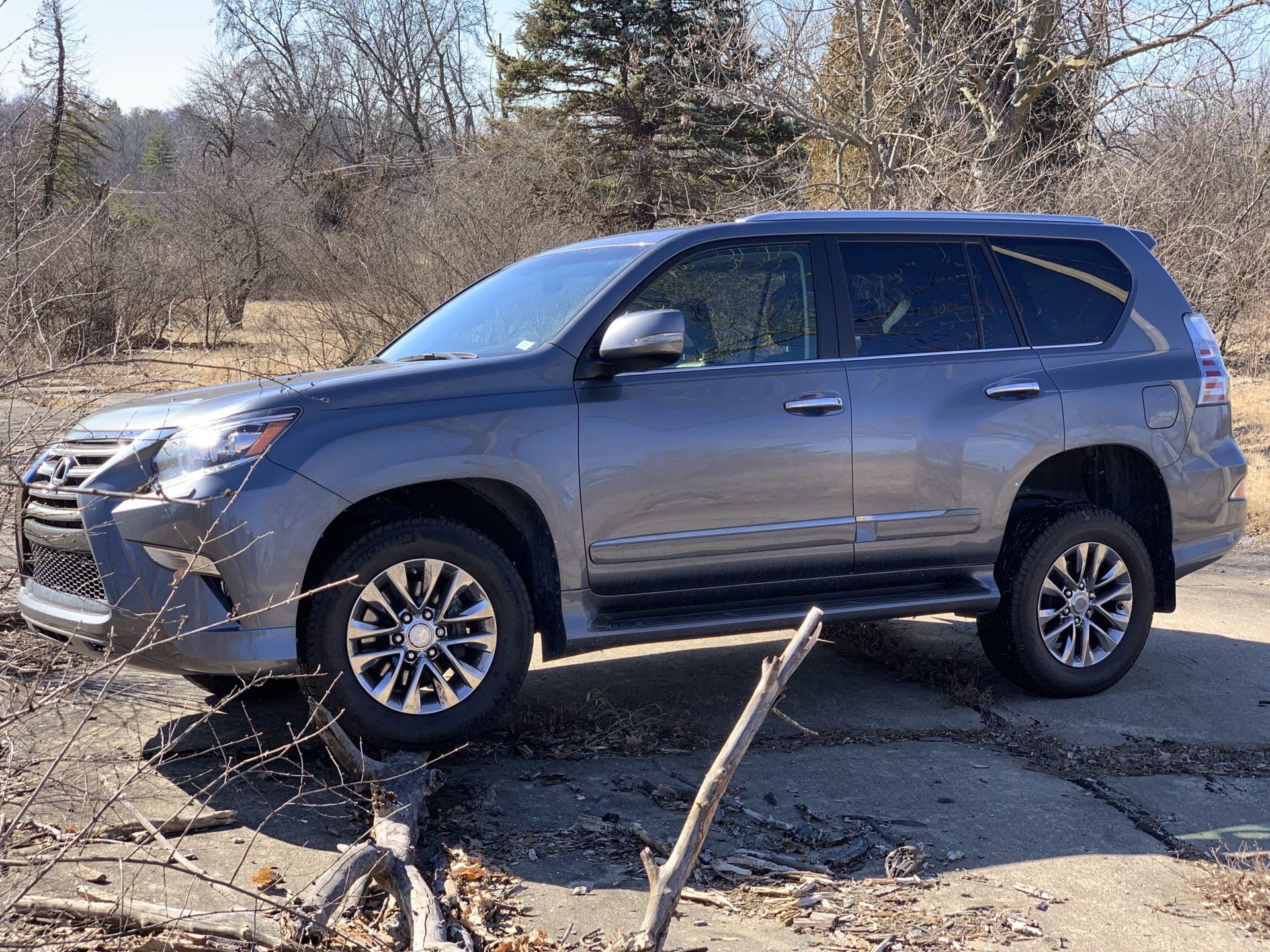

Anyone happen to know if the lower middle lip comes out? It looks like a separate piece but I haven't had a chance to get under it yet
Looking for a bit more room to possibly place the ARB recovery points.
Btw, here's my new to me TLC150
1911325
1911330
Yes, it does I took mine out. You do have to re attache the lower plastic spoiler to the aluminum front bumper. Or leave it off all together. You will see what I am talking about it when you look under.
Very nice.
