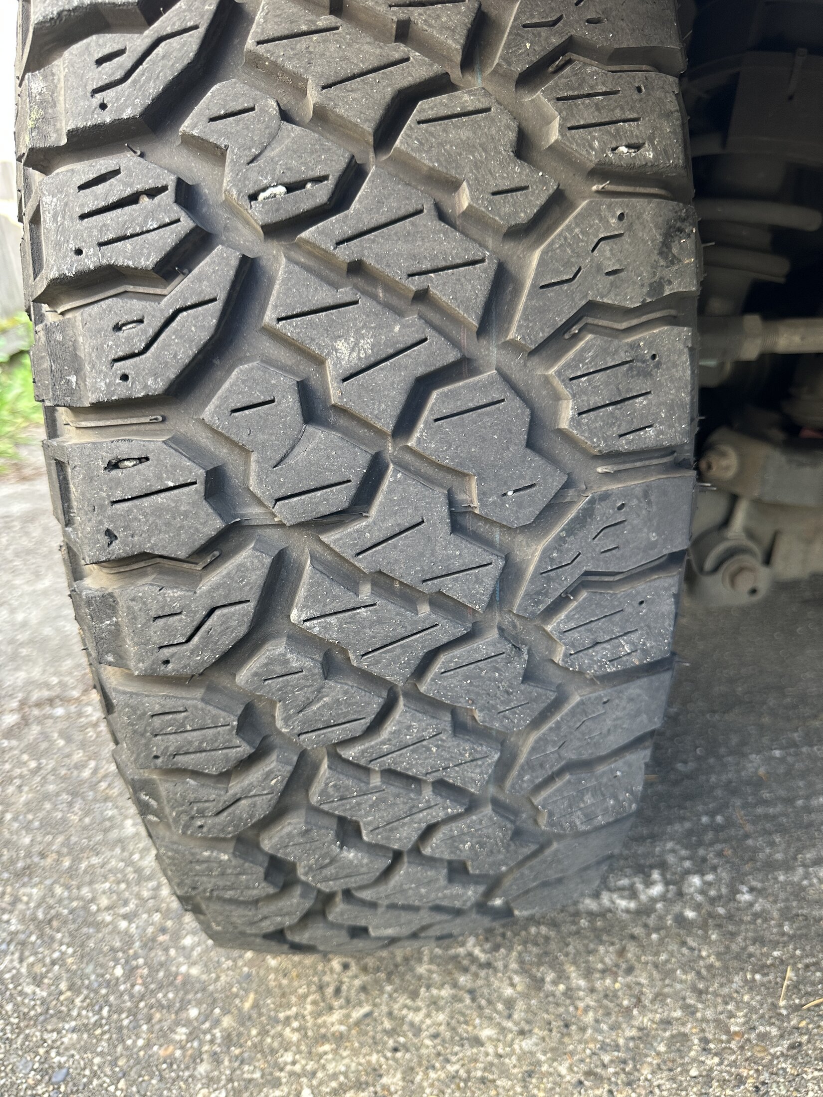

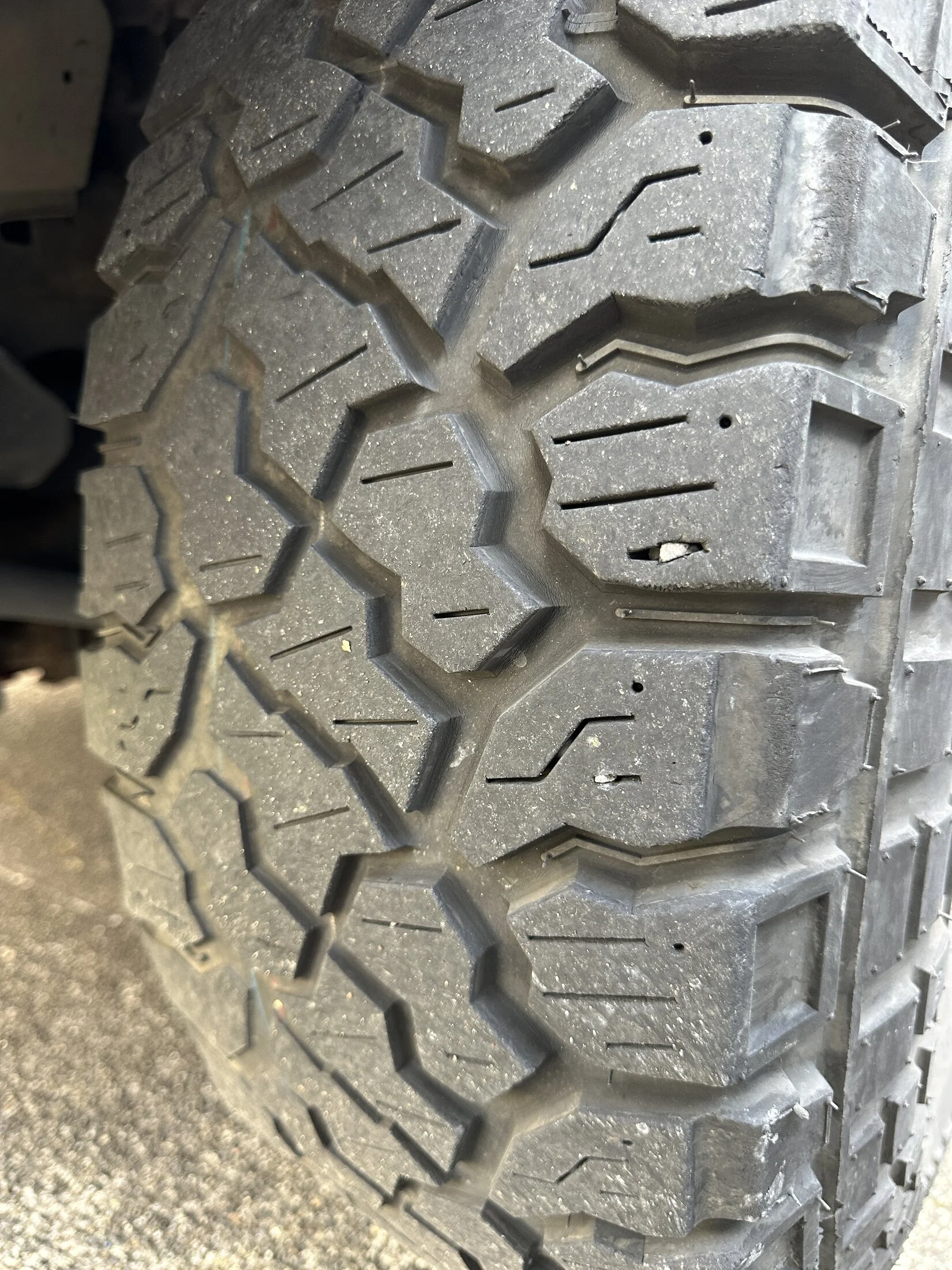

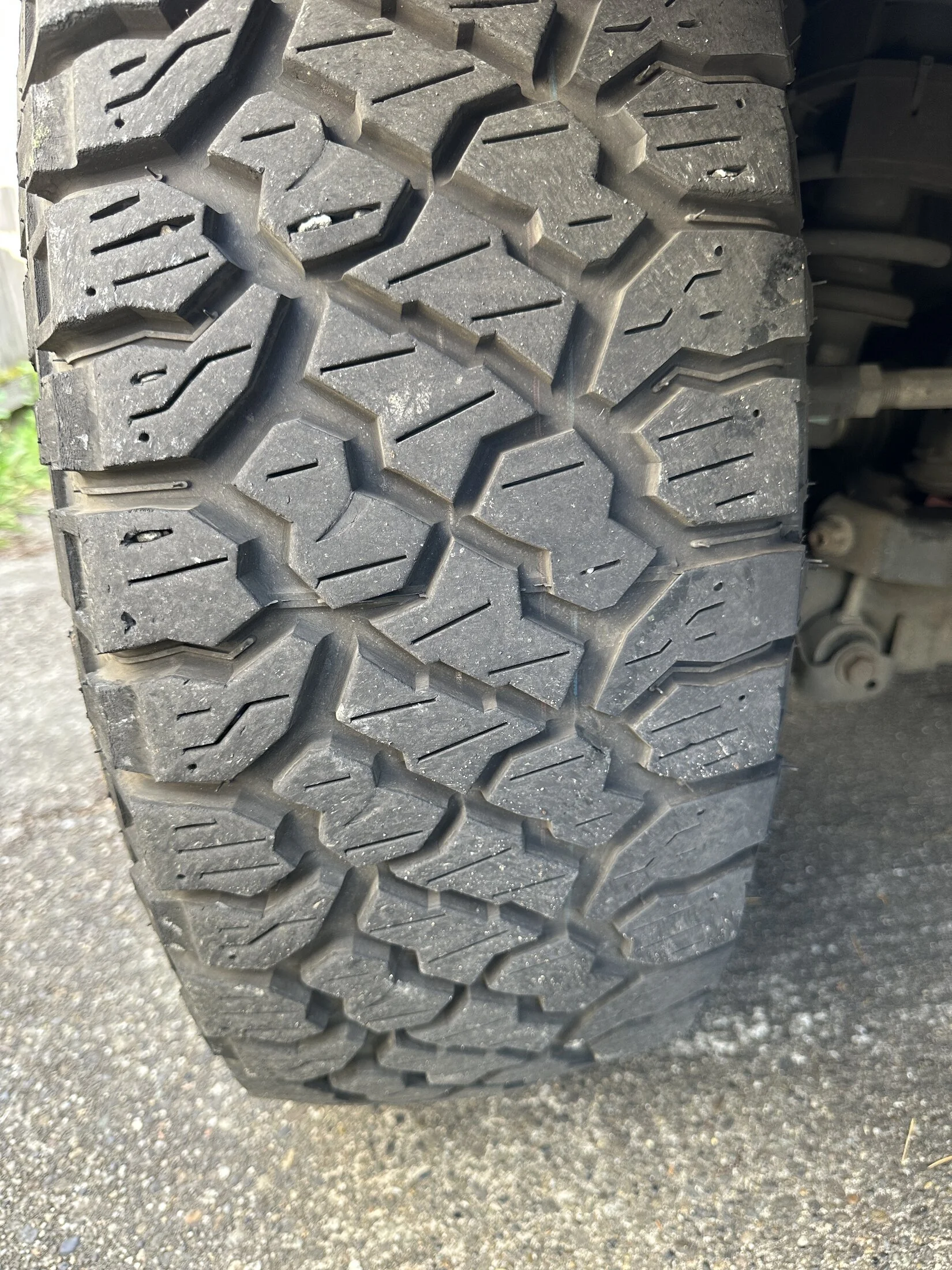

Pics of the right / passenger side

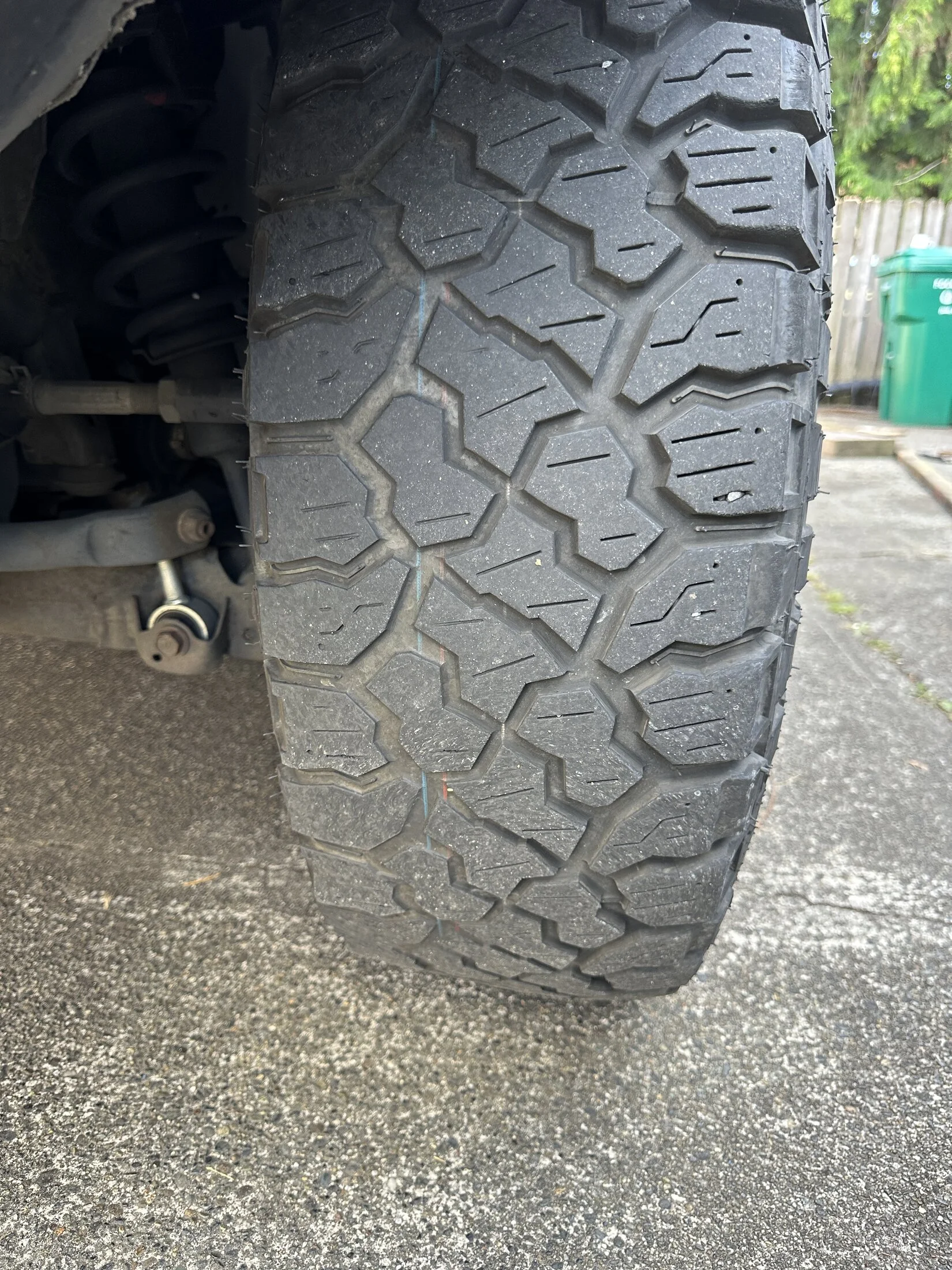

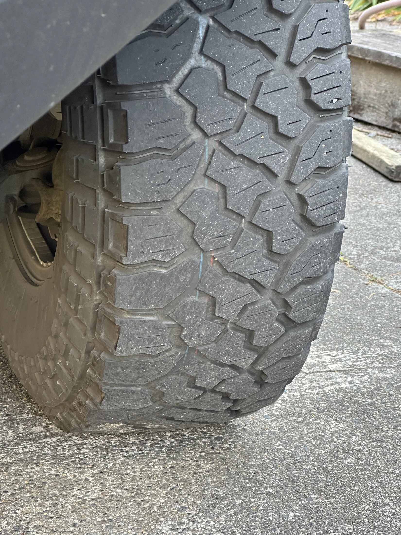

Left / driver side
Left from a distance

Perhaps a few things at play.
Primarily, it looks like you have a bit too much toe out on the front axle.
With 260k miles on the suspension, the front suspension, especially the LCAs, may need some attention as the bushings are probably well worn and allowing some degree of slop.
You should have your toe set to 0 to a little bit positive but a few tenths at most. I don’t know what the ideal camber would be on these rigs, but my guess is up to -.5 would be pretty good for pretty even tire wear. Caster looks good to me. Your toe out and negative camber on the left side is likely the cause of the inside of the tires to be wearing unevenly.
Chris
So toe and camber out on the left side is causing similar tire wear on left and right?
Most likely for the car to drive straight, your steering wheel is correcting for it causing both sides to have toe out. The negative camber on the drivers side just makes it a tad worse on the drivers side.
Chris
Toe in and Negative camber will both do that. could be either or both..
I'd align it with a shop that can do it to factory specs with your lift.
I tend to get mine aligned at least yearly, since well, Rocks do stuff to the alignment :)
