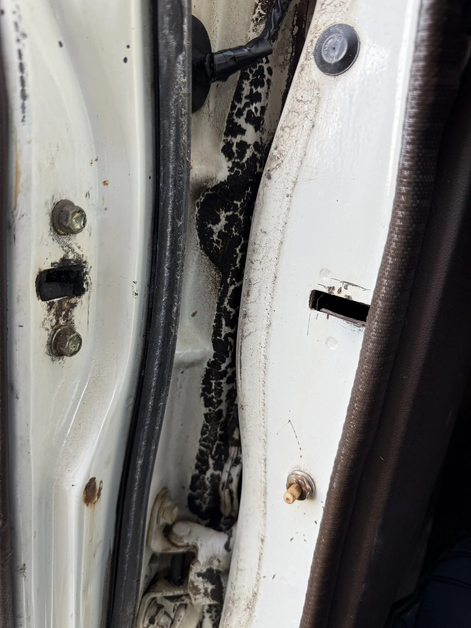

Please help me guys, I'm losing my mind here, lol.
I'm trying to restore door limiter on the driver side (front). From the manual, i can see how to install door limiter inside the doors - i got this, but where i can buy little bracket which goes into the main cabin and how do you even install that?
Picture of my front driver side door as it is now. Limiter is gone and bracket on the right side, to hook up limiter is gone as well...
I don't think there is supposed to be a slot cut in the door jamb as the limiter goes into the door not into the cabin.
the bracket is just a small "U" shaped bit that a pin goes thru
the bracket would be the same for all 4 doors, along with the limiters and pins
Look at your passenger door - its just a left hand swing versus right hand swing. Same hardware. The 'tab' that comes thru the slot in the jam is part of a t-shaped piece that was spot welded - hence the two 'dimples' you can see above and below. Anyone with a part out should be able to supply the entire assembly.
