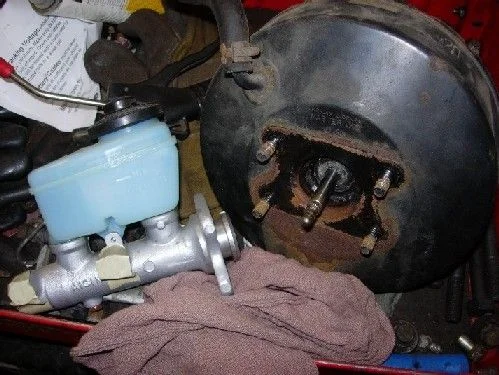

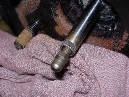

Is this piece similar to what you are having troubles with adjusting?
This is a 1987 booster that I had at the shop, with a disc brake master cylinder from JTO...
View attachment 55710View attachment 55711
Hi Poser
I have this exact set up. Although I have adjusted the push rod in as far as it will go and I still have a half inch between booster and master when push rod makes contact with master. Any Ideas? I have stock booster.
