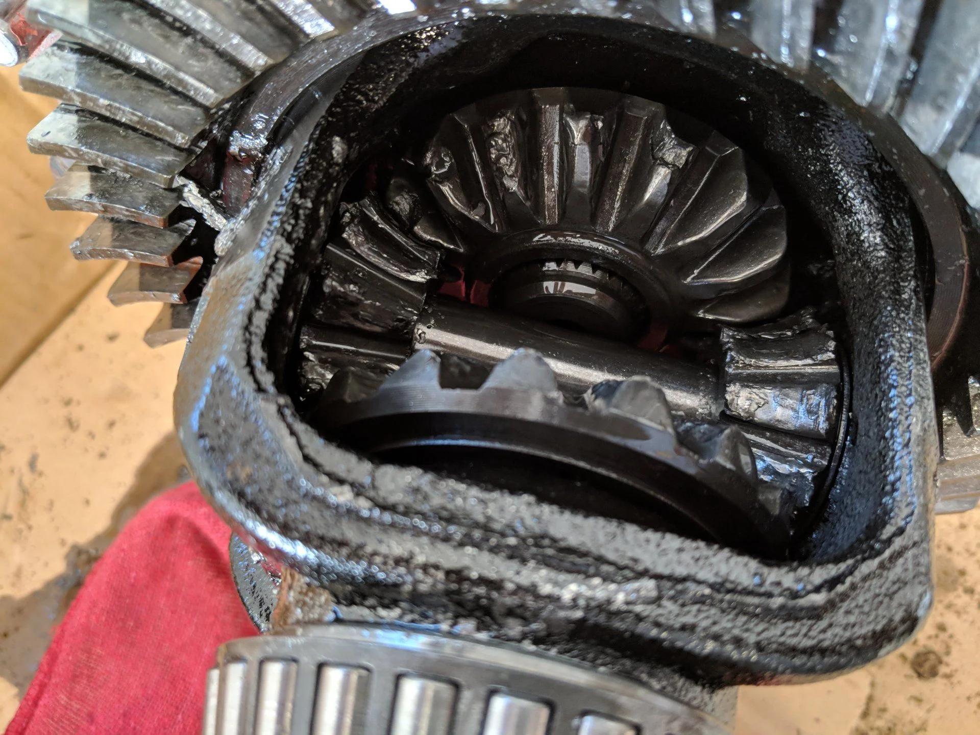

Hey Peoples! My last wheeling excursion, I heard and felt popping in the 3rd Gen 4Runners front drive train. Grant and Steve felt it was likely a CV Axle failure, the offending sounds went away in 2 Hi. Drive home from Farmington with only an occasional growl/hum from the drivetrain.
Both CV shafts are ok, drained the front diff and found metal. LOTS. Removing the front 3rd member of the 4R stinks and was easily the worst wrenching job I've ever done. I cracked open the diff and found this.
The ring and drive pinion look ok. I'd assume all bearings are trashed from metal consumption. Any idea what the initial failure would be to cause that damage to pinions and side gears?
What's the next step? At this point, me rebuilding is out, over my head. Junkyard? Don't want to spend an entire day at Youpull. Anyone have a 4.10 IFS front diff laying around?

ARB was a reasonable suggestion. Just an expensive one. I know you don't like the boneyard idea, but I think it's probably your best, and cheapest, bet. A less expensive idea might be something like a Detroit TrueTrac.
ARB
ARB RD132 Air Locking Differential https://www.amazon.com/dp/B004P9DDR4/ref=cm_sw_r_cp_api_9xuKBb14BJT70
Other wise pull one from UPull and swap it in. I always considered a front ARB as the final piece for that truck to finish it

ARB is a $1500 solution to a $200 problem, for the expected use of that rig.
Chris if you intend to wheel it seriously like Gordy's, then yes the ARB is worth the investment. So would a solid axle or long arm kit.
If you don't see it going to hard trails, then I say stuff a junk yard diff in and go wheeling

So, after many fits and starts, the 4R is back on the road. Donor was a '98 4R with 167k on the clock. Pleased that it's done, not pleased that I put it off so long.... camping, vacation, ham radio, work and life gets in the way!

The weak spider gears in the 7.5 front diff are a common failure point. Also, I'm with you on the front diff R&R job being a big PITA. I have ARB RD90s in mine to (hopefully) save myself that hassle in the future.
Beefing up the diff just shifts the failure point(s)... aside from increased CV breakage with the front locker, the ADD stub shaft becomes an issue. On the 7.5 diffs the DS CV will not seat as easily or as deep as it normally does with an RD90 installed. I have snapped off a CV at the diff, I believe due to the increased protrusion, which was fun. There are pros and cons to running the RD90 on these rigs.
