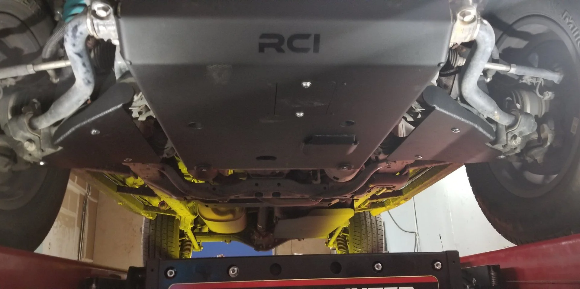

Kinda surprised there isn't better protection for CV boots even with A-Arm protectors that are available. I have full skids and A-Arm protectors on my ATVs as I have gotten torn boots with sticks in the past. Not a fun task rebuilding those. I notice not much forward coverage on current offerings.
Based off what I've read the RCI skids for the 4-runner work for the front LCA's, in fact, RCI has appeared to have assembled a full (or close to it) skid set based on what I'm seeing on their website. its a mix of a few models.
10-16 4Runner A-Arm Skids
GX 470 (actually 460 specific page)
Granted, the purpose of the skids is to protect the LCAs from damage, but they will also prevent branches, etc. protruding up through the middle of the arm. Limited solution to a limited problem.
