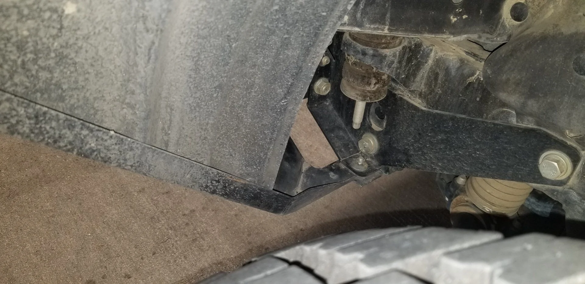

r2m, FYI the lower shrouds on the ARB bumper that shield the suspension components are a thin gauge sheetmetal as you described, and they are relatively light. Below is a shot looking forward from the top of the passenger tire. Aluminum would probably save a few pounds, but not much. All of the bar weight is on the main part of the bar and hoops.
My Ironman 4x4 bull bar is same design as the ARB. This Aussie utilitarian design and weld built bumper had protected my rig from rocks off road and other vehicles on road. Great approach angle plus extra panel on bottom connected to RCI skid plates protected the suspension components also.
  • My Ironman 4x4 bull bar is same design as the ARB. This Aussie utilitarian design and weld built bumper had protected my rig from rocks off road and other vehicles on road. Great approach angle plus extra panel on bottom connected to RCI skid plates protected the suspension components also.
