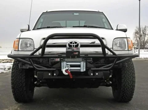

Does anyone know of any links to some bumpers for an 04 Tundra? I dig the ARB Bumpers. But, I don't like the Sahara one they offer for the 04. I like the one for the 04 Tacoma better. I can't seem to find much for the 04?
Found this...
http://www.addictedoffroad.com/inde...ducts_id=424&zenid=ib9auc60qdn4f91nh4nnjc8p33
Thanks for the link. I do a lot of welding at work. This gives me some good ideas. I going to modify this design a bit and build my own.
Unfortunately there's not much out there for 1st gen Tundras. I think some have thought about modifying a 100 series ARB, but the frame width is different along with some other things.
If you go with steel plate all over, you might want to think about investing in new coil springs. IIRC, OME has three springs that will work: OME 884, stock replacement (light duty), OME 885 (medium duty, but 2'5" lift), and the OME 886 that get recommended for use with winches or heavy bumpers. Not sure if the 886's are a lifted spring though.
