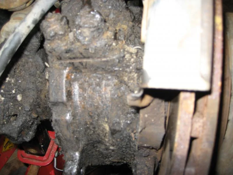

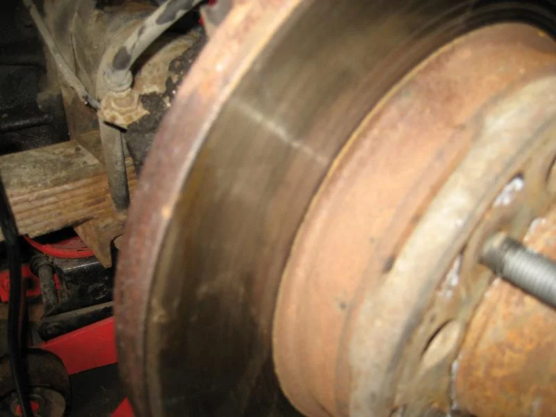

I've got a 77 40 that I've had for about 2 years. Drive her in the spring, summer, and fall. Too much salt and crap on the roads to drive year around. Would like to drive her as a DD this year.

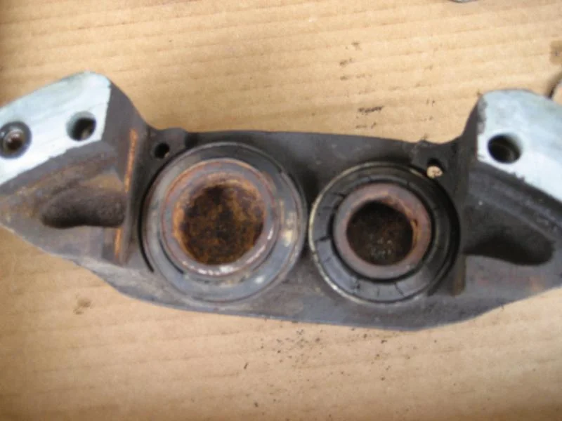

In order to do so, I need to work on the brakes and sloppy steering. Decided I'd tackle the brakes first. Couldn't get brake pads out from the calipers, so I removed the caliper bolts and took them apart. Found out that was a mistake. Brake fluid poured all over the place. Got that cleaned up, but now they calipers are apart, don't quite know what to do. The pads aren't too worn and have even wear. Can I still use them since they have brake fluid on them by sanding the surface down?

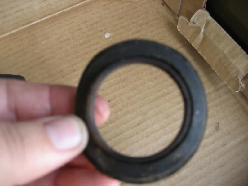

The rubber parts of the cylinders are cracked and worn. The cylinders seem to be frozen in place. Can I do a rebuild on these? Looks like CCOT carries the OEM kit. I'm sure I can get better prices from cruiser Dan.
Also, there is ton's of black goop and stuff I had to scrape off, just to get to some of the bolts. I know this isn't normal. Should I just pull it all off and clean it up. Guess that gets into the knuckles and TRE's etc. I've got time and willingness to do this work, but feel pretty lost sometimes. All the builds and pics on here help. I've got access to the FSM pdf's but not the same as having someone in person to help!
Autozone 34.50 is what they told me yesterday, and they actually have it in stock and on the shelf. I picked up some 1977 disc axles and some but not all of the caliper pistons are frozen. Figured for under $35 each might as well go that route as opposed to trying to rebuild them myself. Getting a frozen piston out of these would be a nightmare. I ran an air hammer on them and then compressed air into them and did not budge. Will pick my pair up this week.

The manual shows them using compressed air, but good point. It does show putting a piece of wood in the middle to prevent them from coming all the way out.
