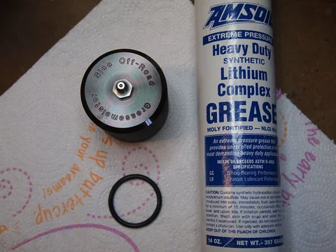

Heads up guys:::
Remember to set bearing preload, pack the drive shaft axle needle bearings and bushings and check the gap of the drive shaft axle snap ring.
Tip Slee Off Road has a great tool for greasing the axle bushing and needle bearings. It call a Slee GreaseMaster, save a great deal of time and reduce cost of job.
FSM recommends Moly fortified Lithium based NGLI #1 Grease for bushing. FSM is unclear on moly for needle bearing.

The spindle bearing spec nlgi 1 which we packed with AMS Oil Poly Synthetic. The inner bearing used Ngli 2. I used almost 3/4 tube for each. I used the ams oil web site and this is what it specd. My bearings were in good shape but the inner and outer seal were starting to fail because you could see where the peanut butter grease was turning black from contamination.
Alert:
Moly should NOT be used in wheel bearings.
Moly retains heat, not allowing high speed bearings to dissipate heat (cool) properly. The FSM states moly on axle brushing only, it is unclear on needle bearings (axle roller bearings). I've been told by Toyota shop foreman that it is proper application for axle, but not wheel bearings.
Wheel bearing grease labels will read: Multi purpose High speed and/or wheel bearing and/or chassis lubrication.
