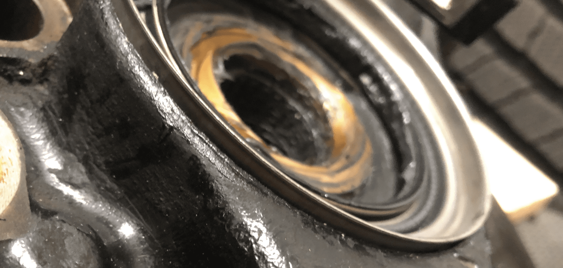

Does this depth of the seal seating looks alright? (seems still a little shallow than original) I already try my best to drive it in, seems it only can go this far, is it ok? Thanks for any recommendation!
I use my brass dowel when in doubt. I'll tap around first inner shelve of seal. I can hear when it's metal to metal. last time I measured it was 4mm on my ruler.
