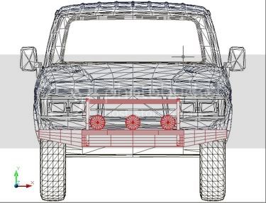

I like to use autocad, not real good at it, but i like it. I decided to design a front bumper for the 60. I used 2mbb's design and then went from there. This is what i ended up with, I apologize for the obnoxious colors:
Next i threw together a new rear bumper that would be really simple to make and this is what came out:
The third and final picture is of the bed system i designed for the rear. It will be modified to allow for the rear seats when i get ambitous again.
I hope this helps someone in their ideas.

im not a fan of the upsweep so much.....my design was flat on top......its all up to what you are going to use the cruiser for..... for me its going to end up being a daily driver with light to light-meduim offroad use so i will get all the clearance i need from my slight bottom slope. I do think that bumper is great for what is appears he is using it for.

here is a picture of the front bumper(slightly edited due to miscalculations by me):
