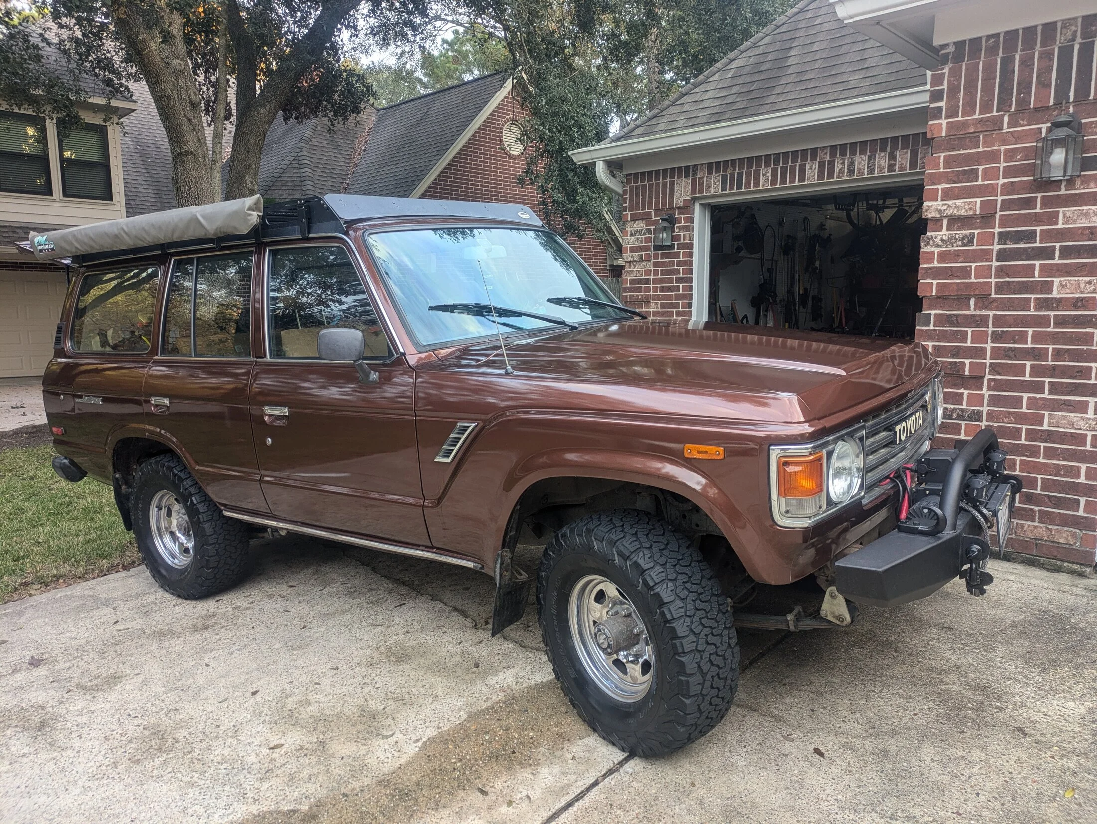

I got mine from Trail Trailor and love it. Heavy duty compared to an ARB and understated. I like the OEM look and at the time I tried to get them to do something with the OEM bumper but was told that he had and he would not try it again. Happy with this bumper but I believe he does make something now that can integrate with your existing bumper. I will do sliders next.
Couple of in stock front bumpers at the moment. One with bull bar and one without. Rear would have a lead time.

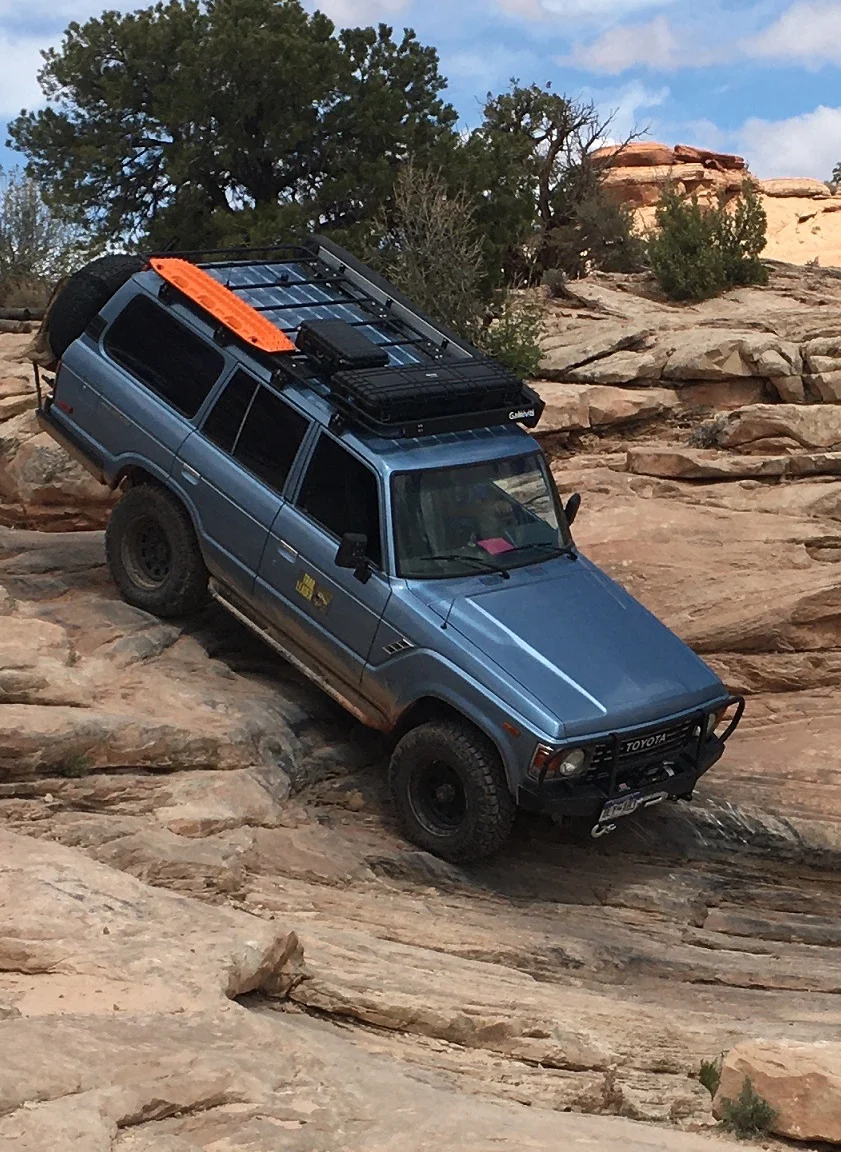

Great suggestions so far. I'll add another: @Fourrunner here on the forum sells a rear bumper kit with optional swing outs and tire carrier that you weld up yourself. I've been running that for about four years now with great success. I have the @TRAIL TAILOR sliders and they're great. Bonked them on a handful of rocks too and they haven't even dented. Great build quality and excellent fit. The ARB is a classic front bumper, and any of the stuff made by the vendors that frequent the forum every day is excellent (otherwise they wouldn't still be around). CurrentlyI have what I think is a homemade bull bar style bumper with no winch provision on the front- it came with the truck. Personally I'm hot after the 4Plus front bumper from @lcwizard ... Lot's of other projects before I get there though. I do have a jerry can carrier from 4Plus that's adapter to Fourrunner's rear bumper swing out and it's a well made piece.
