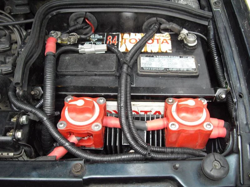

On my truck I have a dual battery set-up with a marine switch (left switch for winch and right switch to combine batteries) that must be switched to supply power to the winch (not yet installed). I am also still thinking about using one of the large connectors down by the battery so that I can also easily disconnect the winch for removal etc.

I already have a disconnect on my + main terminal. That takes care of possible issues with the starter getting stuck.
But then I connect the + of the winch to an auxiliary terminal on the (marine) battery when getting ready to winch only, so it's not on all the time (to avoid the taco stunt). It's held with a wingnut but now you have me thinking that if this thing starts to get way too hot it may not be that easy to unscrew in a hurry without gloves or tools..... mmm.... Some more planning needed.
