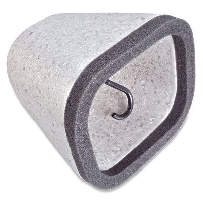

Two (preventative) fixes for external drains:
1. Frostless faucet. Doesn't help you now, but would prevent this in the future:
2. Hose bib insulating cover. Prevents it from freezing. Setting hose to drip is not ideal, this is if you don't have a frostless faucet. Once you defrost, put this on.

Once you get it thawed, insulate the outside with the "hose bib insulating cover" I posted above. I have one on my house, have never had an issue.

But I'll suggest the cover that Johnny mentioned. The fancy one is still under $2 each. But thaw that pipe first.
