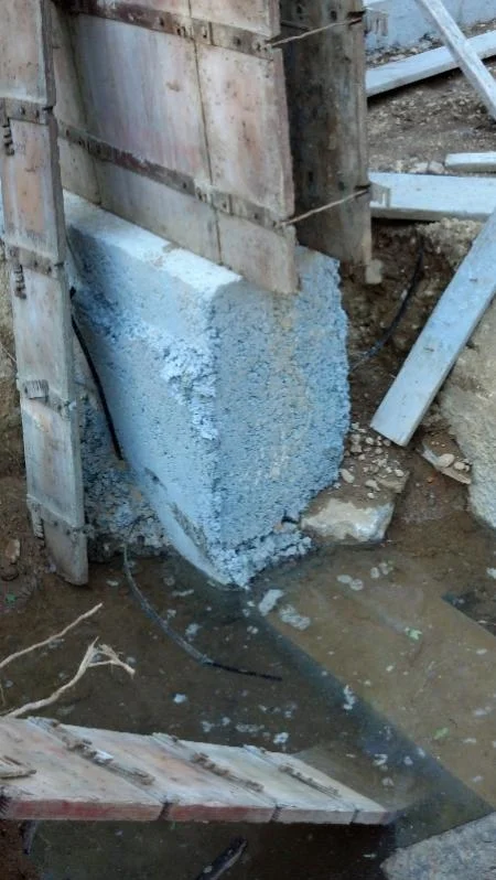

Does this footing look ok to you?
This is on the house being built next door to me. That concrete looks kinda ratty to me, not sure I would accept that. I also don't like how they left that big rock in the footing, but maybe it won't hurt anything.
I was also surprised there are no pins in the footings to tie the walls to the footing, just a shallow groove to act as a keyway. Is this normal?
Thoughts?
It kinda hard to know what is totally going on here with just one picture, but I will take a shot.
The footer does not look to be deep enough to be below frost line. However, it does look like it is resting on top of another footer?
The cement looks to be poorly compacted.
The rock to me tells me that they did not put 6 inches of compacted "engineering base" below the footer for a solid surface to place the footer on.
The "pins" can be put in later with a hammer drill and some epoxy, but J bolts that are cemented in are always better.
I hope there is an inspector that catches this before the walls are put up...

The bottom of the footer is below frost, you can't see that from the pic. My concern is with the concrete, it just looks like it is not vibrated properly and too "stiff" of a mix was used. Too many voids. I teach a class in concrete mixing and design, so this does not strike me as a good mix. I would not accept it if it were my house.
I'm typing this from my kitchen, and I can see a concrete truck on site now, I assume they are pouring the walls. I also do not like that there are NO pins at the bottom of the walls. Half of the walls were formed when I took that photo, and I looked inside and there was no rebar, no pins. There's no way they hand drilled all the pins that would be needed.

I just came back from the site, I'm too late to get pics of what's at the bottom of the walls or any rebar (or not), all the walls are poured. They are doing the final screeding and setting the sill bolts now. I took a bunch of photos with a real camera.
I introduced myself to the guy in charge on the foundation crew. He said they don't put pins in at the footings, just a keyway. Well, the keyway that I saw yesterday was pretty pathetic, like someone dragged a boot through the footing just before the concrete set.

-Footing concrete looks to be inferior, in color as well as compaction
-Can't tell, but the footing appears to be sitting on another footing..has it been pinned? Is anyone taking cylinder tests for testing to verify concrete strength density?
According to local building codes in my area, and past building experience...
-The key way should be a minimum of 1-1/2" x 1-1/2"...2" x 2" being better.
-The footing should be a minimum of 42" deep (to the bottom) from finished grade.
-if the footing extends over a rock(or rock ledge) it should be drilled and pinned
-there should be a minimum of 5" on either side of the vertical wall (meaning if the wall is 8" thick, then the footing should at least 18" wide.
-there should be a #4 rebar stubbed up at least 1'every 2' O.C., and that should be then connected to rebar in the wall grid. If the slab is poured over the Wall, then the bars can sub up and bent over and tied into the slab with an additional horizontal member
I agree..there seems to be more things wrong than appears to be right...if there is a local building inspector on the site, he should be made to sign off on every concern, especially those which appear to not be to code. I would recommend your neighbor to employ a structural engineer, and do that immediately before the project proceeds any further..... I see you're in NH...so my guess would be your footing depth would be even deeper than in SE NY where I'm located.

Truthfully, residential loads on foundations are actually rather low, which is why there is never testing of the concrete (cylinders or slump). Settlements are usually not an issue, as often the weight of the excavated soil from the basement is close to the weight of the structure.
I wouldn't trust the color of that photo, it's not the greatest camera. But, I really distrust that mix and how it's been placed. I have no doubt the key is not up to snuff, but again what are the chances that it will shift?

As far as that work in the picture, the real trouble would appear with a slight earth tremor....where a proper built structure will withstand it... a substandard one will not, and when there's foundation shift, there's structure shift. Now chances are nothing will happen, I've seen a lot worse, still standing today.

What would get me about this house under construction...if this is what you can see, what about the parts you didn't catch?
Ya, I know. I can't figure out how they poured the 8' high walls, and there was NO vibrator used at all.

If it were one of my projects, they'd be ripping it out and starting over... What is with the pool of water? And all the trash laying around? The rock sticking out of the wall - is that at a doorway? Are they going to knock the rock out and patch it when they go to set the door?
Oh, and all the previous comments about unconsolidated concrete, lack of reinforcing, lack of anchor bolts, etc, etc, etc...
