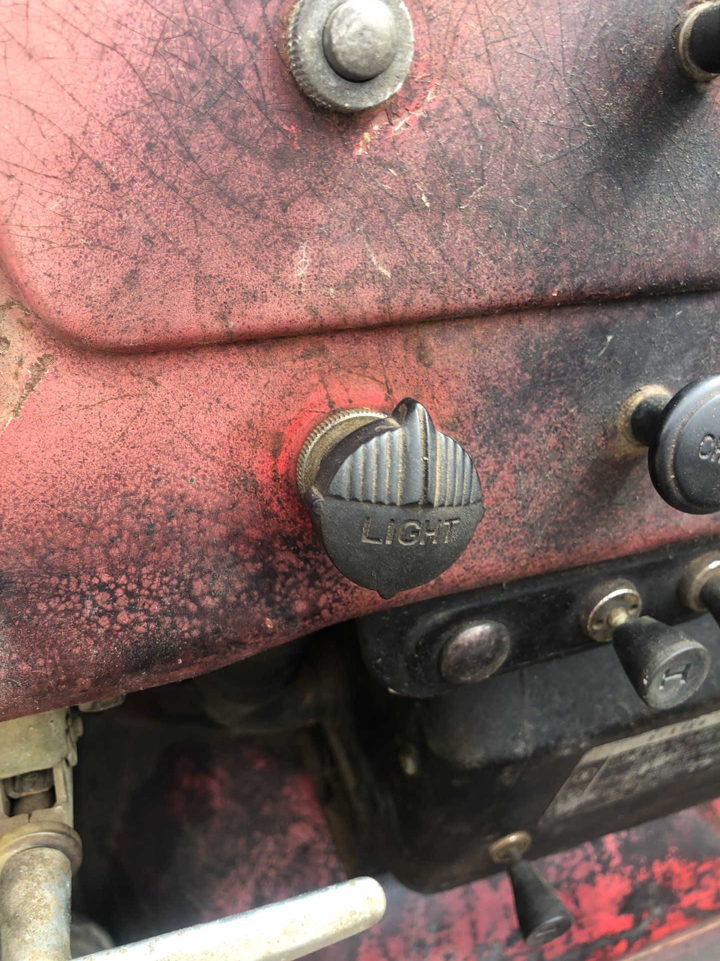

Needed. Mine does not seem to be working in any position anymore.

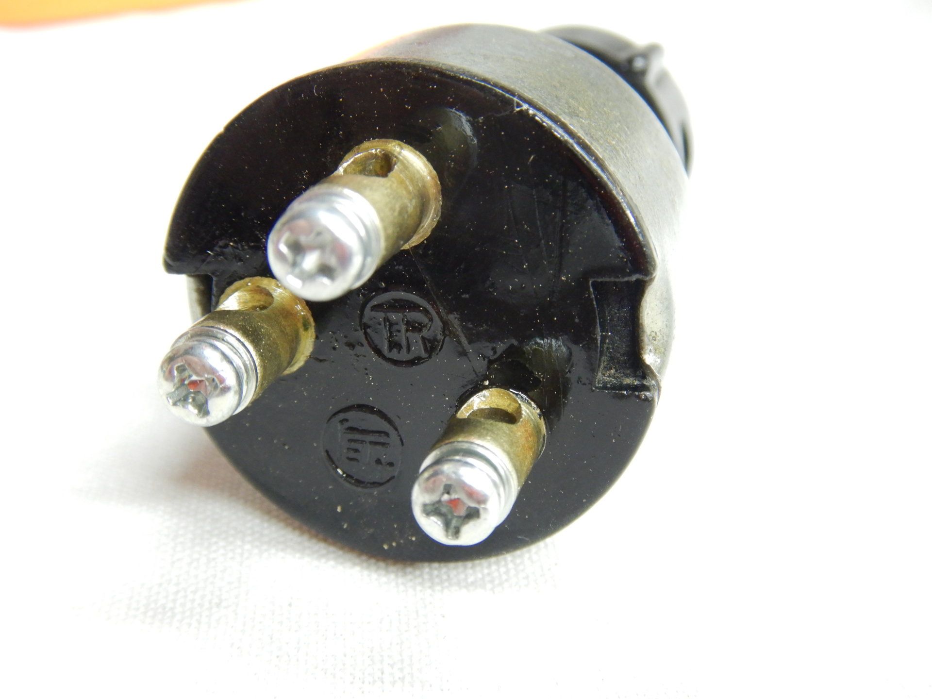

what i have seen on the few iv Serviced , is that the machine screws on the Brass Lugs on the back can vibrate loose , and or
tarnish & corrode to the point of MAX Resistance between conductor LEEDS and the brass LUG itself .
i would get a set of fresh Stainless Steel Lug Machine scews Phillips head , and pull switch , polish Lugs good , install new SS screws
now the interesting part :
- cut back each leed or wire say 10mm , and trim to length stripped end , Presto ! Brand New Copper and a good conductors
when machine screw sinched down Very Carefully ....................
- i would say there is a solid 42.0% chance what i outlined above is the issue , and not the switch internals
BUT , ............. I could be wrong and it is inside maybe
but , remove , polish , trim , replace cost *9 cents in ss machine screws and can be done in 2.25 hours or less practiclally speaking
its worth a try , that much im certain of .....................

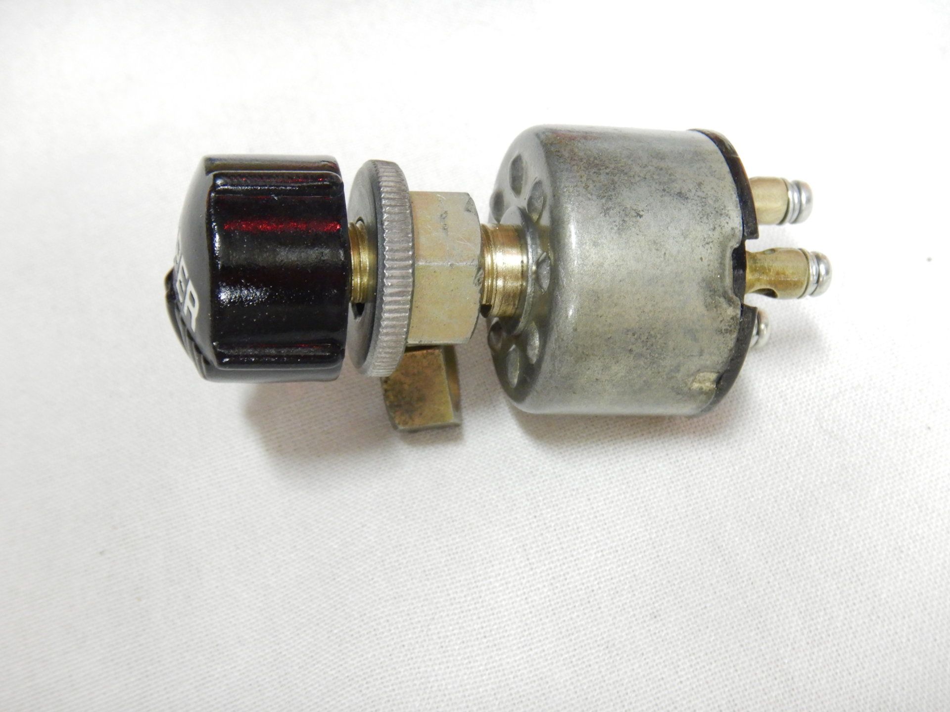

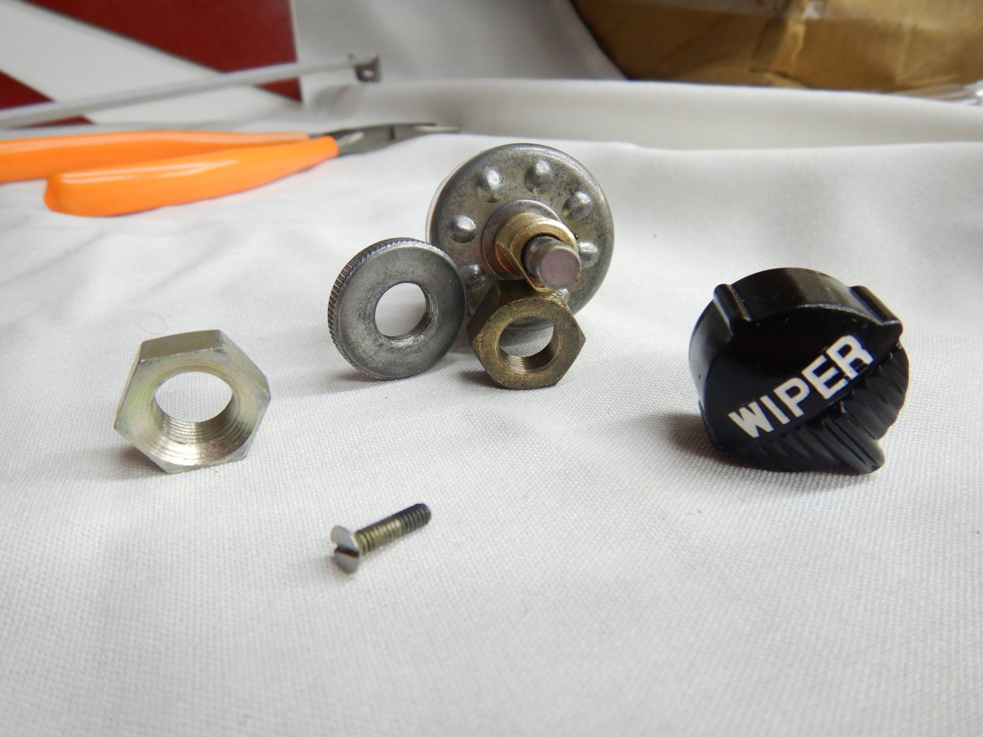

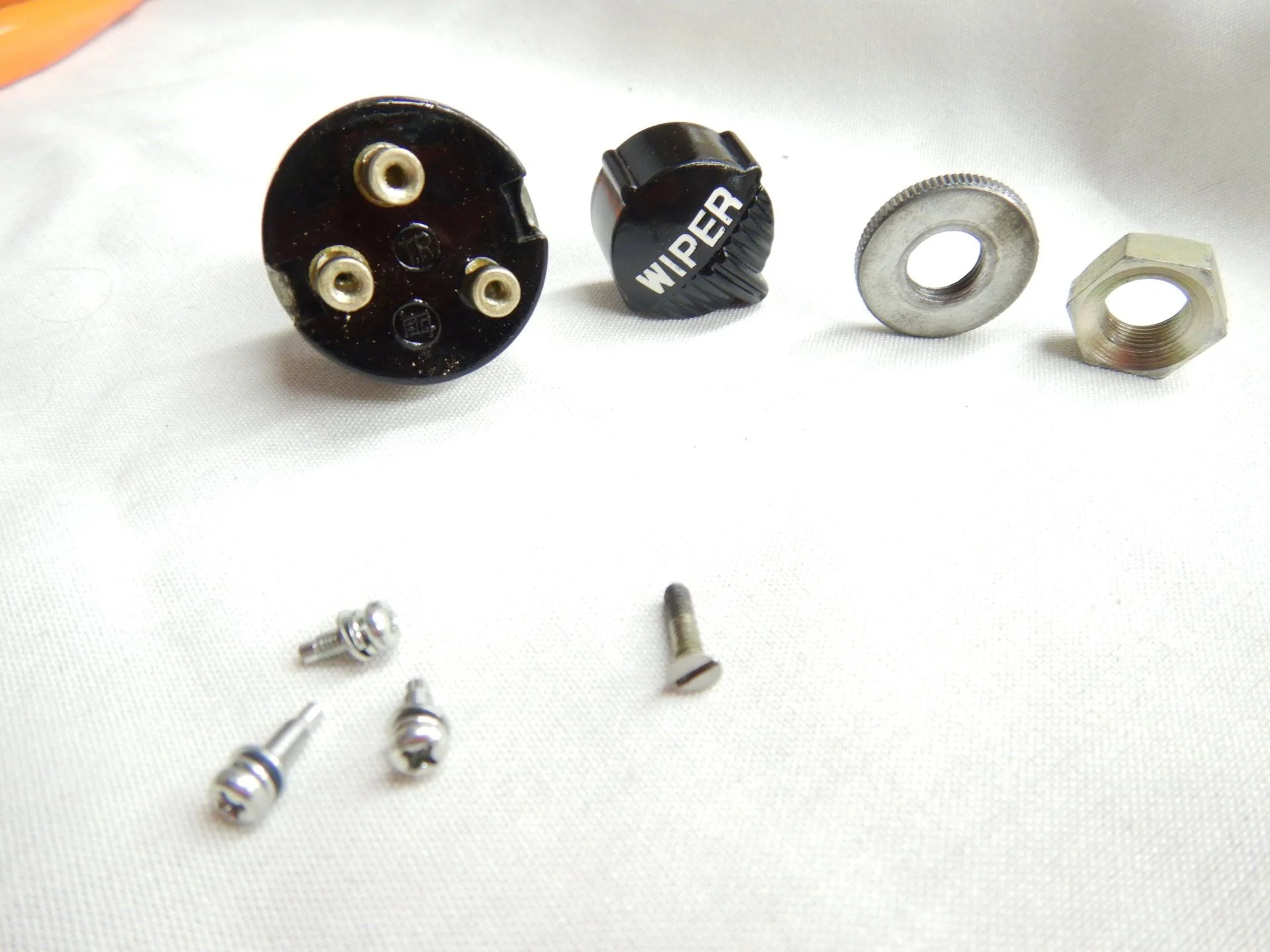

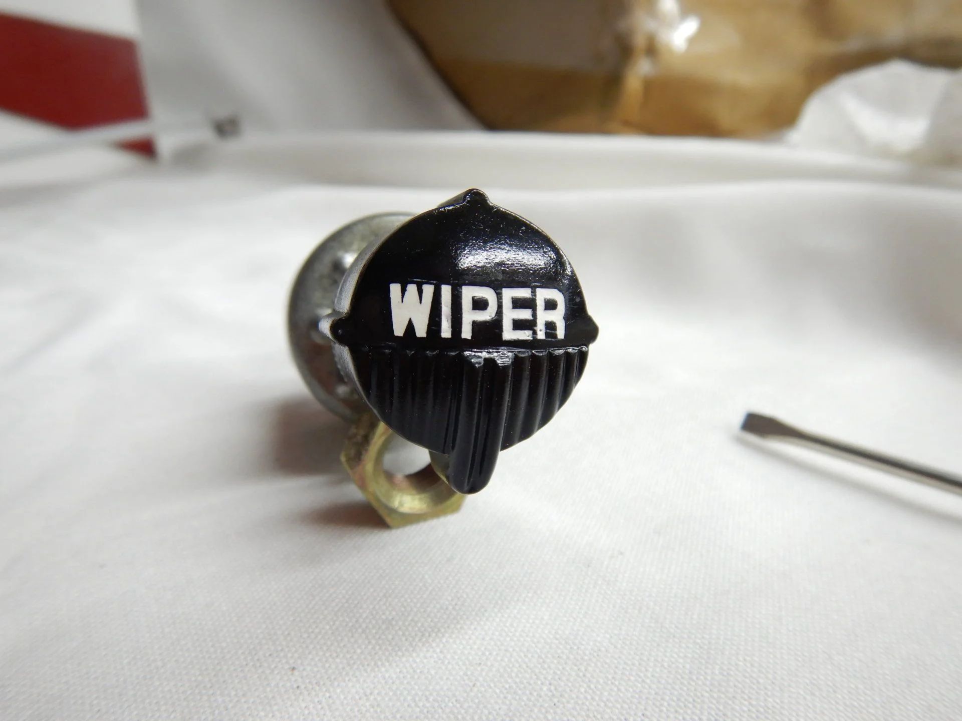

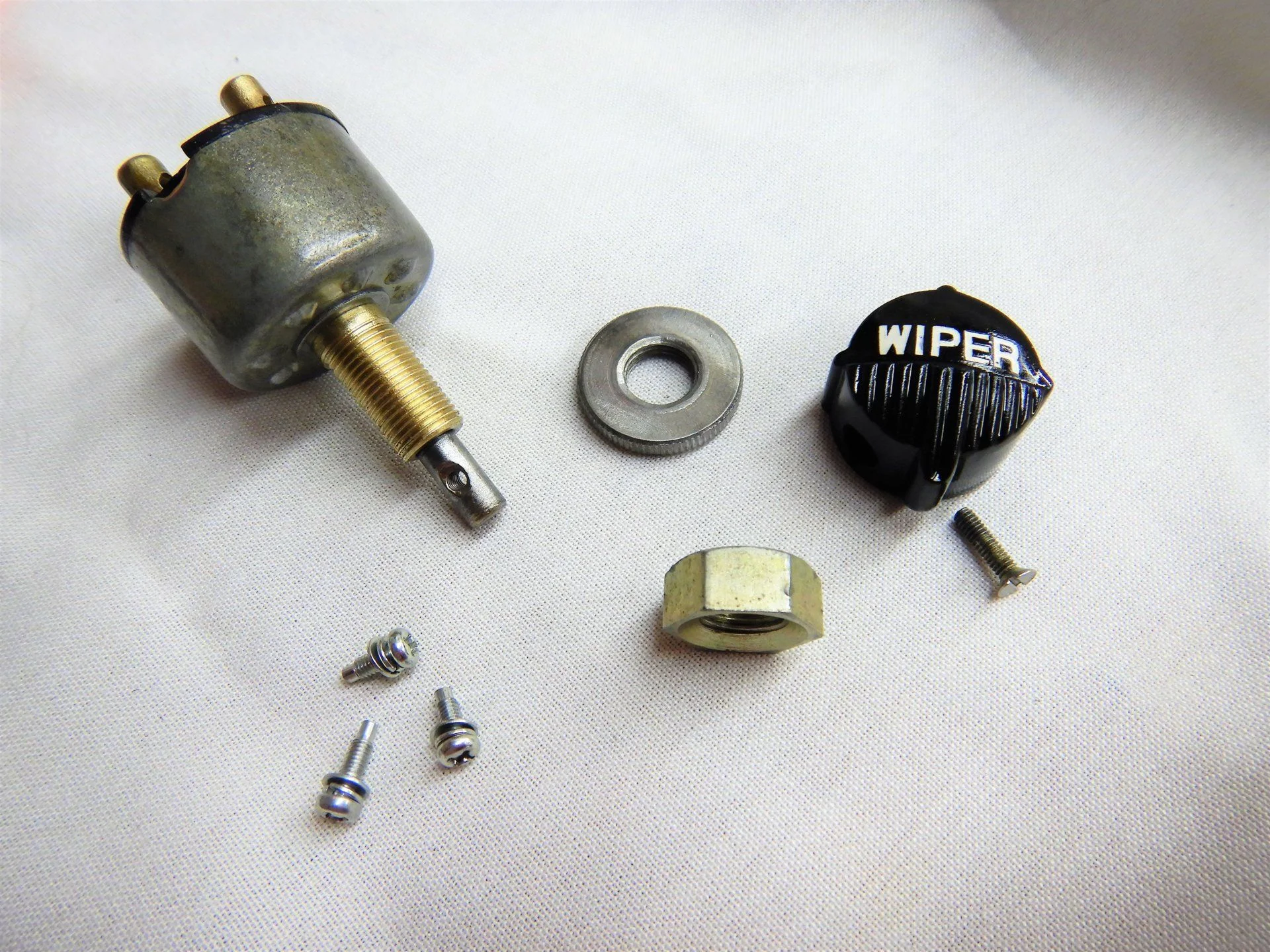

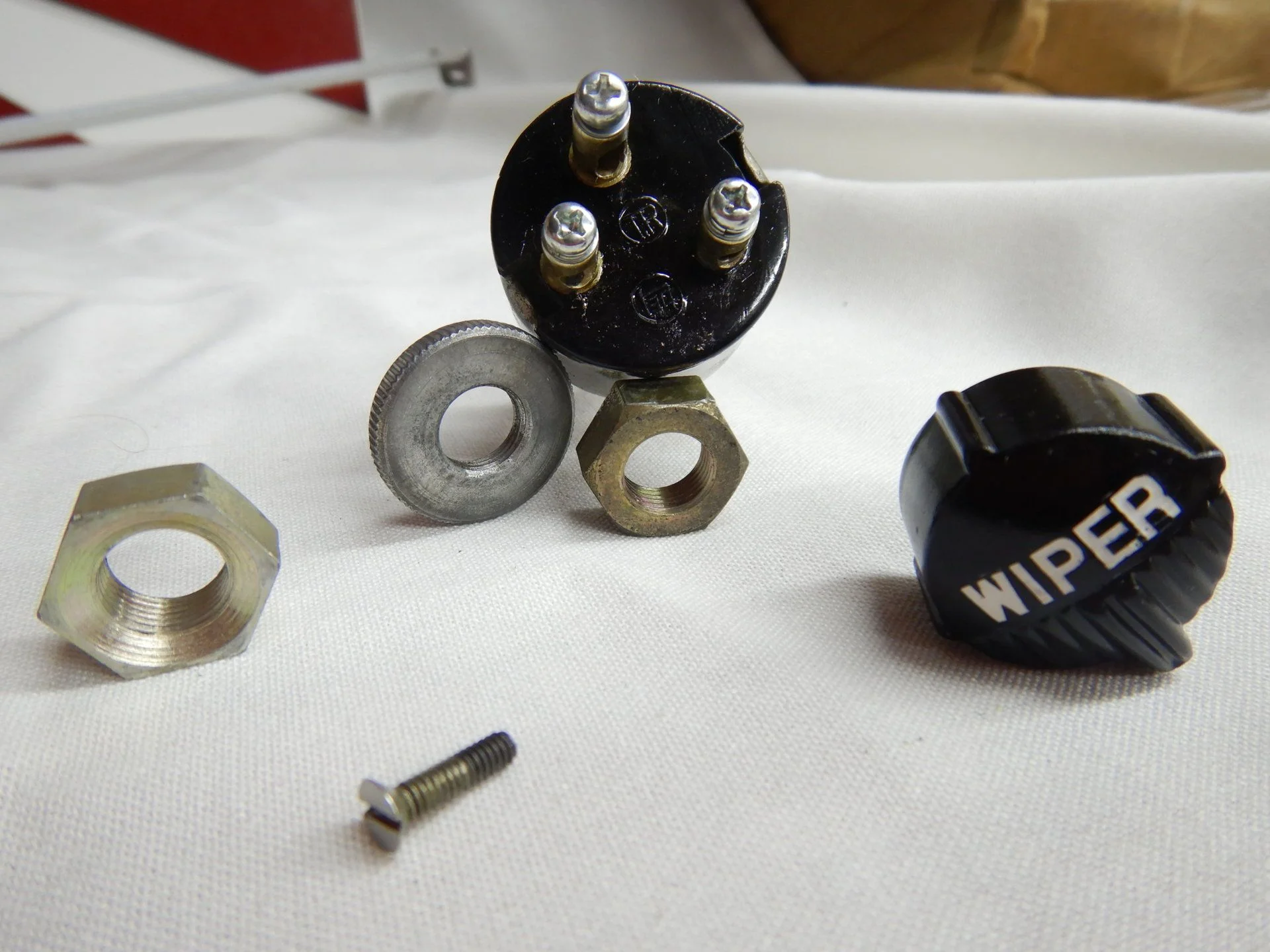

i just completed a Full Restore on this First Generation Wiper Rotary Switch , including going inside to polish contactys , pach with Di-Electric Grease etc.........
Note : my new 3mm stainless steel SEMS machine screws ,
- u need to obtain a Polish-out level very similar to this to properly conduct bare strand wire I LuGS electrical flow ....
