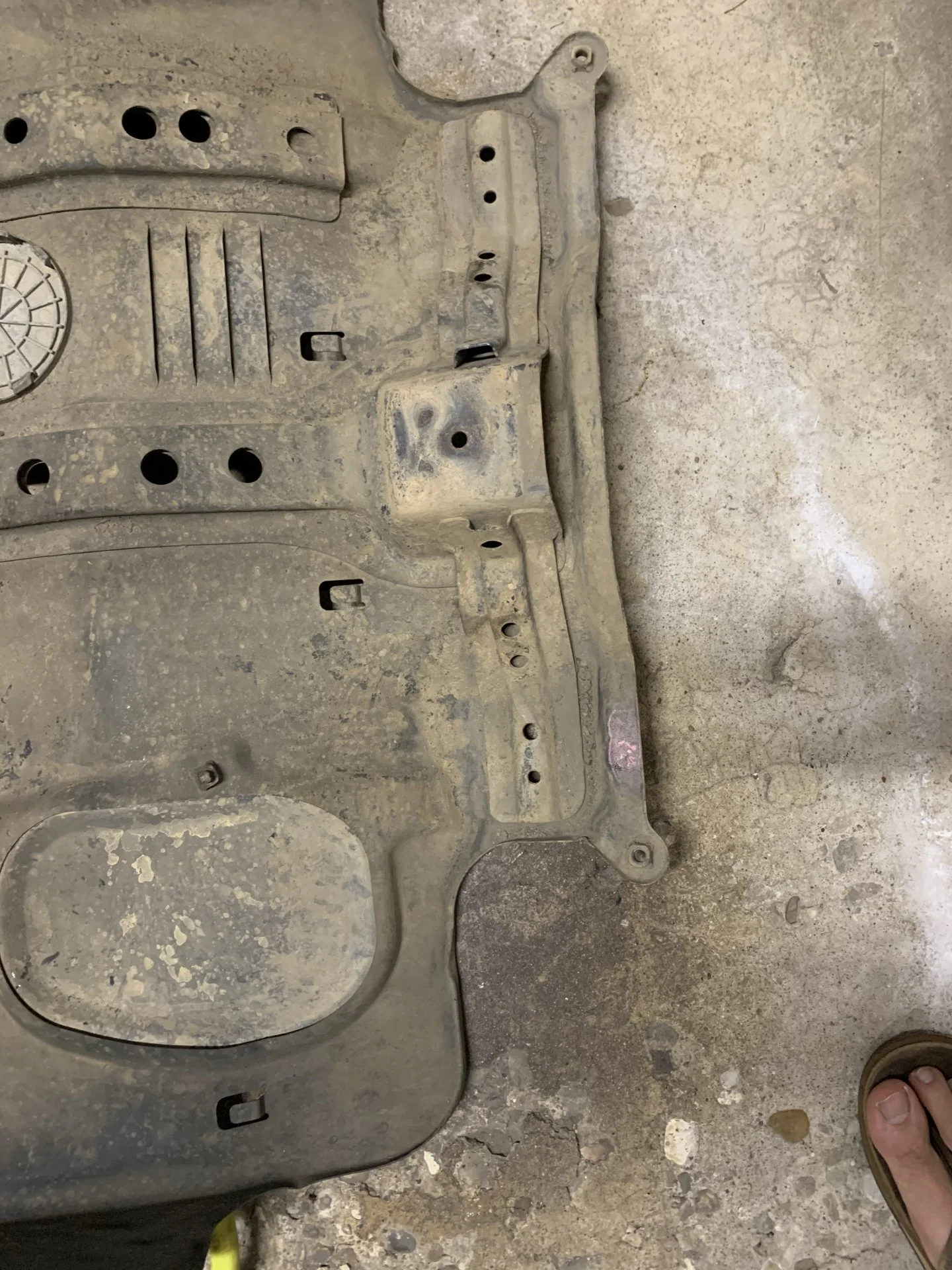

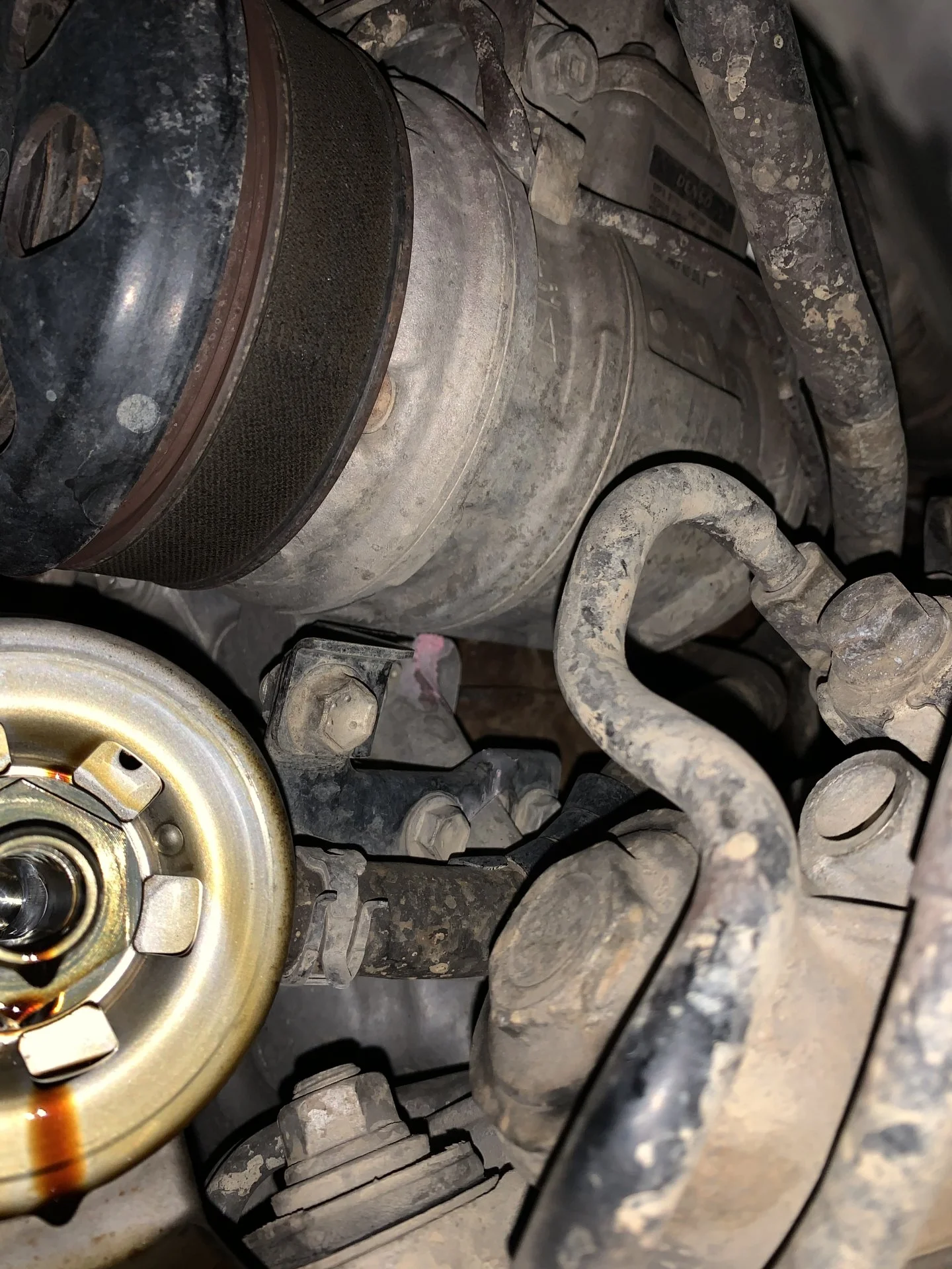

I dropped the skid plate tonight for a leisurely oil change with some music and a beer when a dried pool of coolant derailed my plans.
Leak is towards the drivers side and appears to be coming primarily from behind the a/c compressor, but there is a bit of dried coolant at the weep hole behind the crank pulley too. No visible leaks at the top or back of the motor, I suspect the water pump, but it would be awesome if the was another potential culprit in the area that I’m forgetting. What do you guys think?

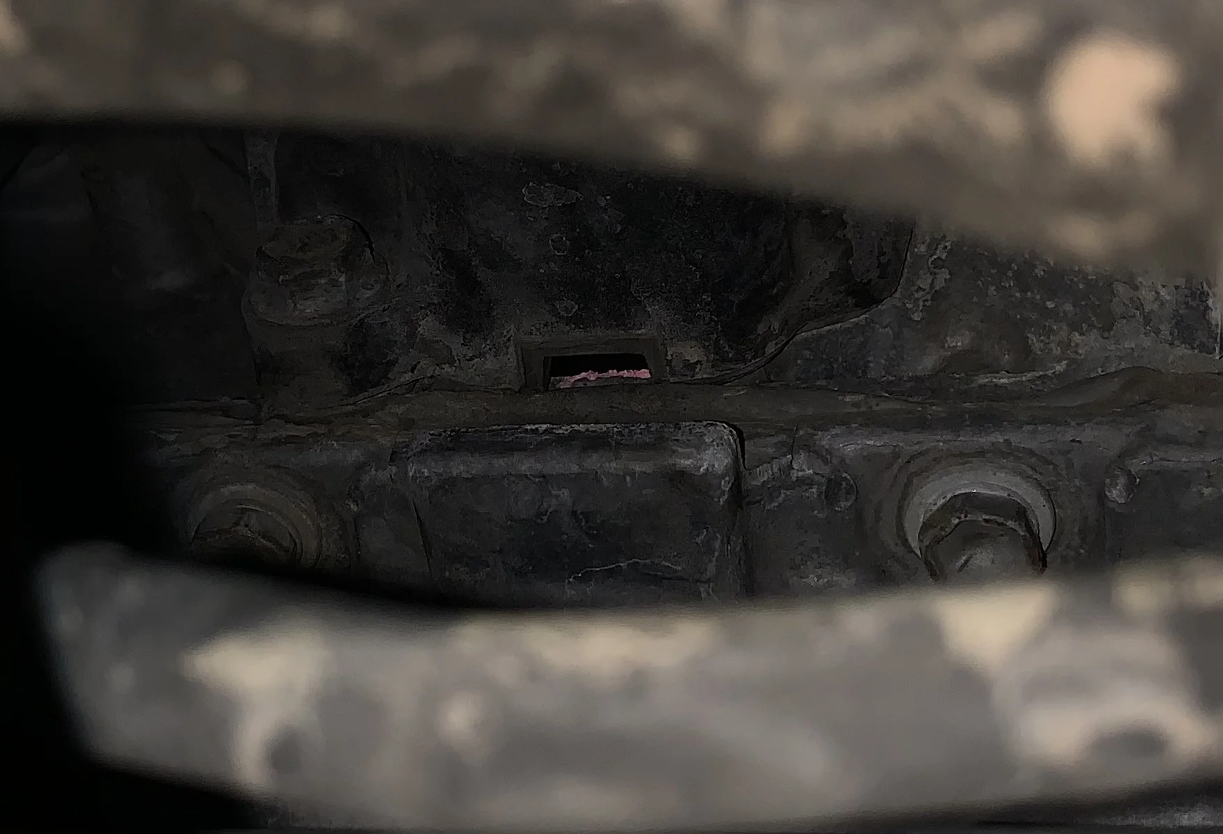

View up to weep hole behind crank.

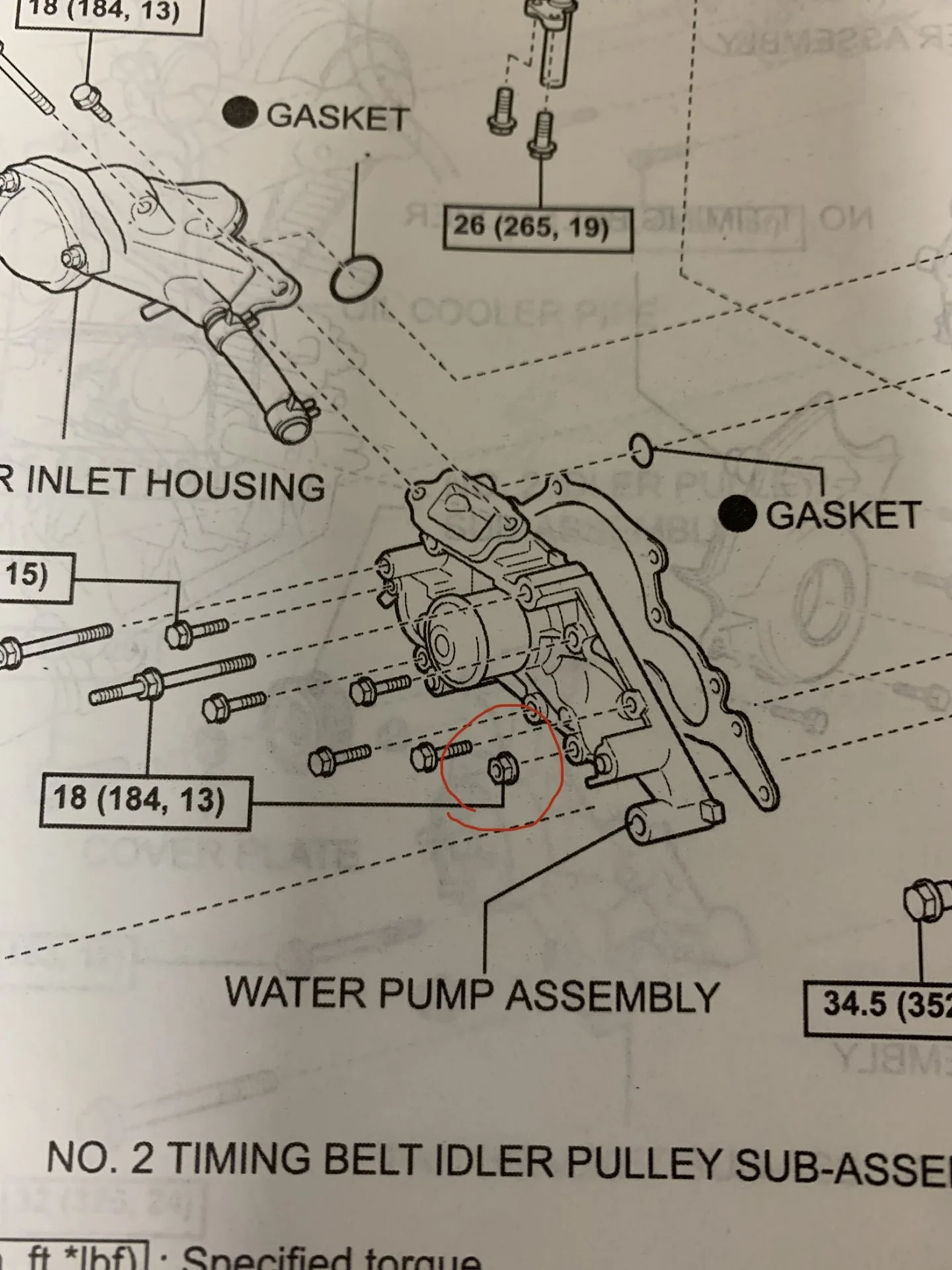

While topping up the oil and listening to a solid Terrapin Station, I had an epiphany. A few weeks ago I pulled my accessory belt while chasing a cold start squeak. While taking the belt off I noticed the bolt circled in red below had almost completely backed itself off it’s stud. I considered myself lucky to find it before I lost the nut, torqued it to spec, and moved on with the morning.
Hoping that loose nut was enough to cause the leak and torquing it down was enough to stop it.

@WeCruise, thankfully it hasn't come back after re-torqueing the water pump nuts/bolts I had access to. I'm pretty sure the one loose nut I circled above was the primary driver of the issue. If you're seeing coolant around the front of the motor, it could be water pump, a leak at the inlet housing, coolant hoses at the oil cooler, etc.
