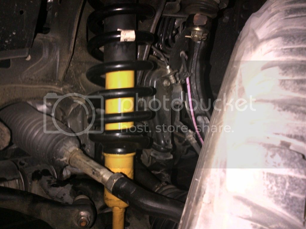

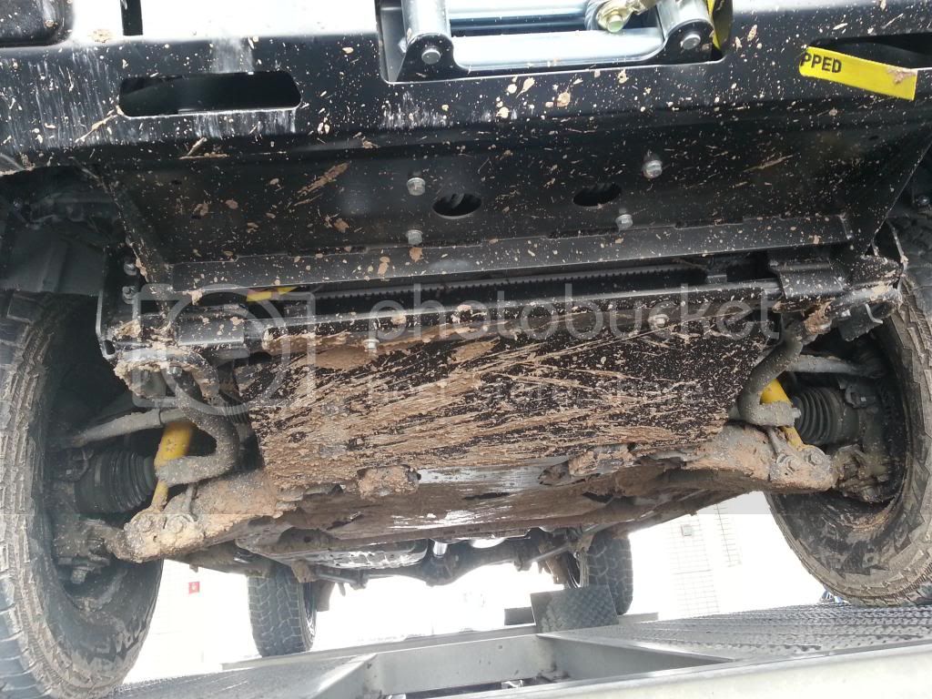

THEROK only pics of front suspension I've got on hand are these (OME lift with sports shocks)
if you need any specific area pictured let me know and i'll get it done in the am
