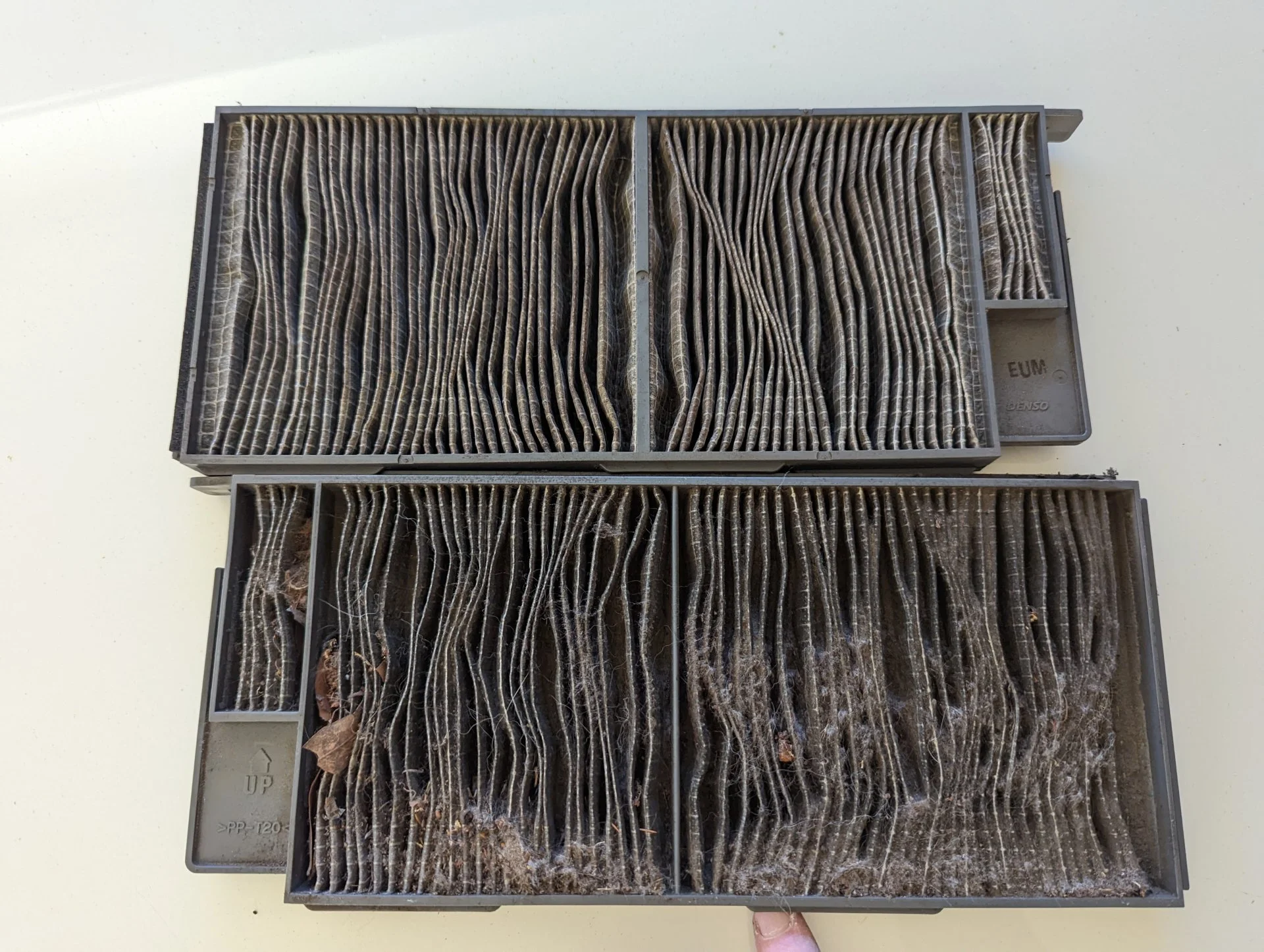

Today I thought I'd take care of some thing easy, the cabin air filters. Ended up being absolutely packed with leaves and other detritus. Had to fashion a hose to shop vac out the nastiness. Nothing's easy...

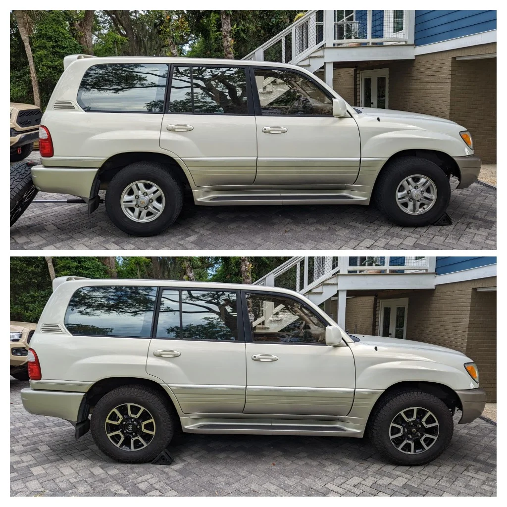

Now onto the chassis. Upon close inspection, as expected, all bushings and wear parts gotta go. Parts are on the way. In the mean time, I installed the new-to-me Tundra wheels and some new tires scored on Craigslist. I know I will ruin them if I drive much with the chassis wear parts so far out that I can't get a good alignment, but I couldn't resist. Pic below.
I also picked up a Tenhulzen alignment kit and did some testing with that. The alignment is not far out of spec. But, again, with the chassis wear parts so far out I can't get a good alignment, so no adjustments right now. She'll just sit in the driveway for now.

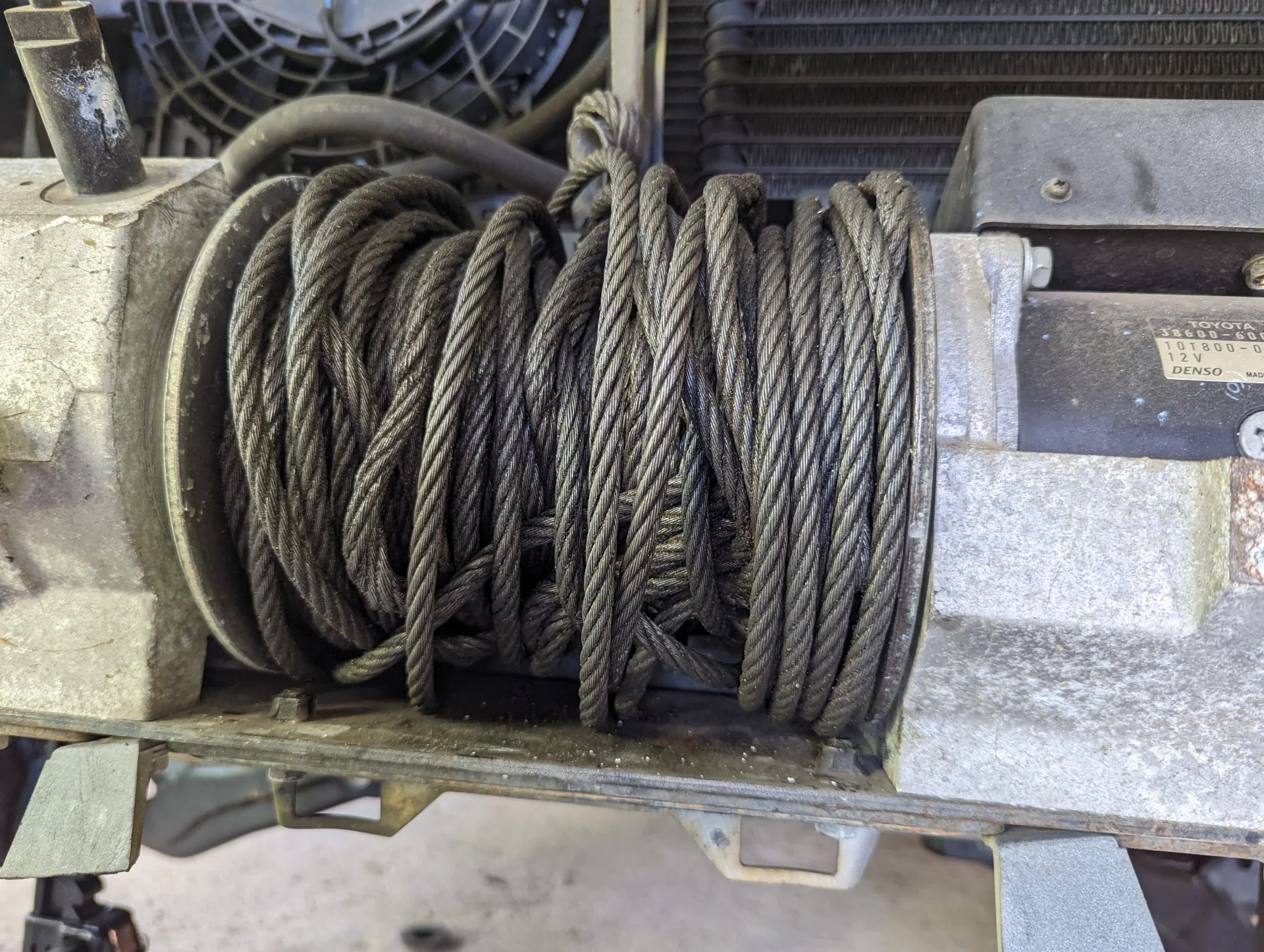

I don’t think the winch is original to the LX. Likely retrofitted. Any close up pictures?
If that isn't fancy as all get out. I really do not have clue what is fancy. Like at all.
Just going by the “less than perfect” cutout in the bumper, I’d say the winch is retrofitted.
What, you don't think those sweet cuts were made by the skilled hands of Mr. T?
You may be right. I kinda think it's a replacement bumper cover. I'm seeing evidence of a little front end love tap at some point

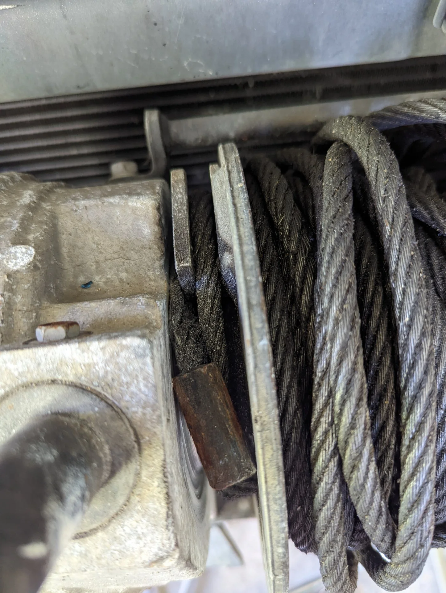

Anyway, it's gotta go - the bumper and or cover I mean. I might rebuild the winch and keep it. For the next searcher, here's some interesting stuff on the winch I have discovered:

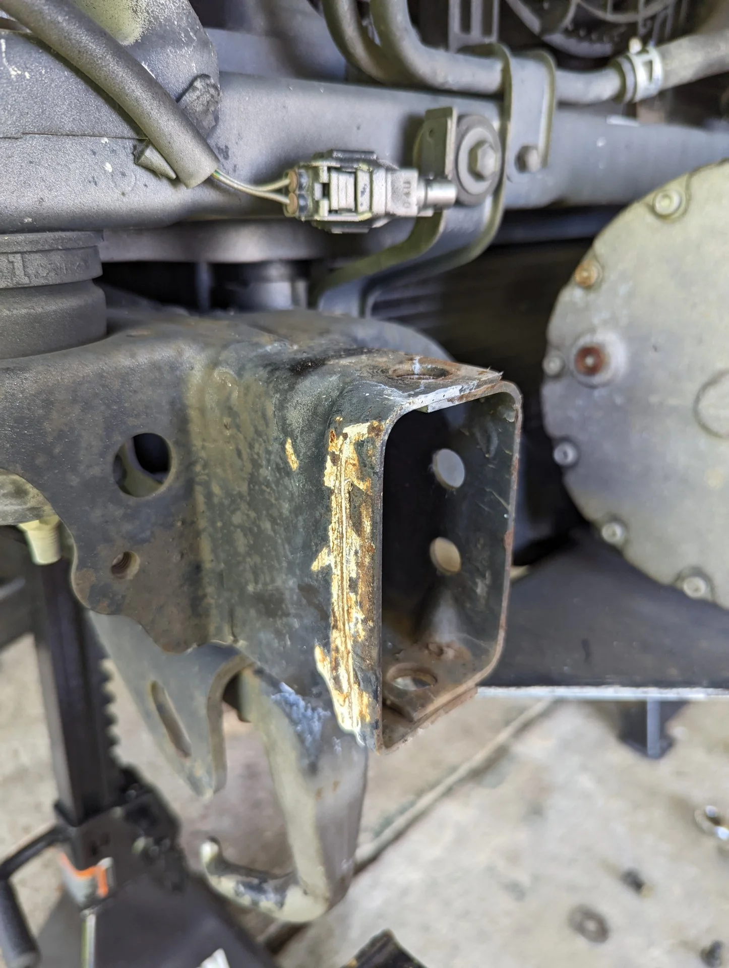

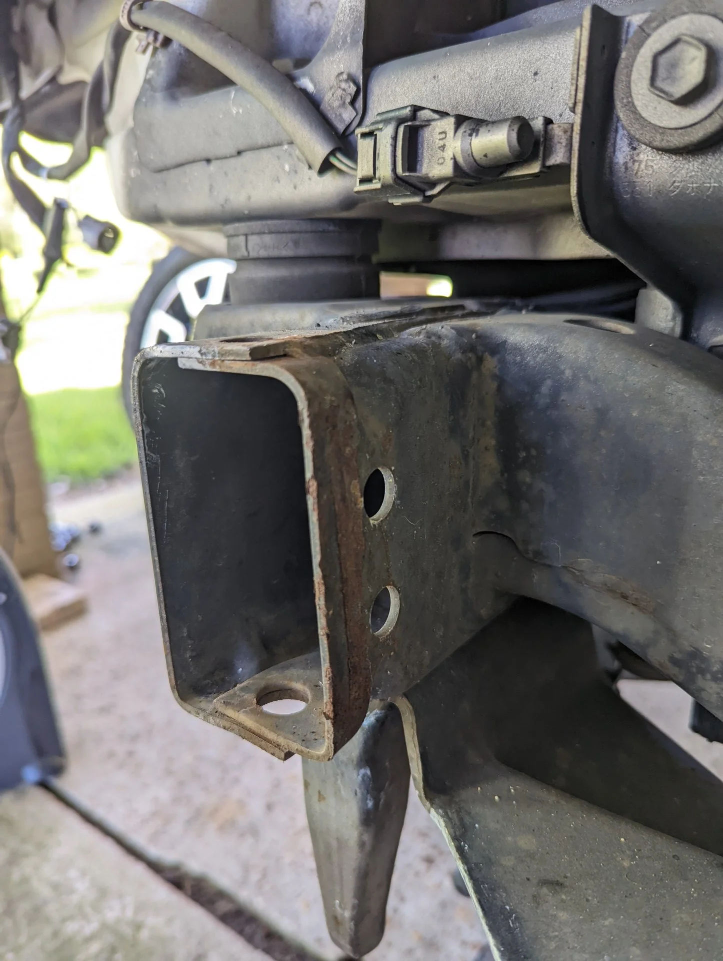

While I am in here refurbing the front end bushings, I thought I would install a TJM bumper. Yeah, those jobs go together, right? I have had a lot of "learnings" as I've fought the control arm bushings and the ball joints. So I should've known that this "OEM" winch had some surprises for me... The frame end caps were cut off to install the winch-specific intrusion beam. So now I have to try to find some of those or fab replacements or weld the bumper mount on. And I've never welded before. Oh and of course the winch cable is totally ****ed.
Ok, vent complete.
Maybe TJM has seen this before. Off to the Google I go...
Weird. I just looked and mine does not have end caps either. I wonder if that is a Lexus thing? Makes sense to have it welded for strength. Maybe a local welding shop can help at least get some caps on there so you can proceed. Also, maybe time to hose down the cable with some lubricant spray. Unwind completely and then recoil?
Got the bumper installed after welding on the new frame caps (5114360070 and 5114460060) and reinstalled the factory electric winch with new dyneema. I haven't locked in the bumper yet because I'm not satisfied with the fit... I think I'll ream out the main mounting bolts to enable a bit more adjustment before locking it in with the final bolts.

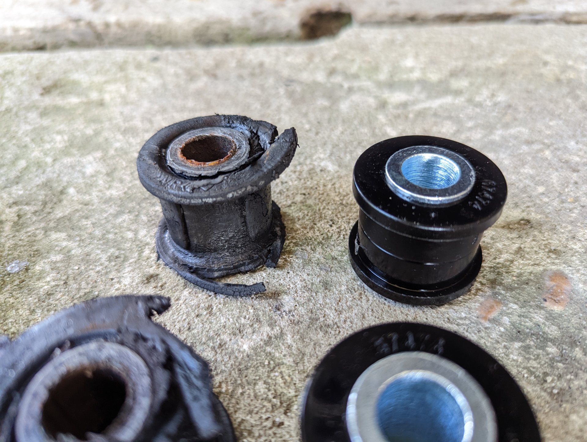

  • Steering rack bushings - these bushings were absolutely shredded; EPIC difference
