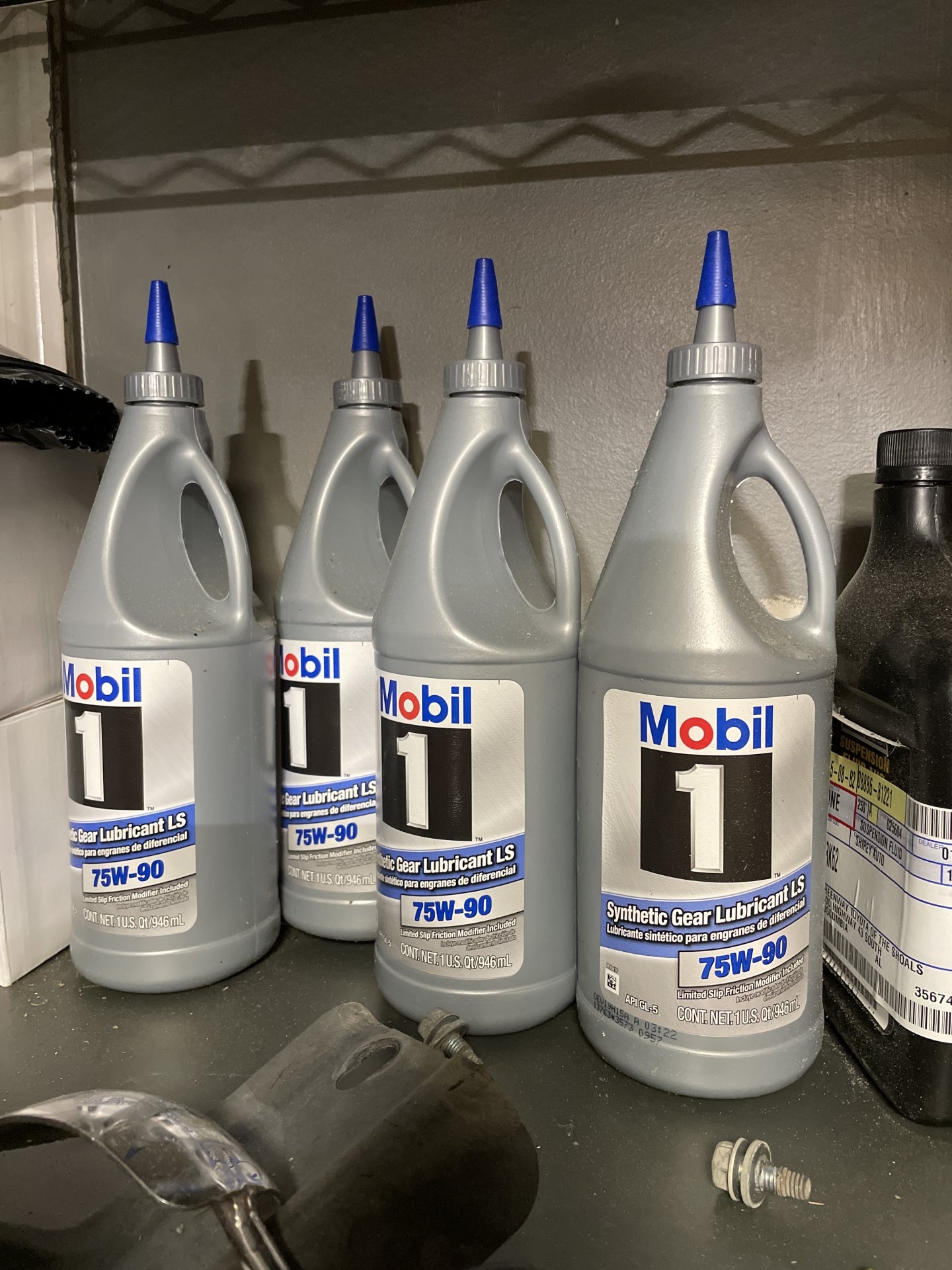

At the danger of triggering another oil debate, I'd venture to say most people here (including me) are using this:
Can I just use this in all 3? New to 4Runners, used this in my LX’s.
