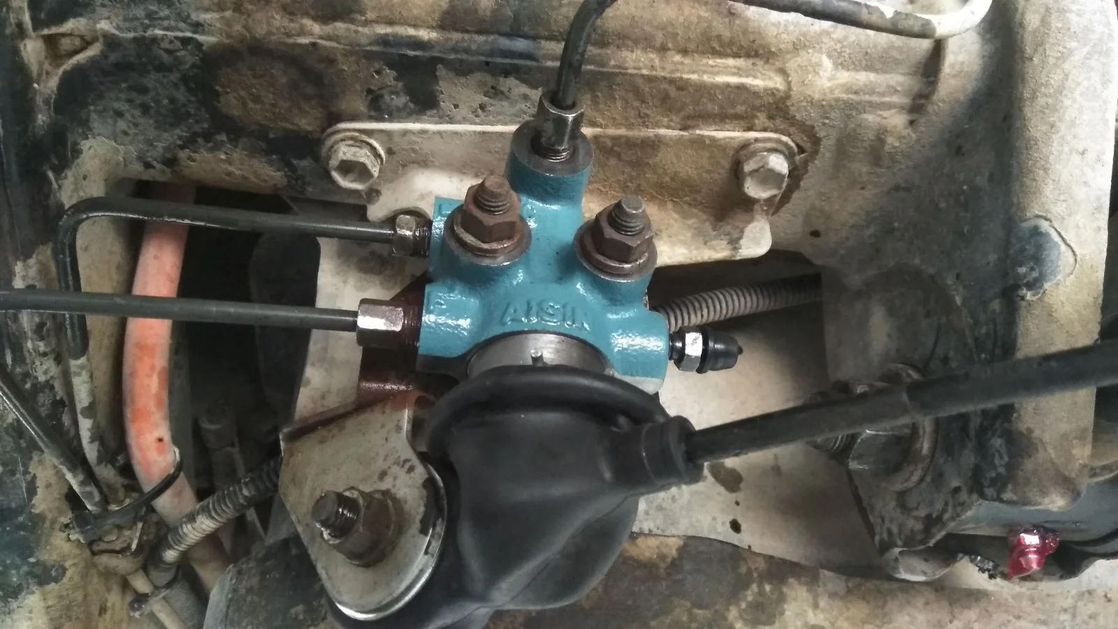

I think there is a way to adjust / modify the rear proportioning valve by simply disconnecting the rod and using a zip tie to hold the lever upward, but i am unable to find a pic (someone please post one).

Check and adjust your rear proportioning valve acording to the FSM
i had issues similar to yours that disappear after i replaced the old one that didnt function at all.

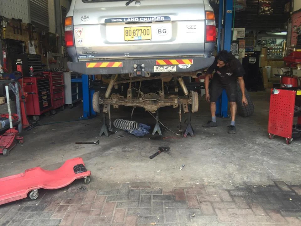

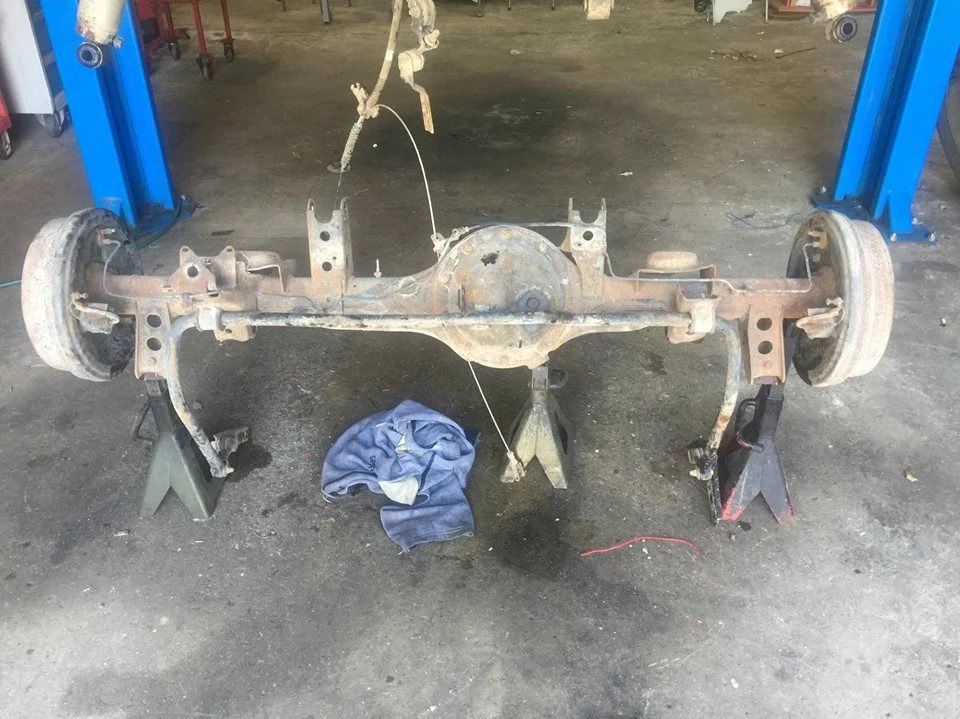

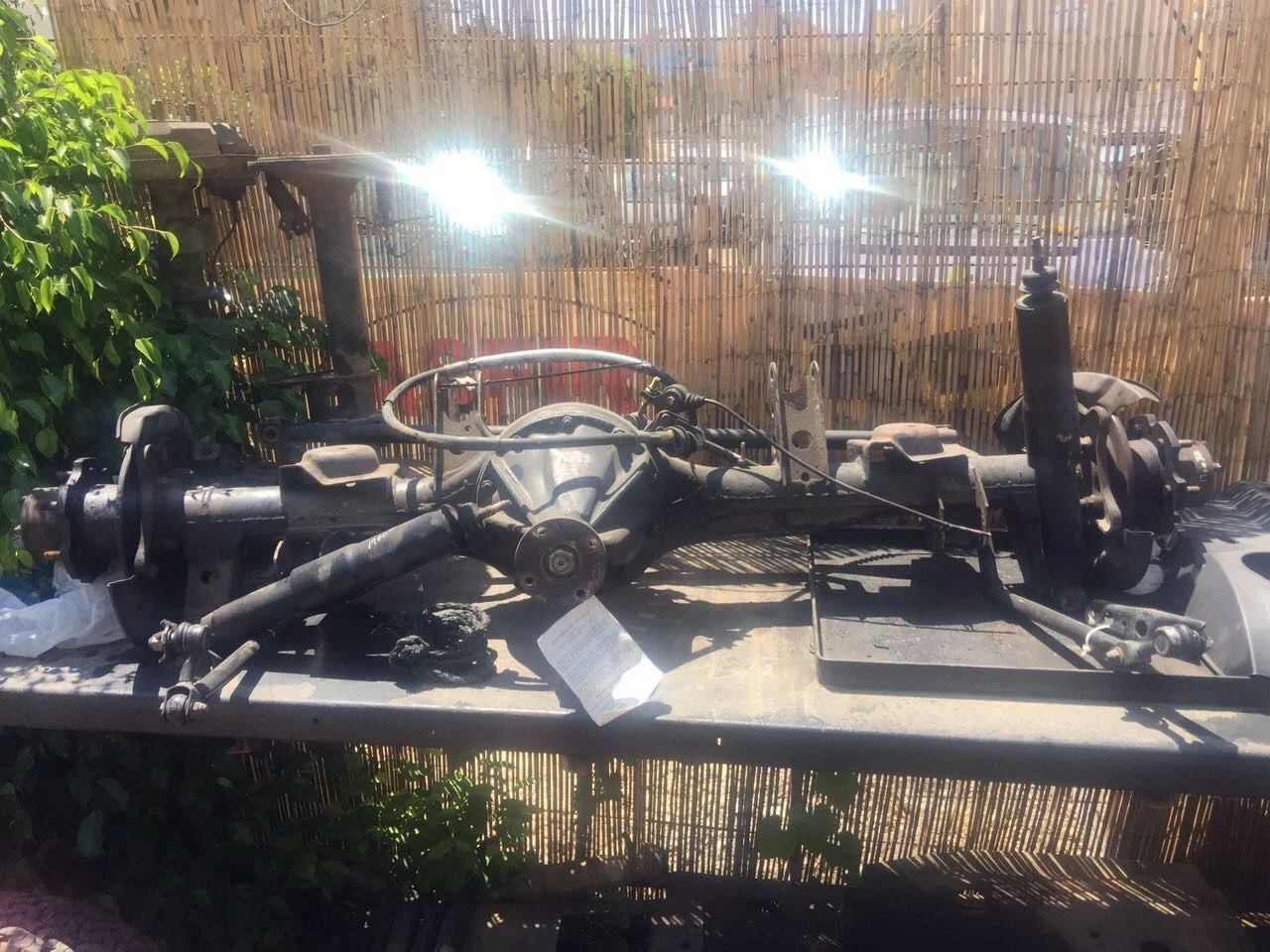

Drum brakes are much more susceptible to overheating and fading than disks. Riding the brakes is not great on any vehicle, worse on drum brakes. Best to put it in the needed gear to maintain the desired speed and get off of the brake pedal. Second option, swap a disk brake rear axle.
I did this swap because of 2 reasons moving from drum to disk brakes and moving from SF Clip to FF
In my 1997 there's something like six or seven soft lines. They do not age well, replace them with OEM. LSPV is definitely something to consider too. Don't give up hope, it is not lost!
I have replaced all the lines, some in stainless as well. I'm going to try the LSPV next, seems like that could be it. Seems like removing could be the best option.

Same problem. Checked everything, changed everything. Next Step LSPV will be changed to a Tee
